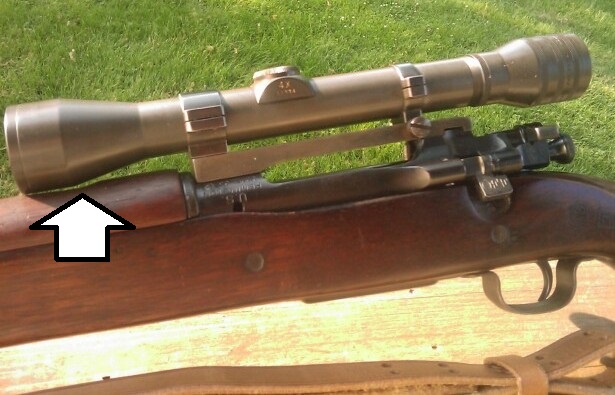

I would not change the scope on that rifle. There is really no clearance with the M1903A3 wood handguard for a modern scope with a modern/large objective bell - unless you mount it ridiculously high and destroy the simple ergonomics of that vintage rifle in the process. The best 1950s era scope that looks "right" is the Kollmorgen 4x Bear Cub scope, but even with its small 34mm objective - you still have to sand down the handguard with the typical low rings that you find on that rifles. To me, sanding a clearance cut into the rear handguard should be avoided. That handguard makes fitting a modern scope on a 1903 difficult and/or ungainly. Here's the sanding issue I noted:
Again, I'd leave your rifle as-is, it looks appropriate with that old K3 scope, and I think its legal for the CMP vintage sniper matches in that configuration. If guys can compete at 300 and 600 yards with old scope on replica M190A4s, it's good enough. Spend your money on match ammo instead.
