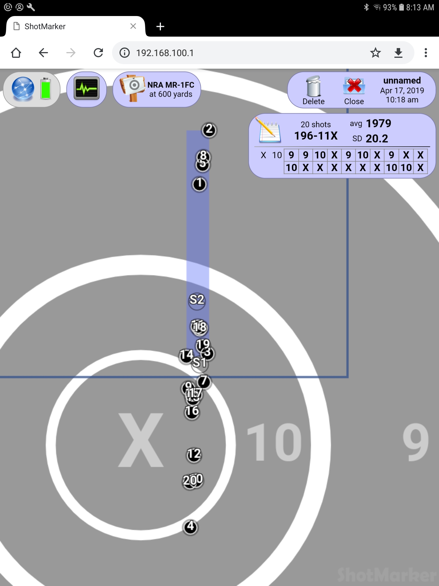

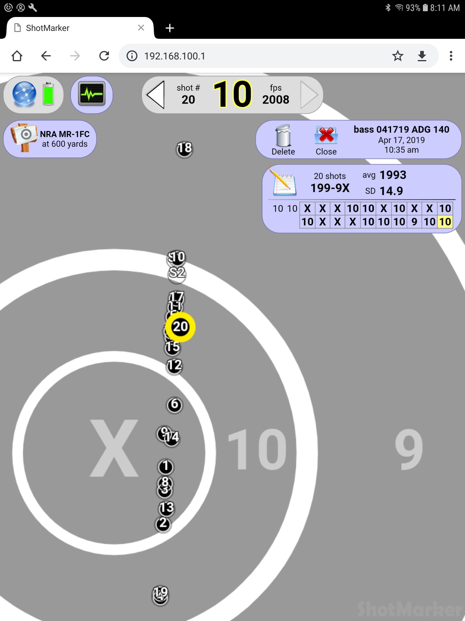

I was at the range the other day and below are my two targets. I shot two sets of 22 rounds (2 sighters and 20 rounds) using my AIAT with a 6.5 Creedmoor Barrel. I was shooting from 600 Yards. Although I am extremely happy with the results, I just cannot figure out what would cause this type of pattern not once but twice. Any Ideas?

Hmmm... I'm no expert, but I find the nearly absolute lack of horizontal dispersion to be quite unlikely, especially with 22.... rather 44.... shots at 600 yards.
I'll be the first to say it, I guess... but, I'd suspect a problem with the e-target system. Something ain't right.
Even the pattern from top to bottom is nearly identical for both targets. It's a shallow "S" shape. No way that's right. The e-target gizmo is out-of-whack. If you trace a line through the shots, it intersects the x-ring at the exact same spots (at the top and bottom of the x-ring), for both targets. The chances of you shooting the exact same pattern, twice... with 22 shots.... at 600 yards is infinitesimally remote.
I was going to leave this same comment last night, but there was a problem with my browser. There is no way his horizontal dispersion is that small at 600. Chances are that his group was wider than tall, but only one axis on the shot marker is working.
Reactions: Racer88
According to the Shot Marker's designer Racer88 you are correct. He says I quote "The sensors are plugged in wrong. If you swap top right and bottom right, you get a horizontal line pattern. No way for the system to tell the difference."
Thanks for the feedback all!
