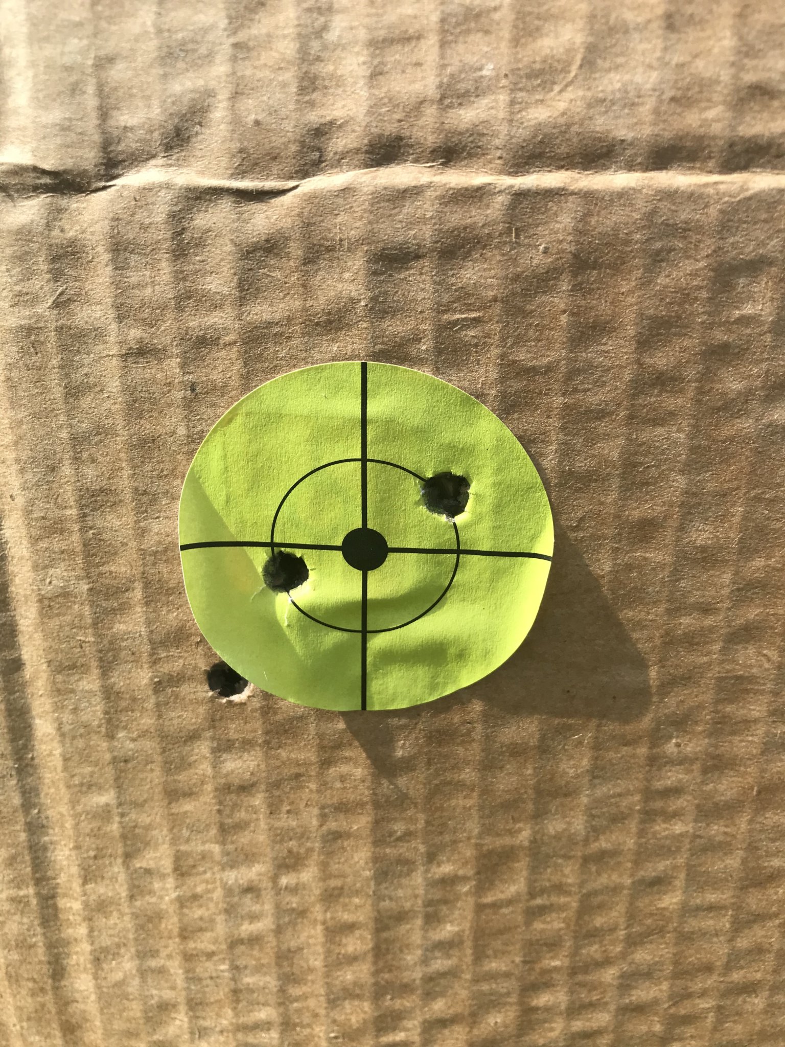

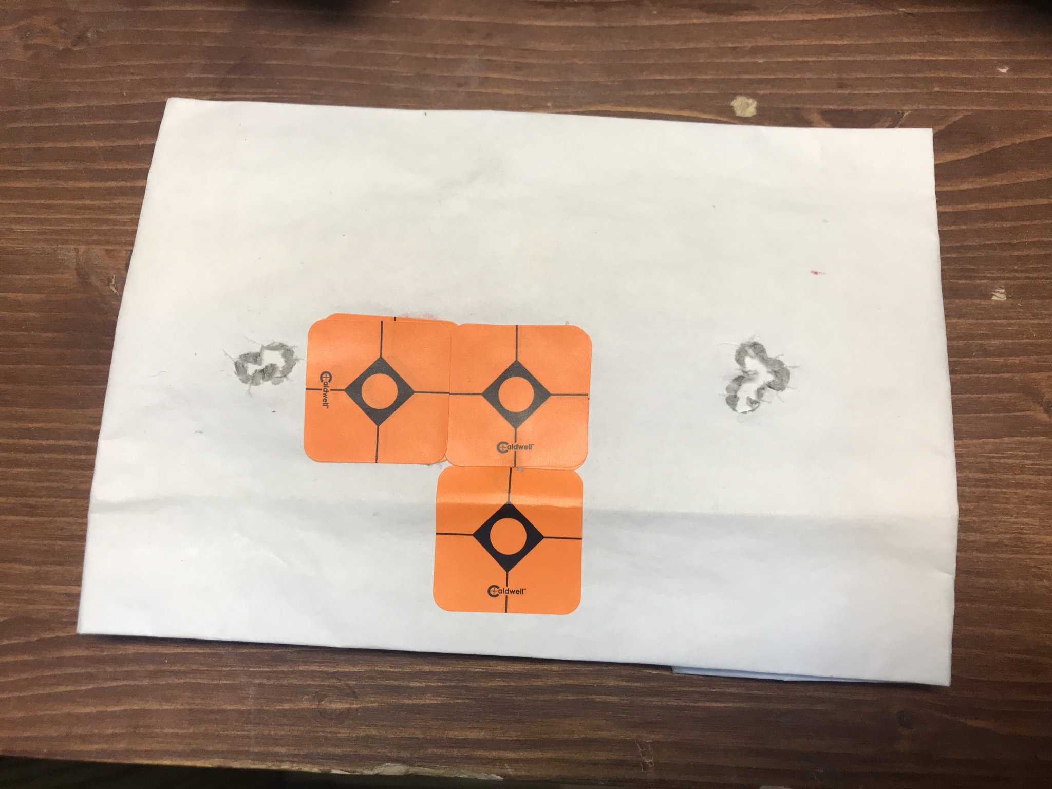

    Hey guys, I bought a 260 remington off here a couple weeks ago and was told it was a solid sub 1/2 MOA shooter with FGMM ammo (which 40 rounds came with the rifle). It was a rebarrel with a bartlein (90 rounds on the barrel) sitting in a hogue stock.

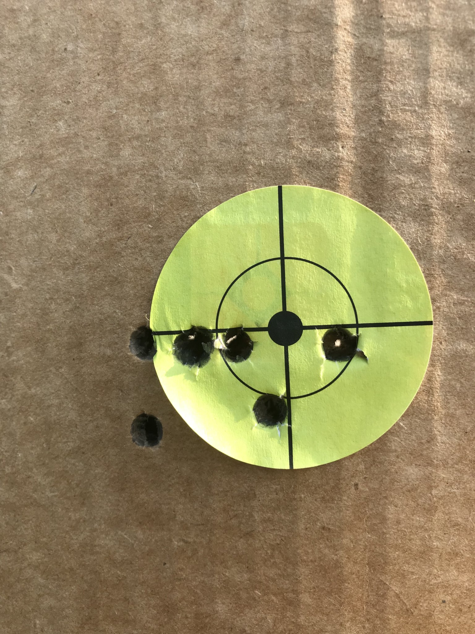

    Well I got it here and took it out to the range and it wouldnt stay consistently less than 1-1.25”. I thought maybe my scope or rings were loose so I grabbed a scope off another rifle that I knew had no problem shooting 3/4”. Same results. Thinking the flexible hogue stock was the issue I dumped it in a Manners that was free floating. Same results. I bought a box of hornady match ammo for kicks, worse results.
    So at this point what am I missing? The only thing on this rifle that is different from the last owner is the brake on the rifle but that shouldn’t make any difference.
    Should I bother hand loading to resolve the issue or just have my gunsmith rechamber it to 6.5 creed? I wanted to pick your brain before dropping the coin because I really didn’t feel like handloading for another cartridge when I already have everything for 6.5 creed.
    Definitely try more brands of match grade ammo. Handloads can also make all the difference in the world. I had a friend with a Tikka T3 that wasn't grouping with factory 308. I threw him a couple of my handloads and it was a single ragged hole.
    I’ll pull the brake off and see what happens. That wouldn’t definitely be the first time I’ve seen a brake do that much but at this point I’m open to suggestions. It was a suppressor adapater brake before and a self timer Tuebor now.
    Yea, groups aren’t an issue for me.
    Did you ask for proof of the supposed 1/2 inch groups all day with factory ammo?
    Lots of guys say it, very few can demonstrate a single target with 5 groups in the .4's
    I think the most likely suspect is that the gun simply doesn't shoot 1/2 inch groups with factory ammo.... I've -never- personally witnessed anyone shoot 1/2 groups repeatably with factory ammo.
    Clean, remove muzzle devices, rule out optics, mounts, rings, etc... Rule out stock fit (looks like you have)...
    If none of that shows improvement, inspect the chamber and bore condition-- recrown it if there's any evidence of being fuckered. From there... shoot closer distances or rechamber/rebarrel.
    It's surprisingly easy to waste a few hundred bucks on ammo/components on a rifle that won't shoot when you could've just bought a $200-350 blank and had it spun up. Not necessarily money ahead, but time and frustration for sure.

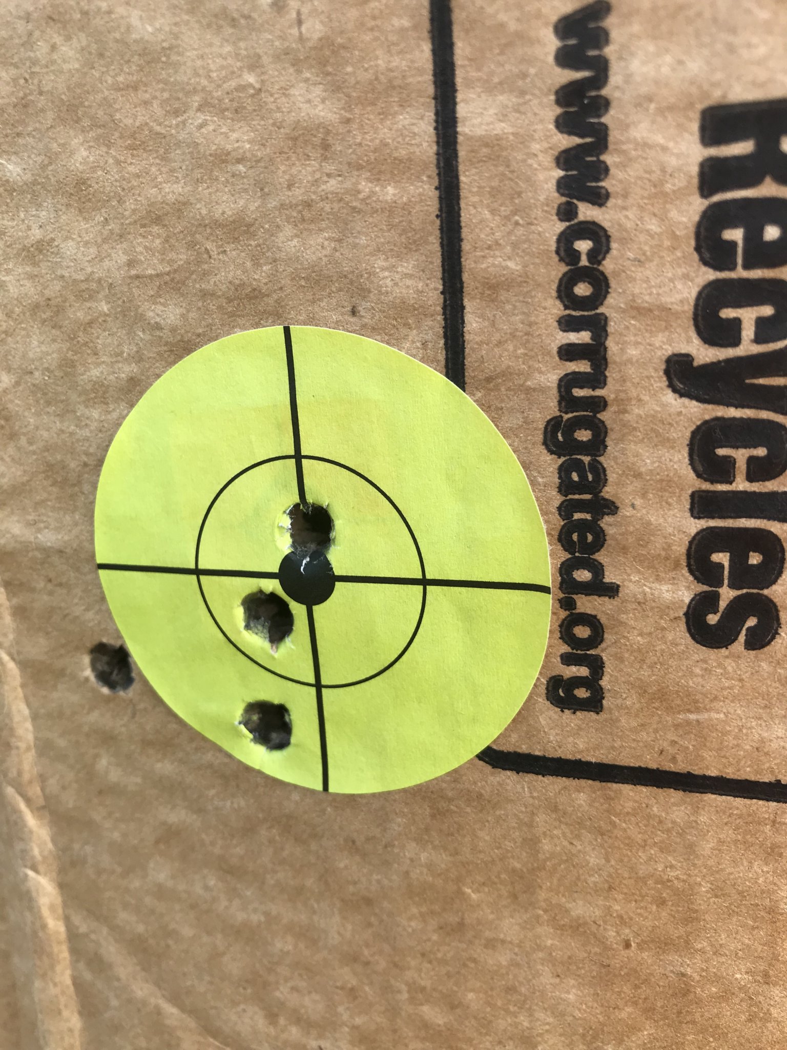

    I myself am not much of a group shooter but I will typically shoot 5rds for zero confirmation and the last 3 times ive checked zero on my new 6.5 Creedmoor barrel shooting the factory berger ammo it has shot in the .5moa range every time.
    That being said all of those are from the same lot of ammo, might change if i change lots.
    I'll fully agree that different lots of powder, bullets, etc can have an impact on accuracy. However, with the OP going from a supposed .5" gun to over double that I can't see how a different lot of the same ammo is going to be impacted that much.
    Not knowing anything about the OP's rifle, I have questions on if this was in fact a Bartlein barrel. Who chambered and installed it? Did the seller have any receipts or documentation for it?
    He's already swapped scopes/rings so that should be ruled out. He's tried different ammo that in a premium barrel should certainly perform better than it did. Was the scope base tightened down properly? How is the headspace? Did he take a look at the throat as has been mentioned a couple times?
    There aren't that many potential root causes left...

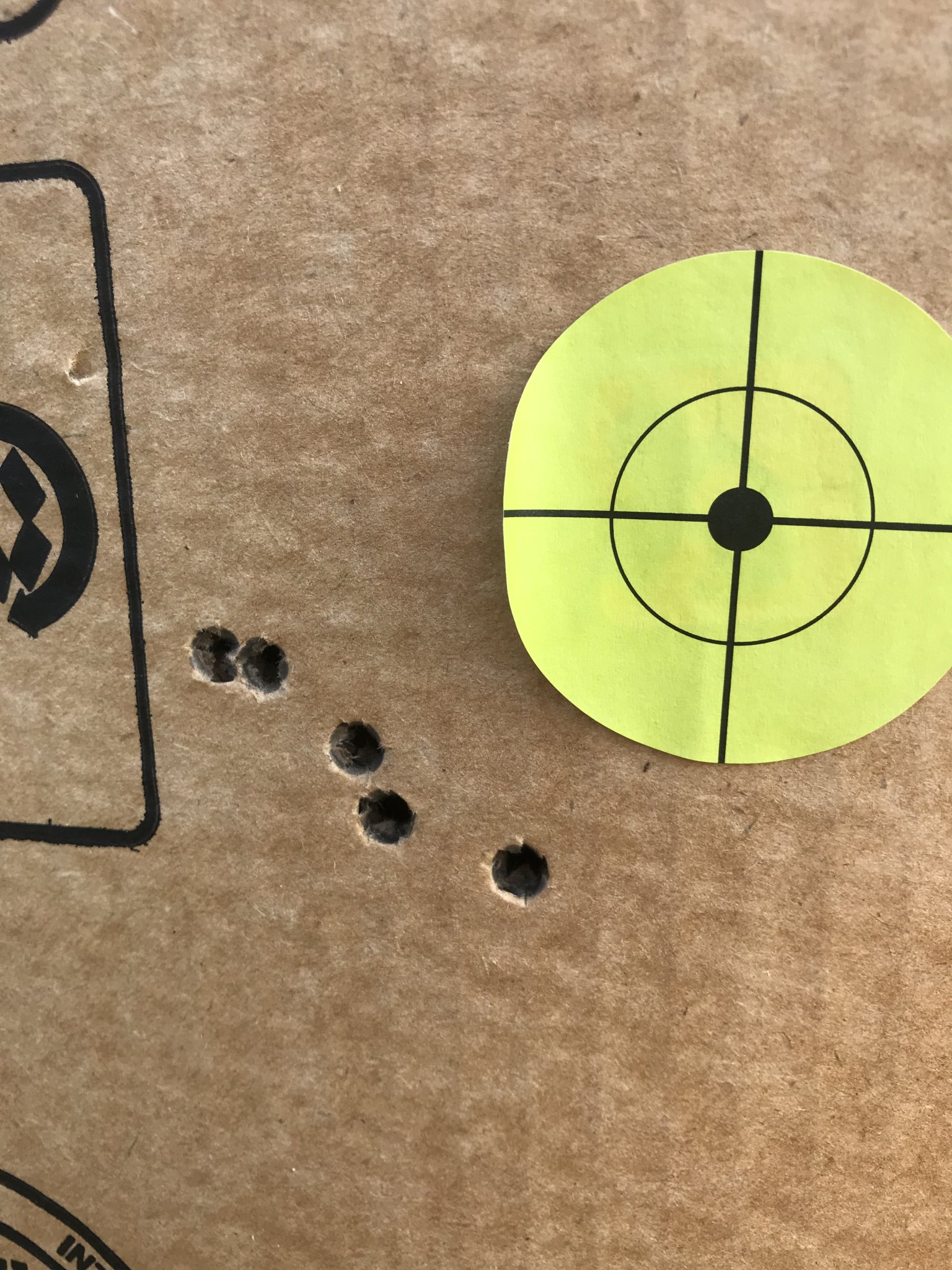

    Yea, trying to slowly chip away at each of these one at a time.
    Scopes have been swapped and I checked that rings and base were properly torqued (as well as the action screws while I was at it). I swapped brakes out this morning to an APA Lil Bastard and it seemed like it might have had slight impact on the groups, but overall nothing too impressive. I thought I was getting somewhere when it stacked those 3 shots left of center, but unfortunately those were shots 1, 3, and 5...not 1, 2, 3. The first two groups appeared to consist of some horizontal stringing, but then the 3rd group just completely opened up.

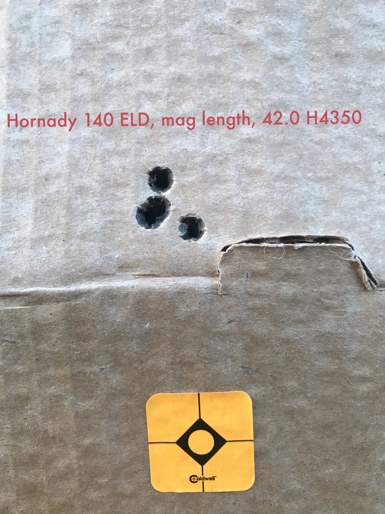

    I'm going to load some scenars and ELDs to mag length and give those a try. If that performs similar results to what it has been doing, I'm going to drop it off at the smith for a bore scope and most likely a rechamber into 6.5 creed with a new reamer.
    PS: POI shift on the second group was intentional dialing so the impacts wouldn't cover my point of aim.
    Shoot it w/o the break, as a break made wrong or the tolerance stacking on the barrel can kill group size.
    +1
    I threw a flash hider on my 6.5 grendel hunting rifle and the groups grew by about an inch. As soon as I took it off and put the thread protector on it went back to normal. Sometimes kit just doesn't play well together.
    If shooting it without anything on the barrel and it still wont group I would think you got screwed...
    Try it without ANYTHING on the barrel for a group of two and observe the changes.
    Just has the self timer brake on there just it's just beyond handtight with a wrench so I wouldn't think that is it. I'm going to test it a bit more later today and I'll shoot a few groups without a brake on there and see what that does.
    I see definite stringing of groups, I'd look at bedding or action stress. I always bed aics and manners gen1 mini chassis at the tang. Both do not support tang at rear screw or behind, anything over 10"/lb on rear screw and it starts bending the action. Some action/barrels dont mind it and others shoot like this.

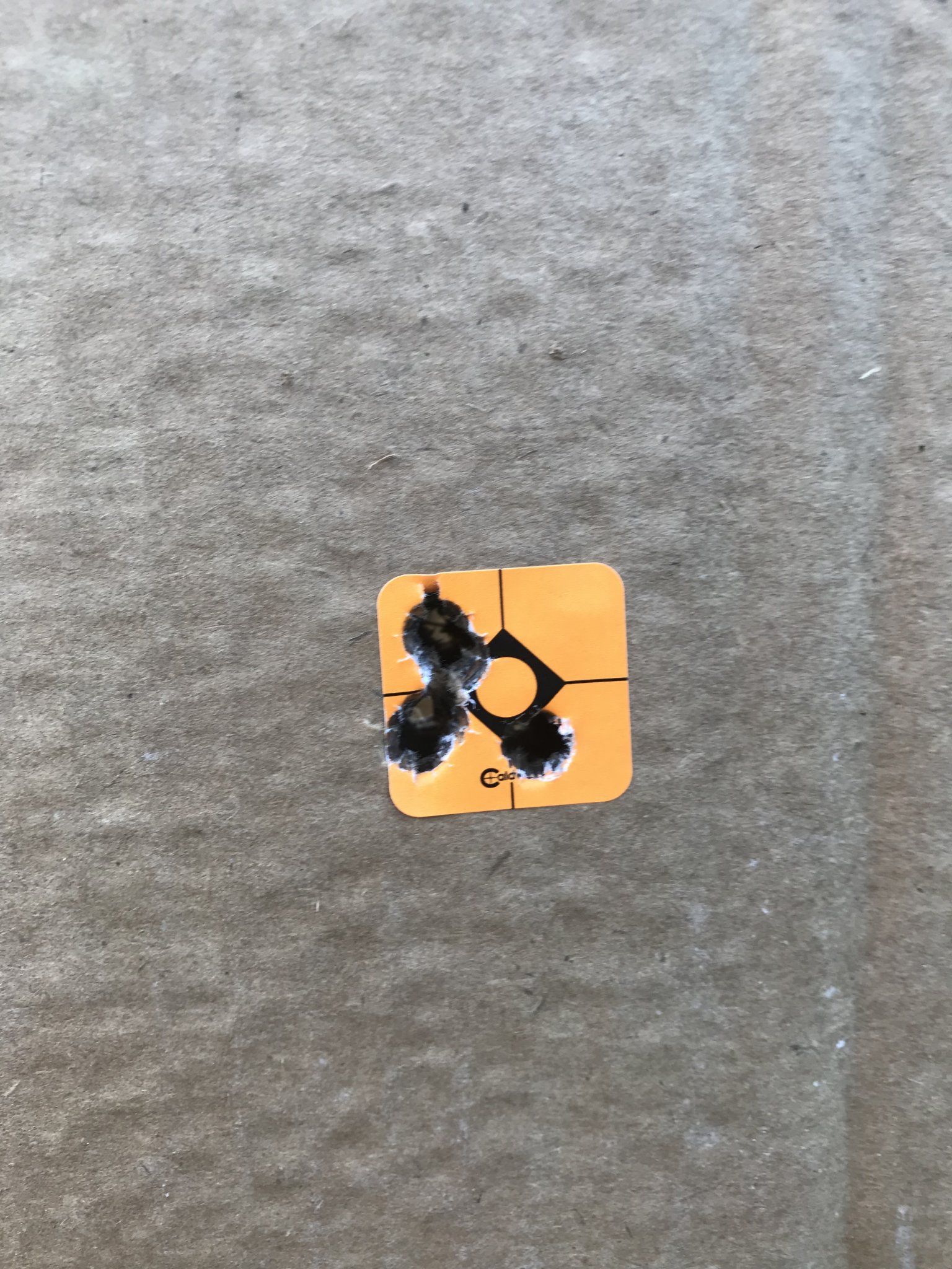

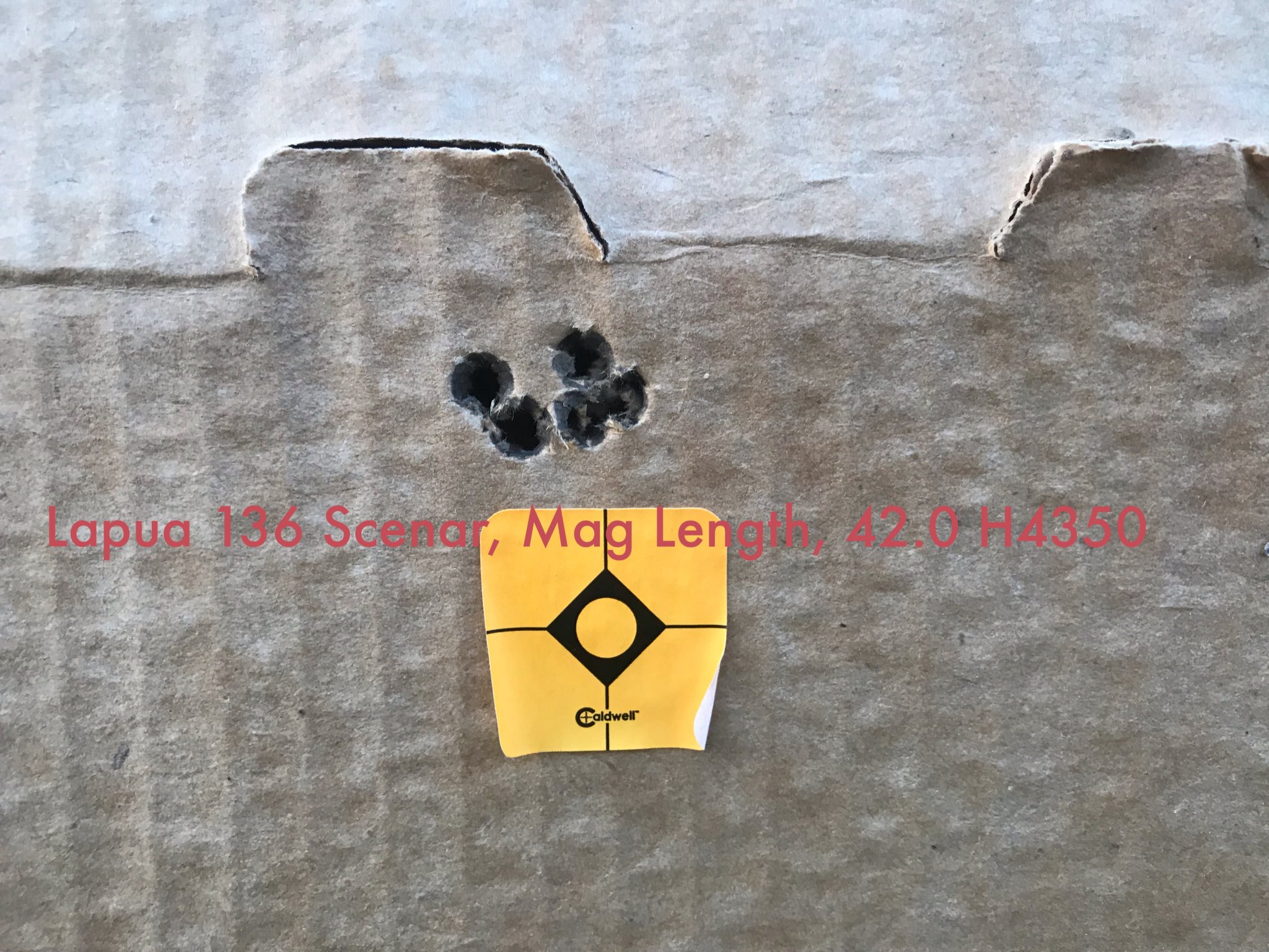

    I really wanted factory ammo to shoot since I bought the rest of the ammo that SWFA had on their sale, haha. Seems that’s a no go so I’ll have to see if my buddy’s rifle will shoot them.
    I loaded 136 scenars and 140 ELDs to mag length and let them rip. To my relief they finally pinched together.
    Yea, I’ll toy around with powder charge and seat depth. Bummed it won’t shoot factory ammo, but at least the entire barrel isn’t a lemon.
