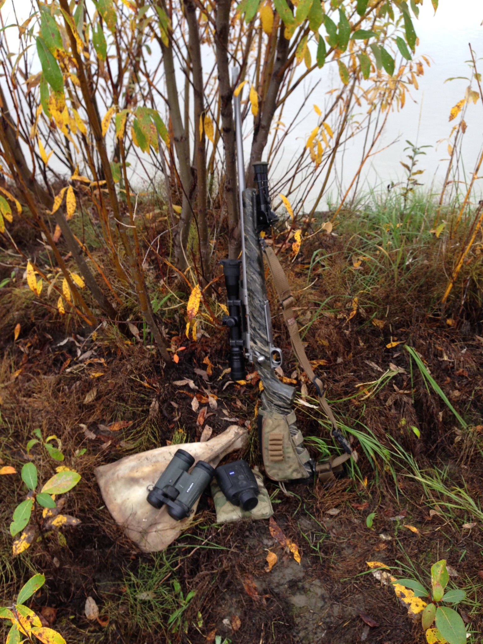

A little hard to see it, but this is one of mine. I like the fact it’s not too “Huble’ish” and is still robust. Not really light, but certainly not in the heavyweight category.
