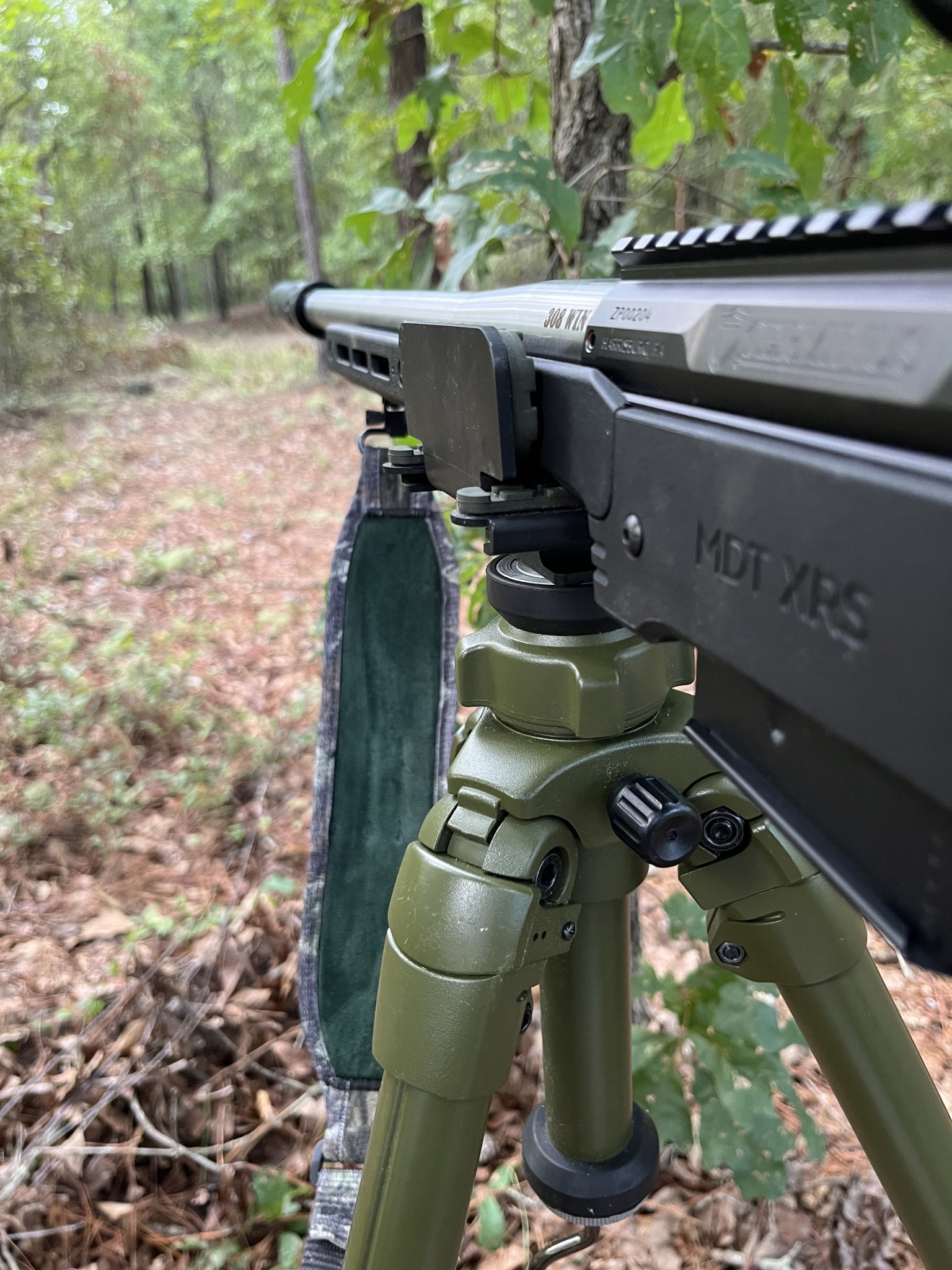

20 inch 308 suppressed on a terminus Zeus action. Takes care of anything we have here in South Carolina. Also just upgraded my tripod and couldn’t be happier. I got a lightly used Fatboy two section used here on the PX and pair it with their inver ball head. Rock solid combination for sure.

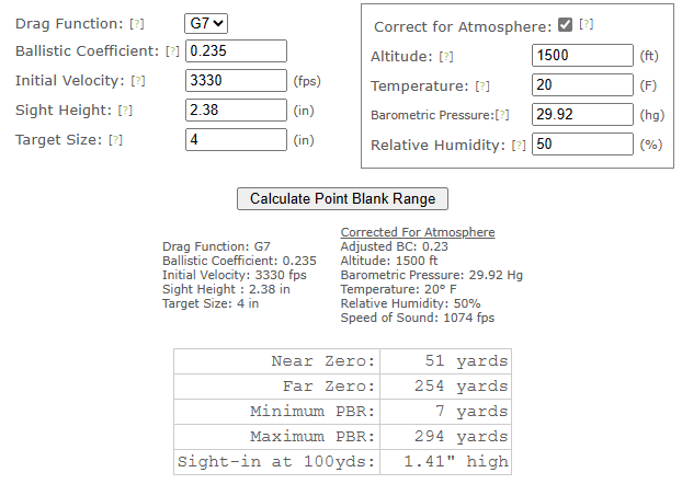

So if I say a coyotes vitals are (a very conservative) 4 inches tall, and I use point-blank range calculator https://shooterscalculator.com/point-blank-range.php and get the following (22 Creed), I should just zero at 50 yards, and would be good to hold center-coyote out to roughly 300 yards, correct?
What's your max height of your bullet flight and at what distance? Let's say it is close to 2" high and this happens from 130-200 yards. If you have a 4" inch kill zone that is 2" on each side. You may be approaching the top edge of your kill zone where most of your coyotes will be shot just so you can stretch your PBR out to 294? I see this a lot and lots of guys missing high and blaming their thermal.
Reactions: SupressYourself
That's why I chose 4 inches instead of a more realistic 6-8. I've shot enough coyotes to know that if I hit them 2" from my point of aim, they are still very much dead.
