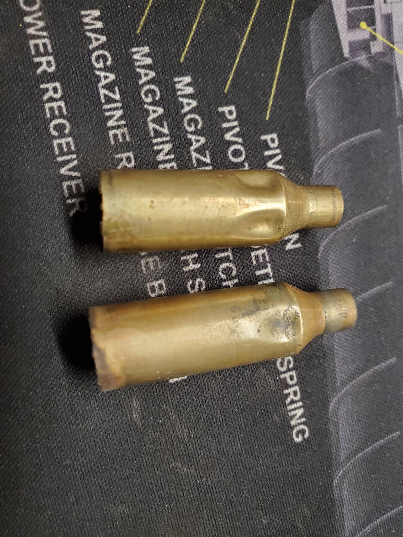

What's denting these cases? Are they still good to go?
westsidecamper
Aug 13, 2020
143
40
I made these 300 blackout cases from Lake City 5.56and shot them once from an AR. After cleaning and resizing I noticed that they have extremely similar dents on them. When I form brass from the LC 5.56 cases I do not have these dents on them, only the ones I've shot have these. What gives? Are these still fine to reload?

If those are fresh-fired, and you have not resized them yet, then that concentric and consistent dent is from either of 2 things... 1) Low chamber pressures (subsonic rounds can do this), or 2) that's where the cases are hitting the case deflector on your AR's upper receiver (the little metal nub that sticks out just aft of your ejection port).

They were loaded with Hornady 110 gr vmaxes at the starting load for H110 from the Lee book, I forget what that is off top, but they're definitely supersonic. Cycled the gun perfectly with an A5H3 buffer.
I tested the magazine theory out by loading the mag with a couple, chambering, then cycling by hand. No issues there. I need to test out whether that is where they are hitting the deflector but that has to wait for a range day.

Too much lube or a clogged die.

300 Blackout doesn't really have a shoulder but usually you keep lube away from the shoulder of a cartridge. That area gets pushed back quite a bit during resizing and the lube gets trapped in between the die and the shoulder. The dents will almost always be on the shoulder of the brass or just below it. Most setups don't require lube on the neck either. I run a tiny amount on the neck in a few neck sizing dies but that's about it. Lube is really meant for the case body and for Maggot (aka Howie)

Is the dent happening after you size or while you are shooting them? If it’s while you are shooting id say the gun is way over gassed and slinging them hard into the brass deflector
I don't know, as I wasn't paying a ton of attention to the cases before I resized them. I just checked to see if they had any obvious pressure signs and tossed them in an ammo can. I'll found out soon.

I know you said you werent really paying attention to ejection pattern but if your brass was landing forward of your ejection port it would be over gassed. It also looks like in the picture of your brass they are swelled forward of the case head.

I just looked at the picture again, and it appears he has a couple of primers that are bugging-out... He might have been running them way too hot. Or he could have a bad chamber in that barrel. Overpressure rounds in a gas gun can also cause some weird shit to happen. Or, if they were running hot, they were slamming that bolt back fast, and slinging the brass hard into the deflector. He could very well be over-gassed, or overpressure on those loads.
I think post 21 & 22 nailed, the shoulder length on your brass is too short, causing gas to come back in your chamber denting your cases. You may be able to fireform the brass with a warmer load.

IMO, hydraulic dents from lube or brass hitting the deflector should not crease brass like that.
If it was gas blow by wouldn’t the cases be covered in soot?

No way someone cleans and sizes a pile of cases with dents like that and doesn’t notice it. Plus those dents look exactly like lube dents. Ask me how I know.....

Lube dents 100%. Those dents look like shallow bubbles. Shell def dents are sharper than that. It should be fine to shoot them. It will blow the dent back out.

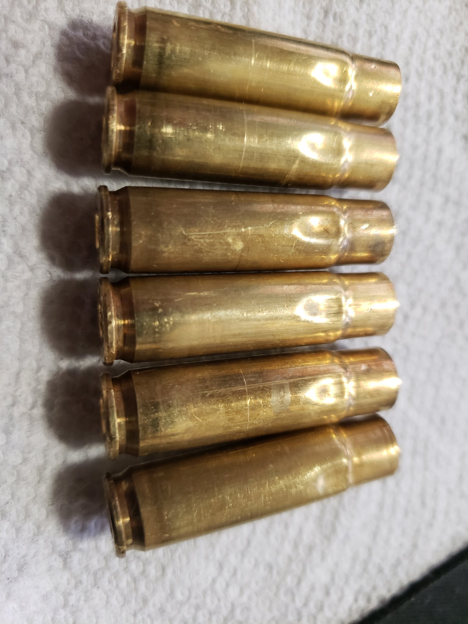

While a bit large it shows the same round soft edge characteristics of a gob of lube in the die. Maybe a pice of lint covered in lube?

I do not know if they showed up before or after sizing because I only checked the primers after shooting, then I cleaned and sized them without paying a ton of attention. I do not have any fired, unsized cases to check. So yes, I did notice them after sizing. I did not check them thoroughly after shooting, though.
What I do know is that when I'm forming new cases from 5.56 ones it does not cause the dent. The dent is only on cases that have been fired then sized. All but one of the fired, sized cases has a dent on it in that same spot. Let me know if I need to clarify this further or with more images. I was using Lee's case lube, which I apply with my fingers.

It’s from too much sizing lube. The reason you didn’t notice them until sizing is because they weren’t there. You’d notice those large hydraulic dents....
Clean your die, cut your lube to about half of what you’ve been using. If using Hornady one shot, make sure you let it dry on the case before sizing.

But the dents are pretty much the same! They’re not perfectly identical because when he slathered the lube on he didn’t do it in a perfectly identical way. No way a shell deflector dents the case right under the shoulder that deep.

I suggested this possibility because these pics are cases dented from a known headspace issue post firing. My understanding of the original post was the dents were post firing, as I assumed no one would resize that many cases after seeing a dent in the first couple. These looked very similar.
