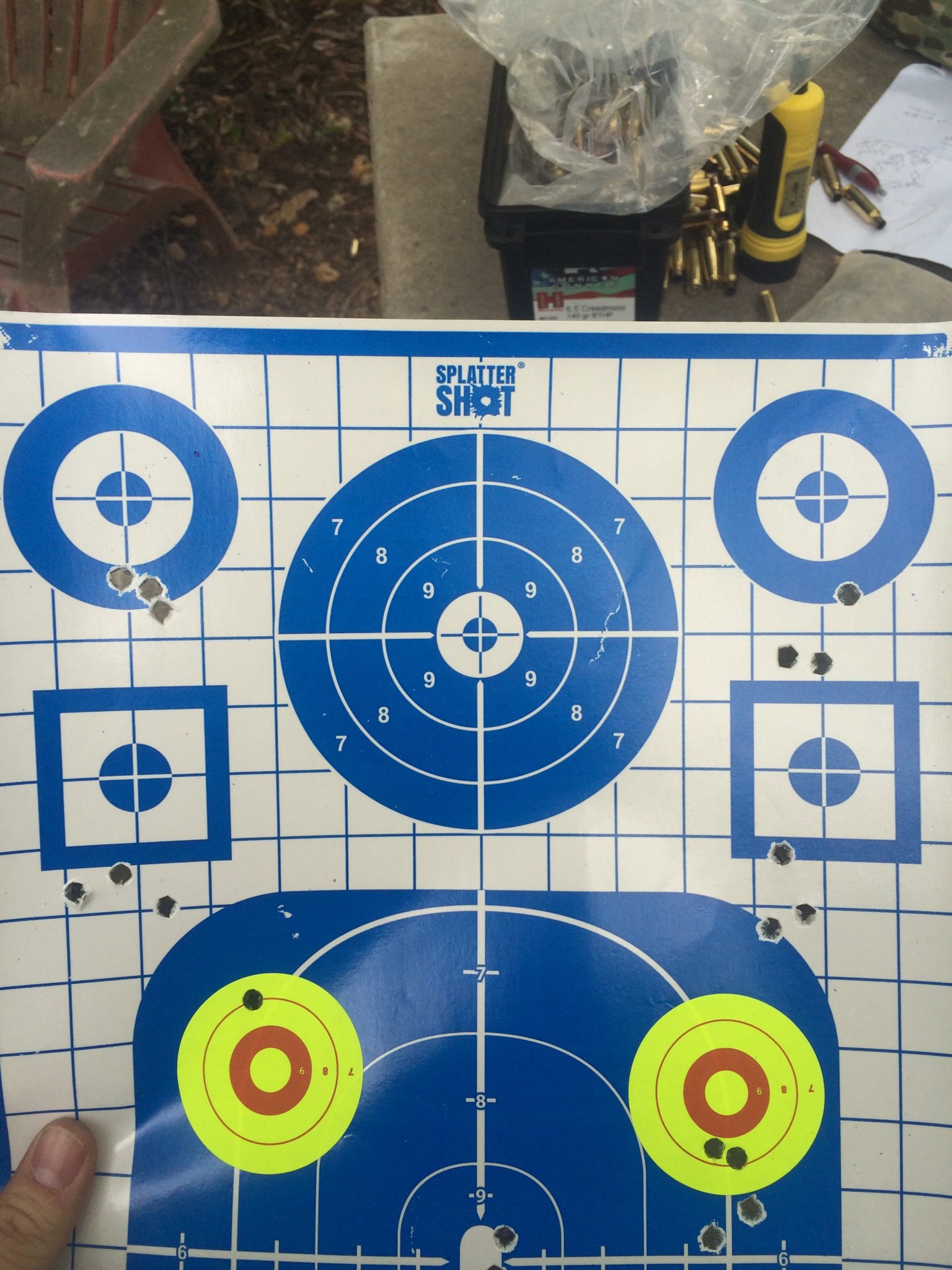

I took my rifle out today for the first time to break it in and get some groups on paper. Rifle is a bighorn Tl3 , bartlien heavy palma 6.5 creedmoor 24", manners elite t6a, trigger tech blah blah blah ... All best of the best. I did a proper barrel break in . I tested hornady 147 m, 140m, 143 eldx, hsm 140 vld hybrids , nosler 140 otm, nosler 140 accubond. All of them were showing high pressure. The rifle wouldn't not group any better them 1-1 1/2 " @ 100 yards. I have been shooting bolt guns for years. I even shot a few of my other rifles to make sure I wasn't having a off day. I got frustrated and streched a few others guns out to distance. When I went back to shooting the new rifle I had zero signs of pressure!!! As ammo , same boxes .... But groups still not there.. Any ideas what the tits is going on ??

Have you checked that your scope mount screws are properly tightened? This happened to me once at a match, the scope was sliding around in the picatinny slot. They were clamped down enough to stay on the rail luckily.
I assume you mean propper beak in by cleaning between rounds. My guess on the pressure is the chamber was not wiped clean. That can cause pressure for sure. Accuracy is anyone’s guess other than the standard “are you sure our scope base is tight, etc...”
This was what I was going to post so... x2
As for the groups? Thats why we reload.

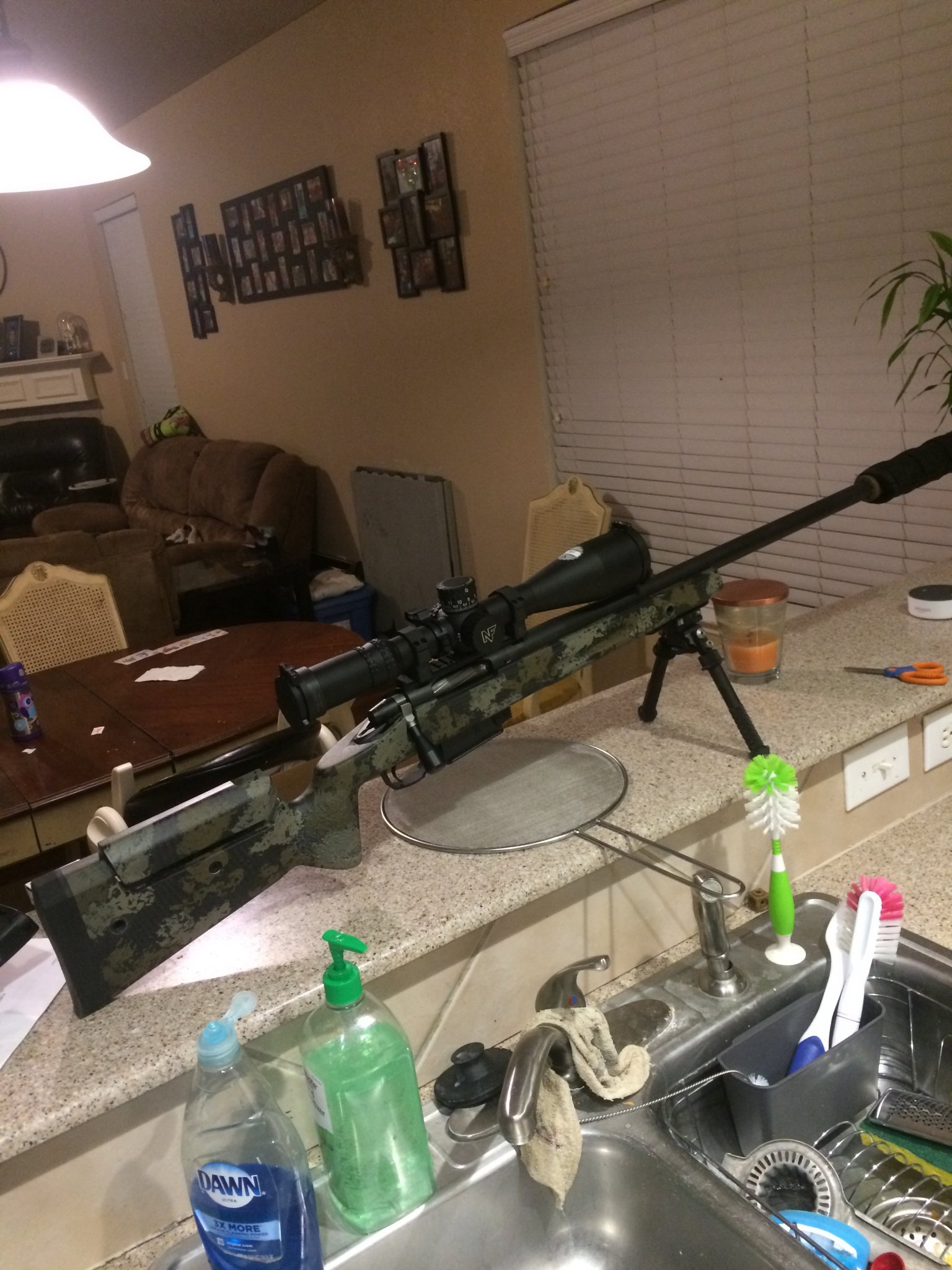

Yes scope base torqed to 50 inch lbs, badger rings ( cross bolt to 65 inch lbs) and rings at 22 inch lbs
Yes I fired one shot the removed copper. Did that 3 times ( wiping chamber dry after every cleaning ). Then went to 3 shot groups then cleaning .
Hmm. I had an issue like this with a semi-custom last year. Found out a lense in my scope was knocked loose and it was making my groups average 2 inches. Had to get it replaced.
Maybe run a couple more dry patches through, then swap scopes and see if it changes anything.
If that doesnt work, is it a manners mini chassis? If so id re-install the action to the stock and ensure theres no funny business going on in there.
Im just spitballing here. Theres not as much that can go wrong with a bolt action so this is a mind boggler for sure. Best of luck and keep up posted!

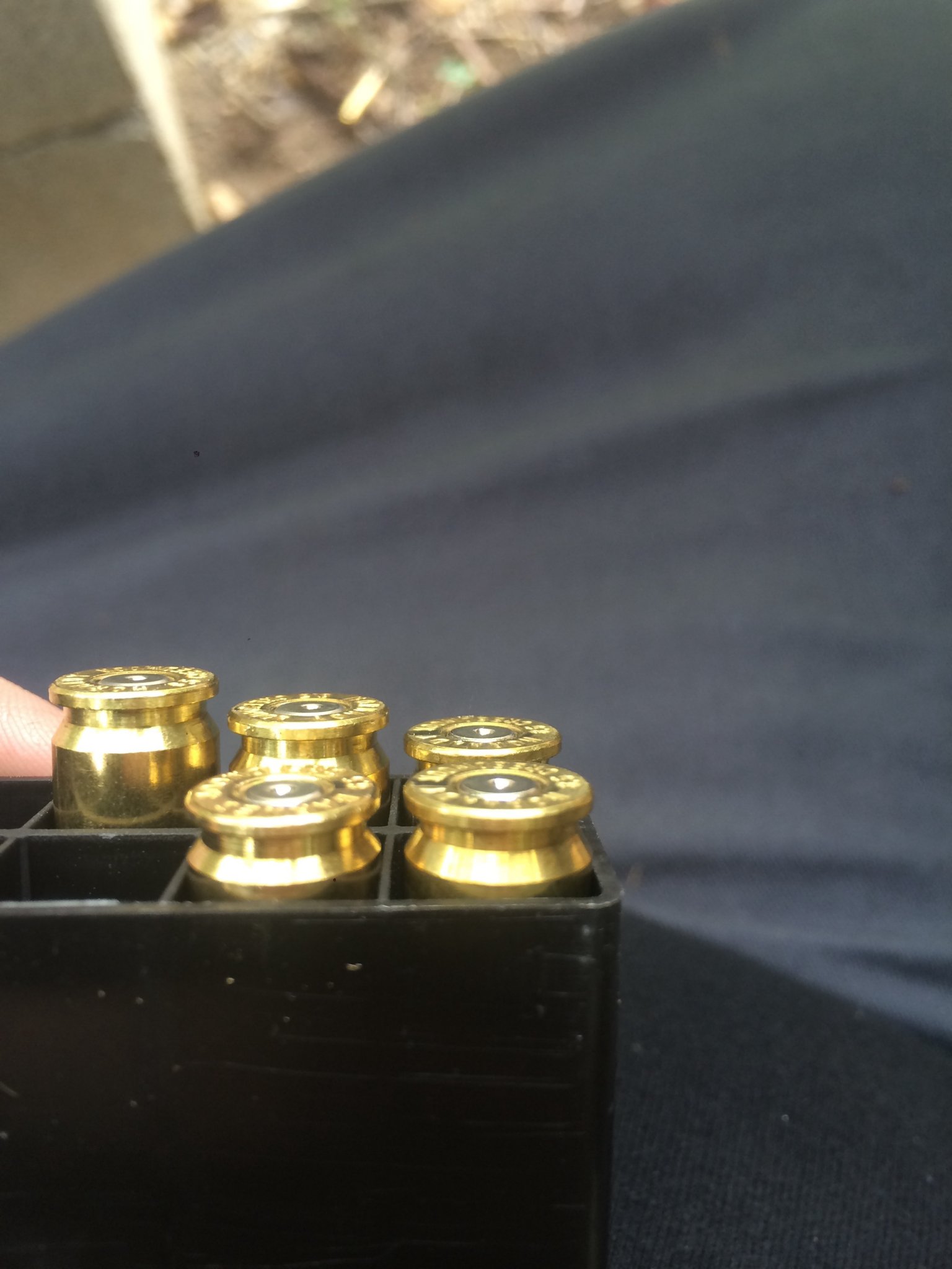

Ive experienced similar case head marks with my can on sometimes when its been similarly moist out or when its extreme cold and i dont let the gases dissipate from the chamber. The primers always end up looking, just fine like yours, and not much in the way of hard bolt lift, just like yours. When cans off goes away so i just end up living with the case marks and dont think twice. Try shooting with the can off next time when you experience it and see if it goes away.

If you’re certain that the barrel is dry when you’re shooting, I’d check the seating depth on a few of the bullets you’re trying. I suspect that the rifle may have an extremely short throat, and that your bullet is being jammed after you chamber it. Can you chamber a round and then extract it without the bullet getting stuck in the barrel?
Impossible you say? One of the best builders in the country did this on my $4500 build and when he got it back, he couldn’t believe it.
