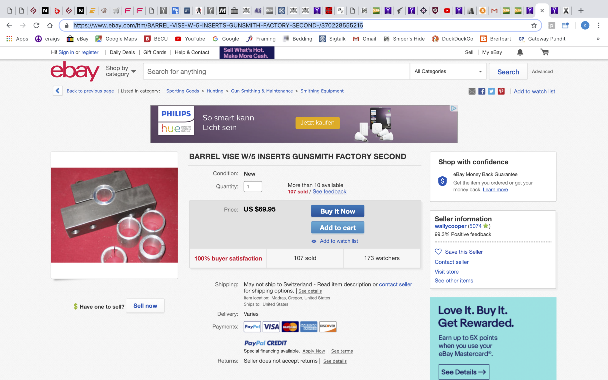

    Here's my suggestion for a barrel vise;
    https://www.ebay.com/itm/BARREL-VISE-W-5-INSERTS-GUNSMITH-FACTORY-SECOND-/370228555216.
    I use NAPA automotive, copper based anti-seize. Nothing special, works fine.
    My opinion isn't popular, as I don't care for the Vipers. I wore one out and went with the one above. The one above is rough. You will need to deburr it and clean it up a little. However, it's a brick shithouse that even a Marine couldn't fuck up.
    My opinion isn't populra, as I don't care for the Vipers. I wore one out and went with the one above. The one above is rough. You will need to deburr it and clean it up a little. However, it's a brick shithouse that even a Marine couldn't fuck up.
