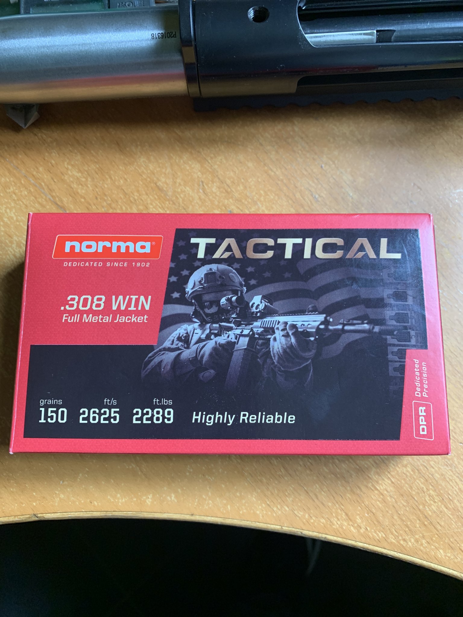

Give the Norma a try. If your gun likes it then you’ll also have good brass to reload.
Aguila is absolute garbage.
Norma has been doing some great work lately. I tested their whitetail line with great result and will use it next season. I have always run steel case thru my various AK rifles I've owned over the years. A few months ago I bought a bunch of Norma 123 and got just a hair over MOA at 100 out of my Sam7sf. I've also heard great things about their 168/175 offerings.

PS, can somebody define "tactical", as used in this instance? Seems like a marketing label they slap on anything they don't have another name for.
