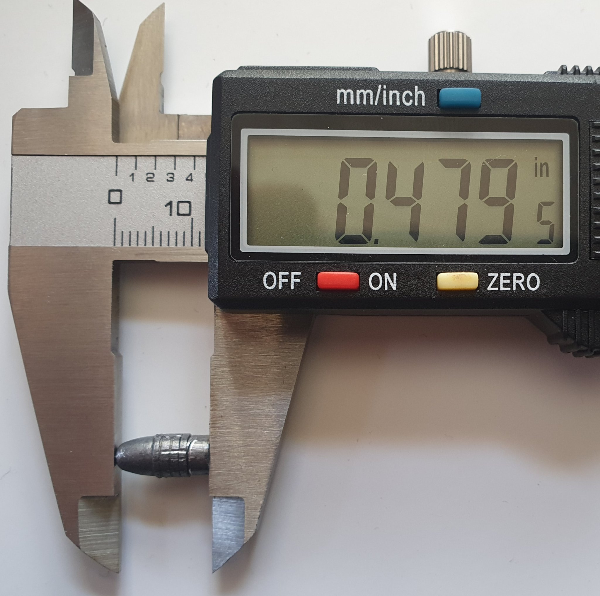

Here is a RWS Rifle Match S bullet.
I cut the brass open with knife and wiggled the rim open.
The damaged side of the skirt is left out.
I would say that 0.48 is very close.

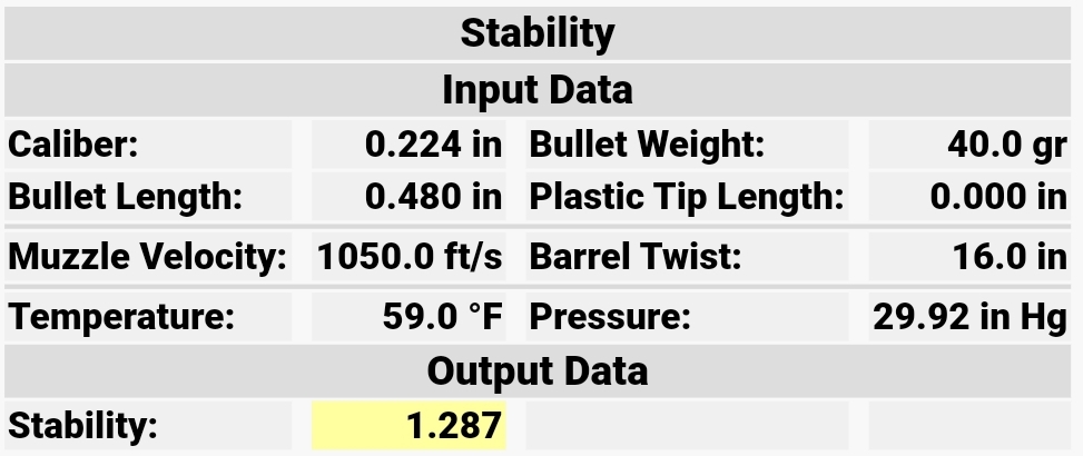

JBM ballistics Stability calculator with 16" twist:
0.48" bullet 1050fps
Stability: 1287

0.48" bullet 1020fps:
Stability 1.287 (unchanged)

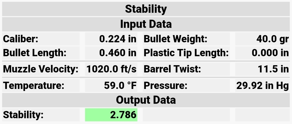

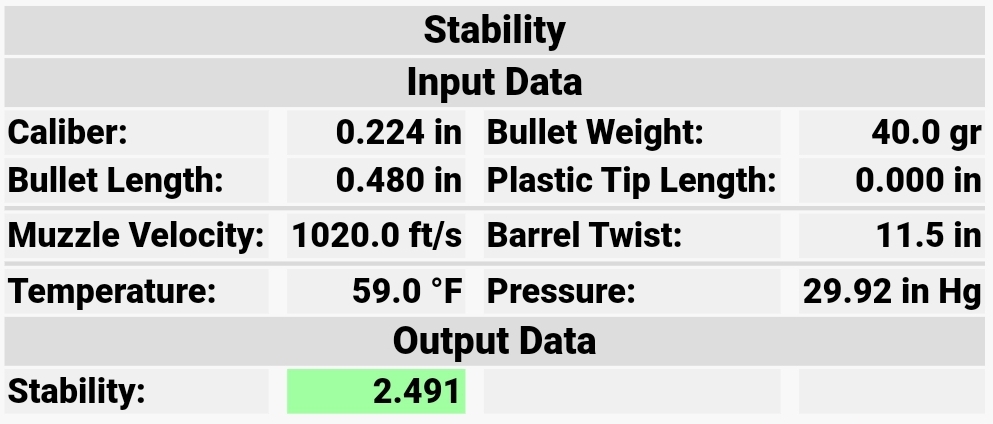

JBM ballistics Stability calculator with 11.5" twist:
Stability 2.491
0.46" bullet 1050fps
Stability 2.786
Stability 2.491 (unchanged)
0.46" bullet 1020fps:
Stability 2.786 (unchanged)
