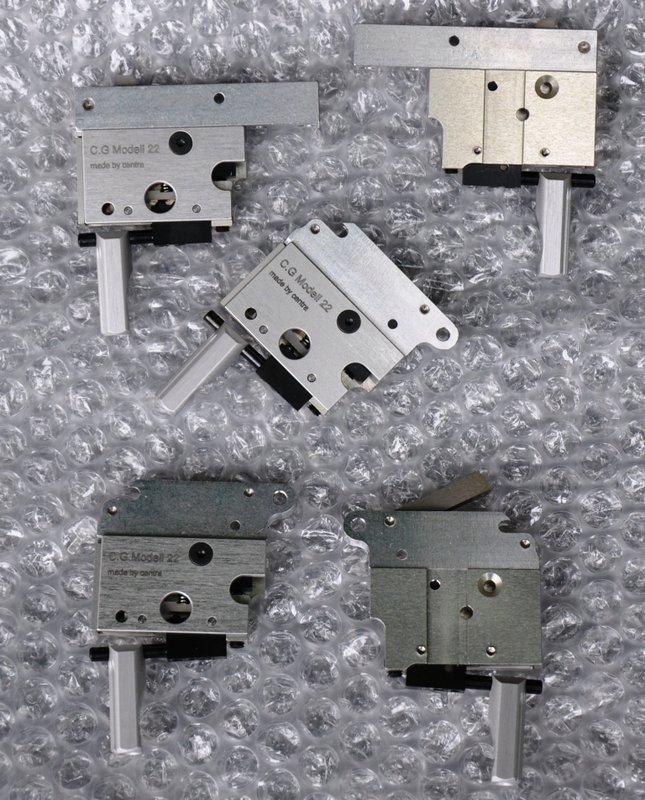

US made and marketed CG mod 22 is simplified configuration and only fits rem700 and clones.
European made fit 10+ diferent action types as its a moduar trigger with different uppers and sear configurations availible basicaly with dedicated upper it can be fit to any action that you can think of.
