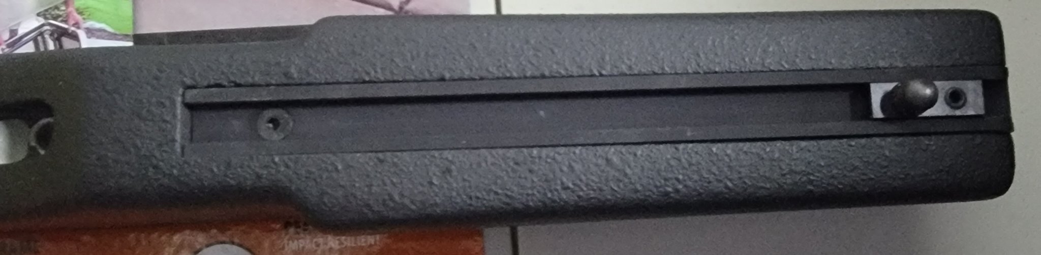

Looking to get a picatinny rail mount on the foregrip of my B&C Mark V stock
It's this rail here:

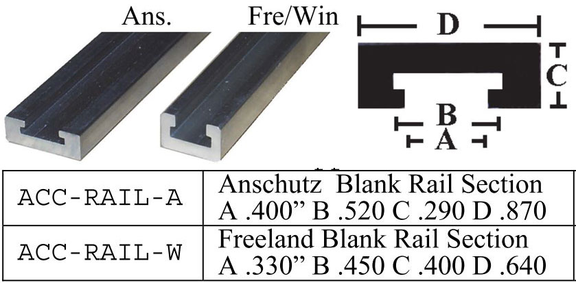

Is this the correct adapter? Or are there other options?
Would like a longer adapter, may just buy two of these if they are in fact what works here. If anyone can confirm I would really appreciate it.
I believe those are Anschutz style rail, you could start your accessory search there...or could just grab one of those picatinny/swivel stud adapters...
eta - that Afar kit should work
Reactions: Host
The rail is either an anschutz pattern or a freeland. I’m pretty sure the atlas kit allows for either if you rotate it 90 degrees. You don’t have to use the small section in that kit, you could use a 4” picatinny section if you preferred.
