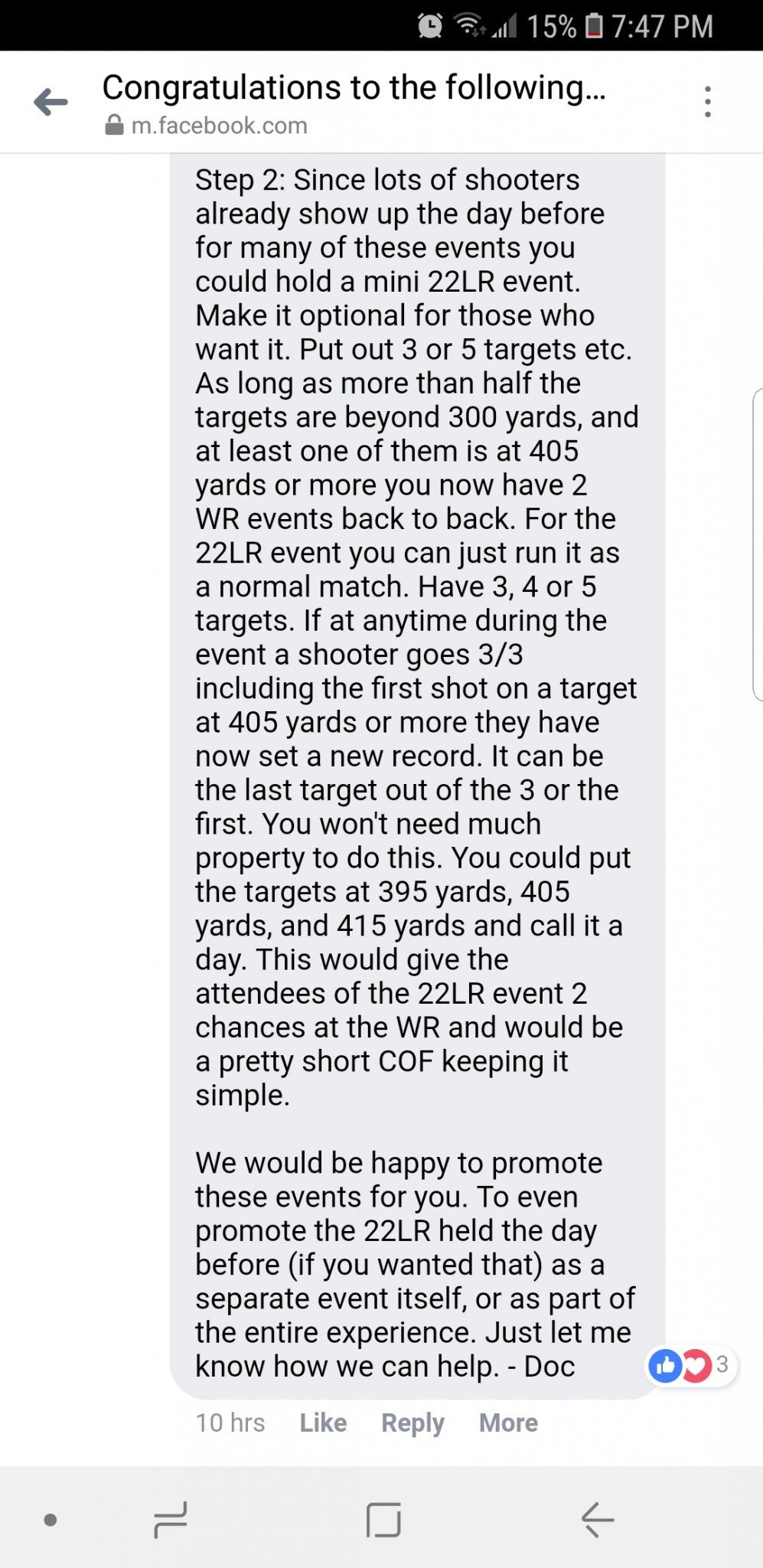

    Curious about this as well after seeing the 3 for 3 on a 12x12 plate at 395 yards in the ELR match with 22's. That is pretty damn impressive to me.
    Under these rules it doesn't sound so easy.

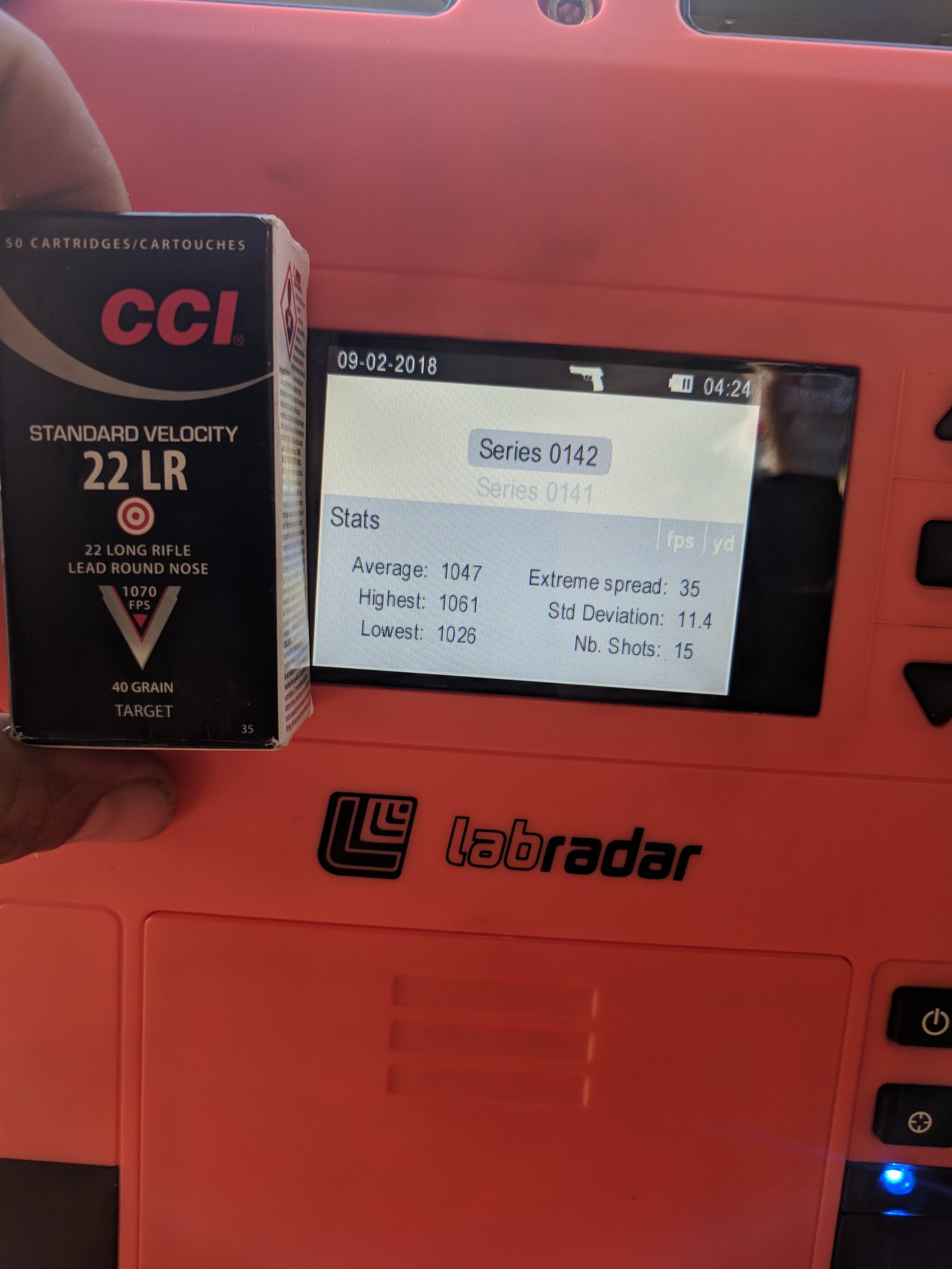

    SK Standard 10 Shots
    CZ 452
    50 Yard Group size .3
    Stats - Average 1048.2 fps
    Stats - Highest 1060.62 fps
    Stats - Lowest 1037.76 fps
    Stats - Ext. Spread 22.87 fps
    Stats - Std. Dev 6.25 fps
    Bradu,
    A 12x12" plate at 400 yards is very repeatable when conditions are consistent.
    Catch a great condition and you'll wish you had more ammo and a video crew as that 12x12" plate will seem the size of a city bus.
    The Ko2m guys are doing it right by splitting it up with 4 hours in between.
    The first round hit is key to this though. It's not like you cherry pick your conditions when you shoot a match. You act like they won't keep shooting if they continue to make hits lol
    Not saying you cherry pick conditions.
    I'm saying that when conditions become good and guys are setting "world records", I would consider luck to be involved.
    Split it up like the ELR guys have done if anything is gonna be referred to as a world record.

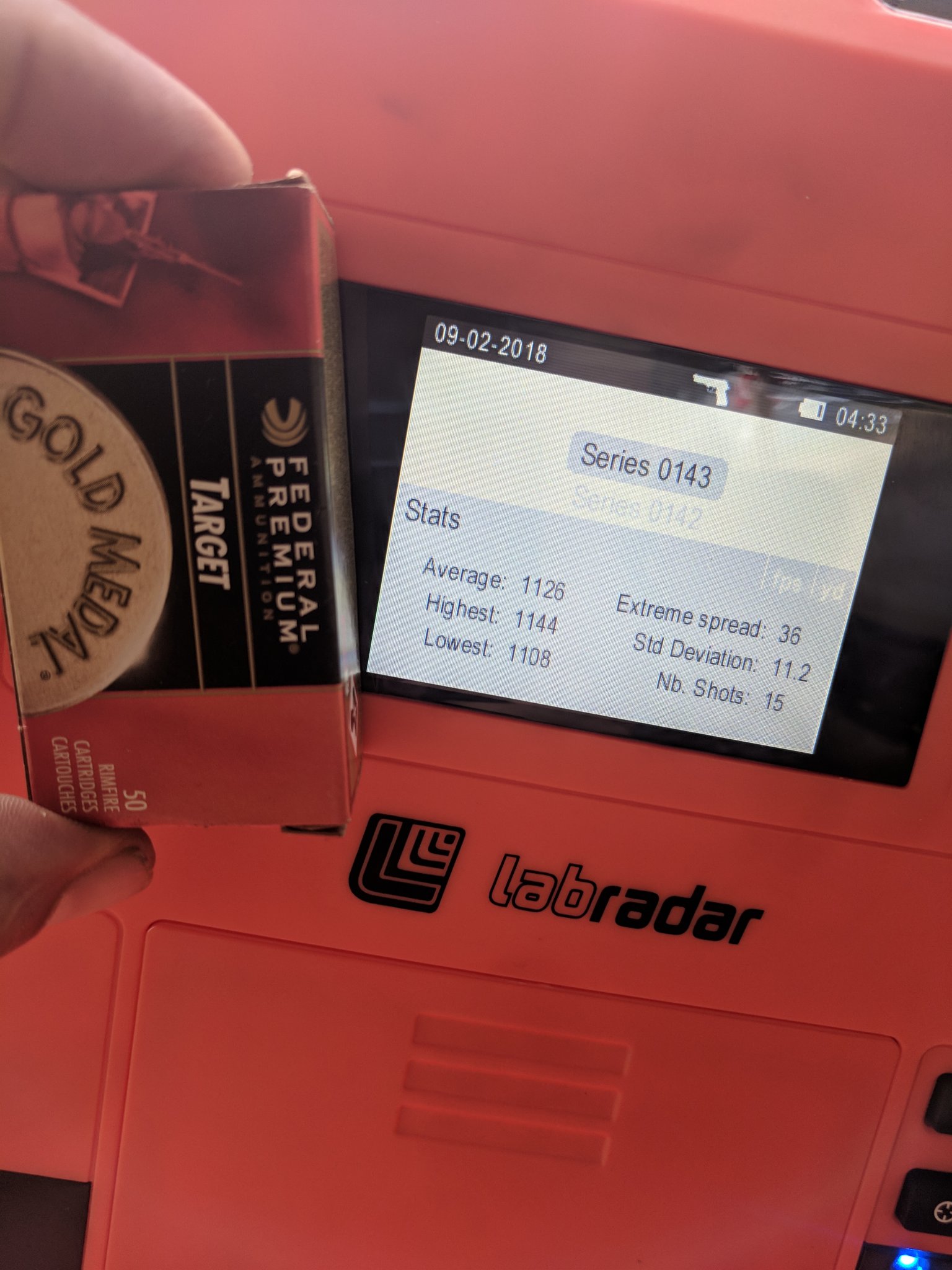

    Reactions: Geno C. and Bradu
