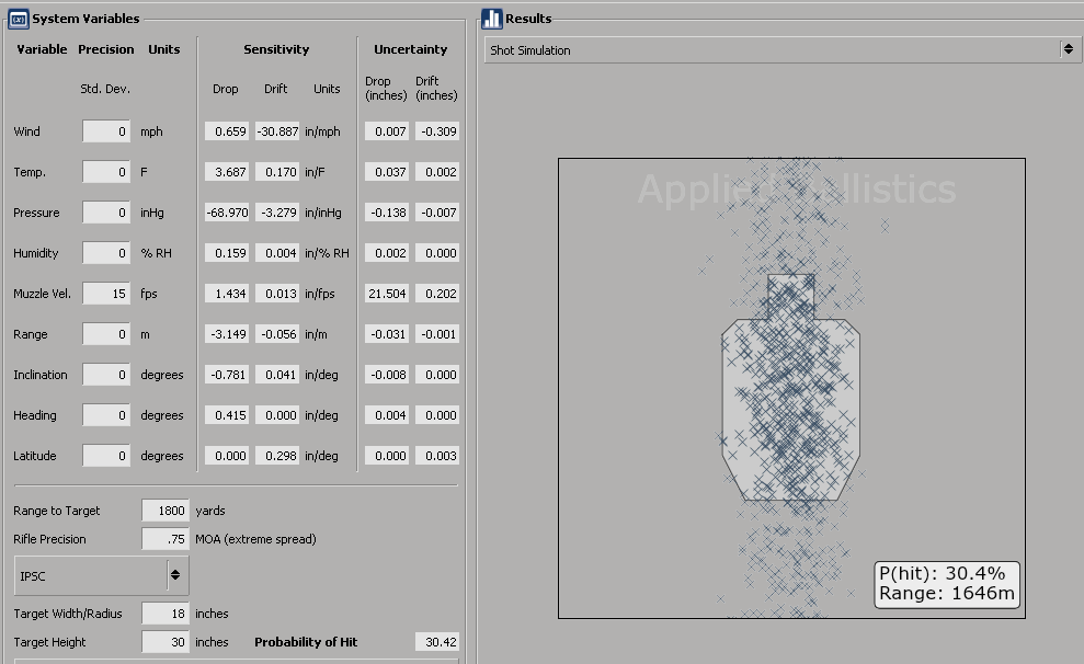

FYI ELR: Just due to optical issues, your gun is not going to have the same minute of angle as it is at 100, unless it was an anomaly. Now add in a bit off SD/ES.. and you're going not only to have a substantial vertical component but a hare more drift... Wait wind? I hope this makes sense.
Here is an example using a 130VLD - it is only a relative example and does NOT include any of the variables that cause the misses I mentioned above: FYI I generally think in mils but will use MOA and linear inches
Let's assume 2900 AFPS
Factory Ammo: SD 15 ES 50 over a couple of boxes -Typical excellent factory ammo
1800y
Wind mild 5mph FV
AFPS25 FPS change
Velocity ONLY based Change​
50 FPS changeVelocity ONLY based Change
Elevation Linear in inches1707.81743.61
35.81+3/4MOA = 49.9"​
1780.12
72.32+3/4MOA = 86.43"
Wind only from velocity variance154.4155.86
1.46 +14.11" =​
157.31
2.91+14.11

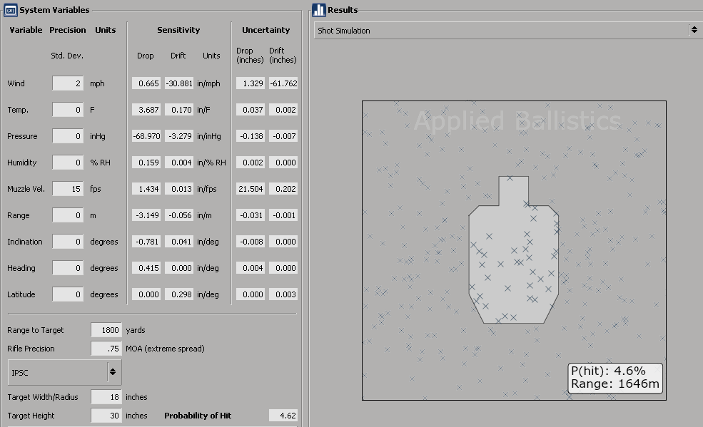

Now, if the mirage or dust in the air displaces the image .5MOA variance (that's ultra-low for mirage at that distance BTW), add 9.4" to the numbers above.
With a Max ORD of about 700 inches and 1800y, let's assume a minimal 2mph in wind variance during your day. As this academic example steps along, add 2" to the vertical and crazy horizontal 61.8"+14.11" or almost 76" of uncertainty on your 18" plate, without Velocity errors or the Optical uncertainty.
Below is an Analysis on a ZERO WIND Variance, No Optical variation and low very low factory MV variation (antidotal as it may be, I have never shot ELR without some variance of wind)

FWIW I am not saying that you didn't get lucky and bang the plate a bunch in a row, but the reality is it is not something that can happen all the time.

0 wind 0 optical? Remember that any mirage, light refraction or optical offset is almost alway present at those distances is going to turn my .25MOA ELR gun, into a something like a .75MOA+ gun or much larger, even in a bench rest. Remember that your .75 RPR is probably really a 1.25MOA with ELR optical. But, 0 wind, 0 Optical, 0 SD and your sure to bang the plate all day
I can not imaging being 0 wind variation ever, even when we perceive it as windless.. especially over that distance and with a mx ord at 700+"
0 SD and .35mph (variance in wind -not sure thats even possible) with absolutely no other variables, gets you there. Just a 1mph wind shift, 0-SD and it's like 35%. 0-wind, 0 optical and 5SD and NO other variables, gets you there, but again nothing in this paragraph is realistic.
Again, not saying you didn't put together a great string.. Just is not going to be repeatable.. Just like my videos at 2000-2400y with shots uber close, who knowns, maybe the wind blew a big miss back into the target, it is more of an anomaly than every day.

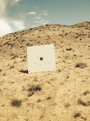

This was with a 20" AI-AX 130gr Berger VLD @ 2850fps. 1760yds, the 5 shots have a horizontal spread of 18". You can obviously see it took a few to get my verticle hold just right. I think I was at 22 mils.
