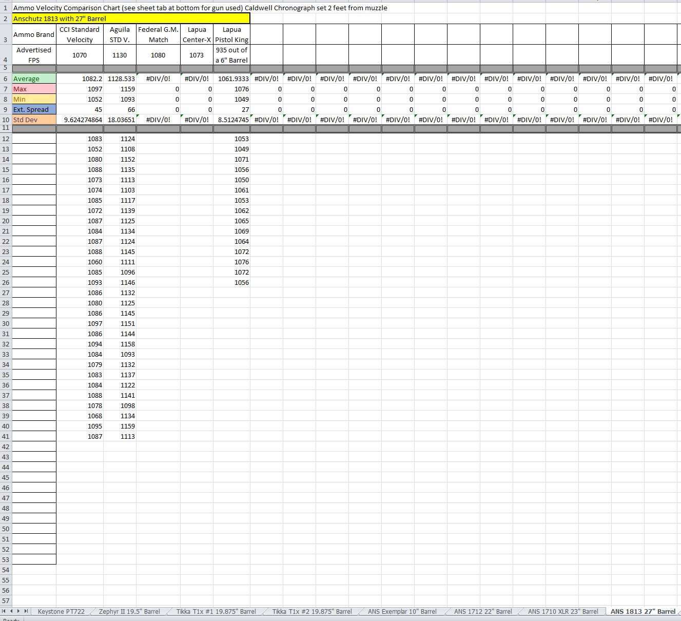

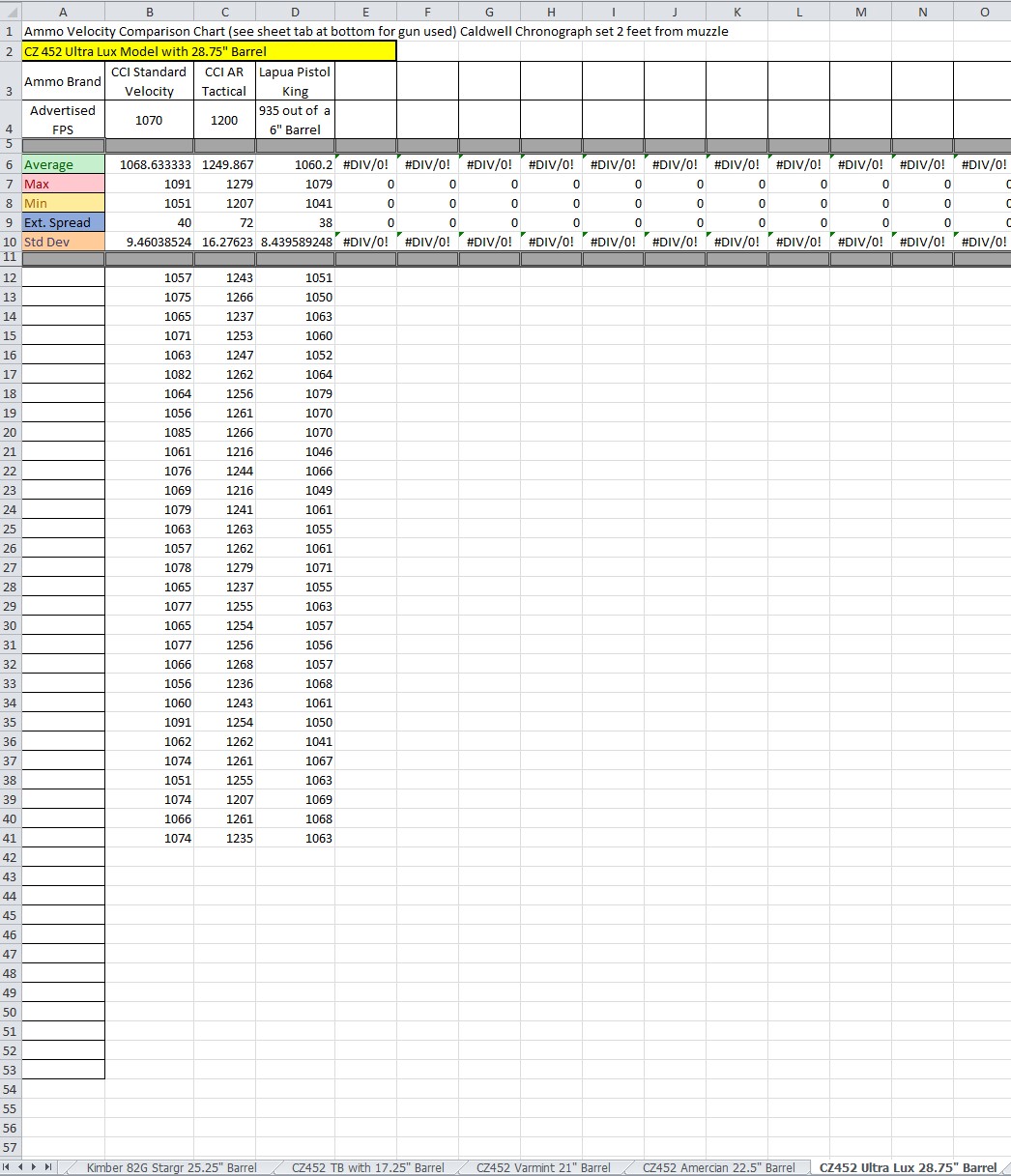

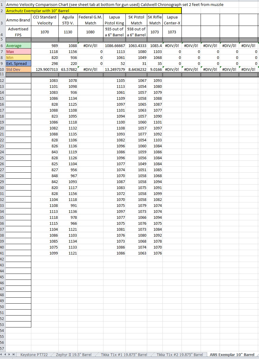

I have 8 different 22lr's with 26-30" barrels on them, and have chrono'd dozens more. None exhibit slower velocity than any of my shorter barrel rifles.
I'm not sure where this little piece of internet knowledge of bullets slowing down before they come out the barrel came from... but I've never witnessed it, and I've never seen compelling data to support it.

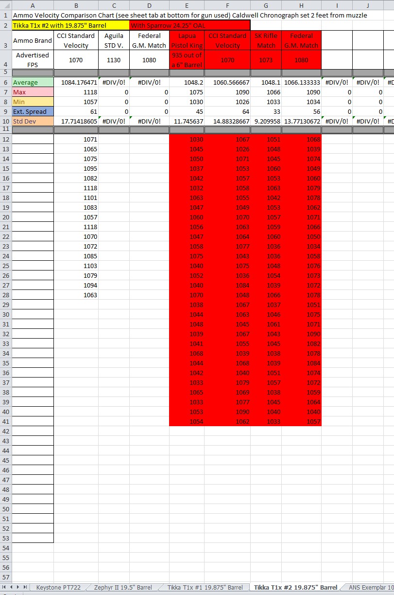

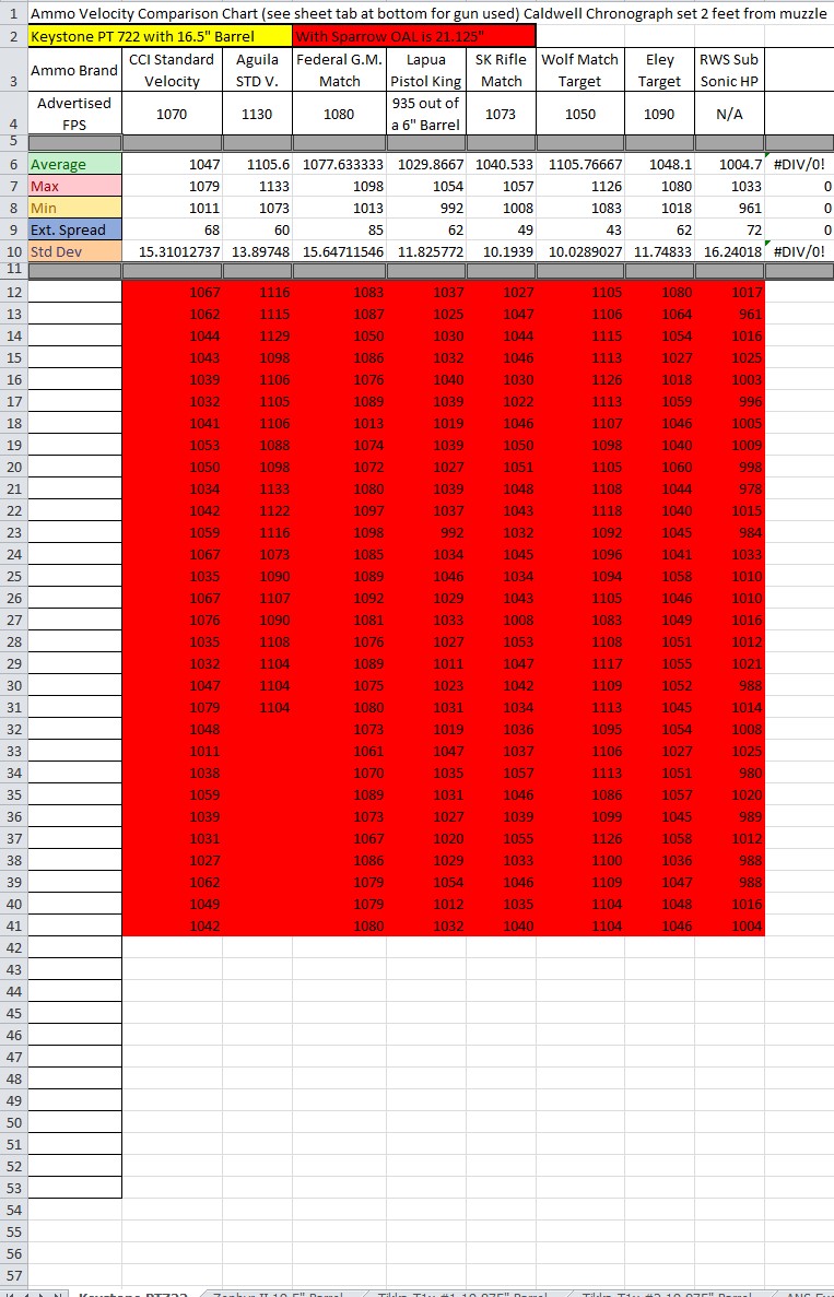

I might be able to contribute to the barrel length vs velocity discussion. I, myself was curious awhile back about this and since i had the means I did my own test. All ammo used was from the same lot regardless of rifle it was shot from. Actually everything was the same conditions except the day. Obviously I couldn't do all this in one day.
Below are chrono recordings from the shortest barrel to the longest barrel. You can see for yourself the effect the barrel length has. Keep in mind, this is for my rifles only and your results may vary.
Slugging is for barrels that are already flawed to begin with. Circa 1985 technology.
Advancements currently being made/already made have passed that up.
@RAVAGE88
To put it simply, slugging is a waste of time, mostly promoted by many that can't actually speak to why they do it or have it done. In addition, lapping a taper into a bore doesn't accomplish anything either. Kevin Nevius is as open about going against the grain on this as I am and you won't find a name much bigger than his in small bore. While we're at it, I guess we have the prime opportunity to go all the way and say there's also nothing purely magical about button barrels and rimfire accuracy....
Consistency is what promotes accuracy and the length of the barrel isn't necessarily important as long as you, your rifle and ammo, as a system, are consistent and you know everything about how it performs to be able to make it all work. Tight spot? Useless, but so what. Tapered bore? Waste of time but who cares. SAP or PAS? Again, who cares....There are ways to develop consistency through proper design and process but there's also a lot of conjecture to dig through to get to the things that really make a difference. To stick with "construed conventional wisdom" and not question why it's done, or worse, propagate it while having no idea what you're propagating gets no one further down the road.
MB
