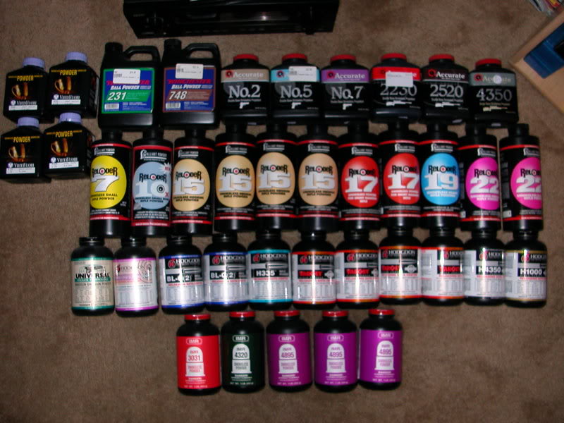

They're all delicious and everyone has it's place in my powder stable.
Chris
ya know Chris, Its only a matter of time till you're demonized and called a Hoarder. So to help you out Im sending you my shipping info, cuz you need to spread the wealth around, its good for everybody. :D good collection ya got there.
Ha!
Those are only the sealed ones.
Cover your bases, while you can, no pun intended.
Chris
