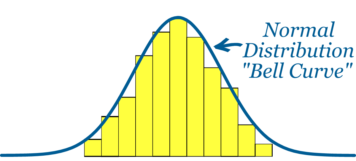

Standard deviation only means something if the collection of your samples resembles a Normal distribution (bell curve). A LOT of things people sample end up looking like a normal distribution, but it's hard to get there with a sample of size 5.
ETA: This covers the basics pretty well.

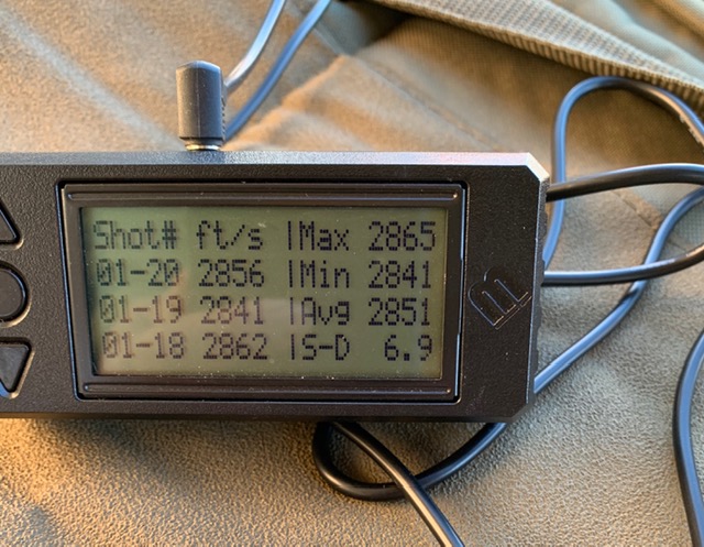

(Not that it rly matters but this was 40.4 grains of RL16 in 6.5 Creedmoor Lapua SRP Brass , CCI400 Small Rifle Primers, Berger 140 gr Hybrids)
Bunch of 10 shot groups:
no reading, 2814, 2815, 2813, 2805, 2819, 2815, 2813, 2815, 2806
avg: 2813
SD: 4.5
ES: 14
Temp: 74.5
2818, 2808, 2815, 2819, 2817, 2810, 2813, 2810, 2811, 2816
avg: 2814
SD: 3.8
ES: 11
Temp: 75.5
2810, 2816, 2819, 2813, 2807, 2807, 2812, 2814, 2815, 2812
avg: 2813
SD: 3.8
ES: 12
Temp: 76.4
2814, 2814, 2816, 2805, 2816, 2815, 2813, 2814, 2809, 2808
avg: 2812
SD: 3.8
ES: 12
Temp: 76.9
2818, 2815, 2811, 2813, 2822, 2815, 2811, 2814, 2809, 2806
avg: 2813
SD: 4.4
ES: 15
Temp: 77.9
2818, 2808, 2815, 2824, 2809, 2813, 2807, 2805, 2814, 2813
avg: 2813
SD: 5.6
ES: 18
Temp: 77.9
2813, 2812, 2812, 2816, 2813, 2809, 2816, 2817, 2812, 2807
avg: 2813
SD: 3.3
ES: 11
Temp: 77.8
2814, 2812, 2815, 2805, 2814, 2808, 2815, 2816, 2822, 2816
avg: 2814
SD: 4.7
ES: 17
Temp: 78.3
(looks like I was lazy and didn't record the individual values here :/)
avg: 2815
SD: 2.4
ES: 8
Temp: 79.2
Total Sample (79 count)
Avg: 2812.9747
Avg Confidence Level of 95% = 2812.9747 ± 0.911
SD: 4.12
ES: 19
Does this make you horny baby?

My GF and I shoot a pair of similar rifles in PRS.
Dasher, Bartlein, Impact, LabRadar, etc.
The only real difference is I throw powder with an Auto Trickler setup and she throws with a chargemaster.
I Chrono them every chance I get, but usually only 5-10rnds each before I pick up and move to a different location and start a new string.
My SD's run about 4 and hers around 6 for an average string Those aren't cherry picked, those are normal. I'm on my 4th or fifth barrel, I can't recall ever seeing either rifle go over 8sd, including the cold bore.

Now with that said, most of these ended up hovering around 20fps. Another rifle (6 creed) I shot a 30 shot sample and it was at 12.5fps SD after 30.
From what I have seen so far I would say a TRUE SD of between 10-15fps is excellent. Any 5-10 shot sampling is a waste of your time, other than potentially grabbing a quick average velocity to plug into your calculator. However, even average velocity bounces around and settles out after 20 samples, too.

Aside from the looks of it the yellow is the only normal one and the others trending one way or the other leads me to suspect something else is influencing.
Yeah data looks much better when you dismiss 80% of it. ;)
The same experiment can be done with dice. Roll it enough and you'll have strings that roll 4, 5, and 6 more than 1, 2, or 3 and visa versa. It doesn't mean that the test is skewed.
