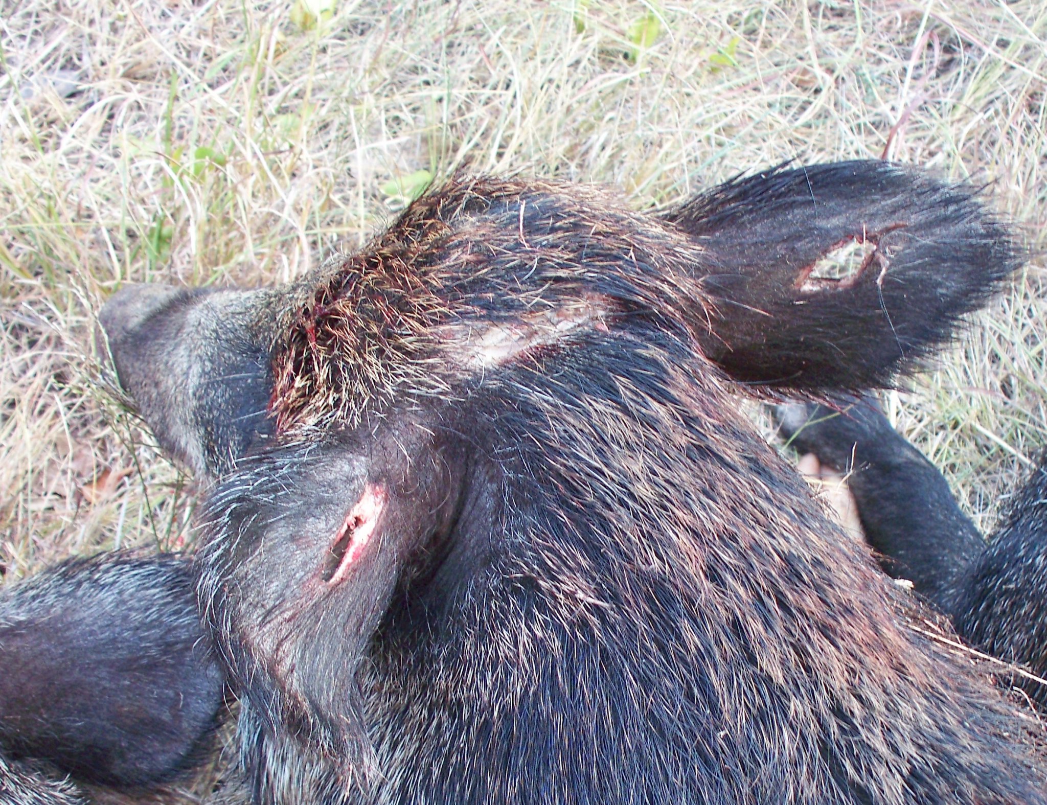

A buddy of mine was running a 200 yard zero and forgot to compensate for the difference when shooting at 85 yards or so. His opening was supposed to be a head shot below the ear. He managed to kill the hog with a followup, however. Afterwards, he told me, "Well, I didn't miss. I hit it three times with my first shot."

My dad did that on a doe. Pierced both of her ears but didn’t get a follow up shot until the next morning when she came in.

Ground hog....150+yds.... 223Rem @ 30ft off the ground....It decided to come back out after the close shave.....well I adjusted the hold.

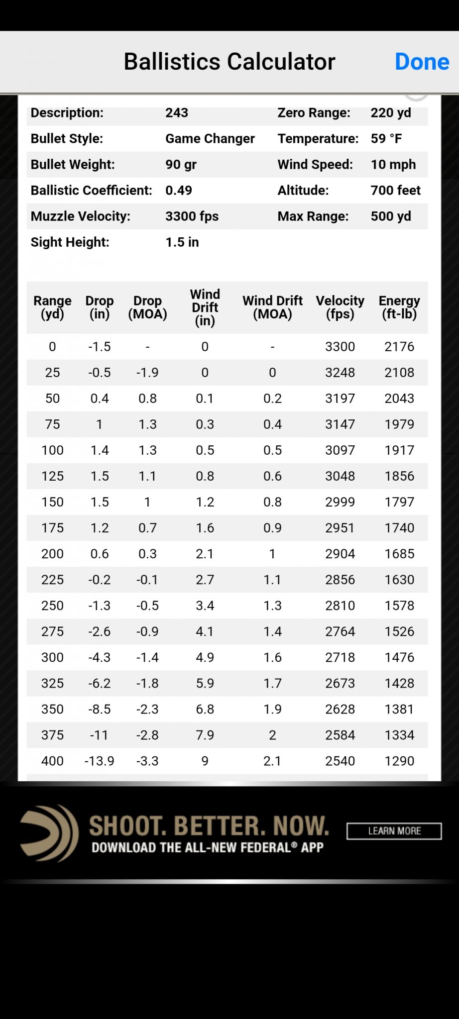

I site in at 200 yds. Will put you near dead on at 50 and about 1 1/2” high at 100. For your average deer caliber, this will give the best “dead hold” for 0-240 yds. I used to site in dead on at 100 years ago. Chuck Hawks has some good write-ups about the 200 yd zero
