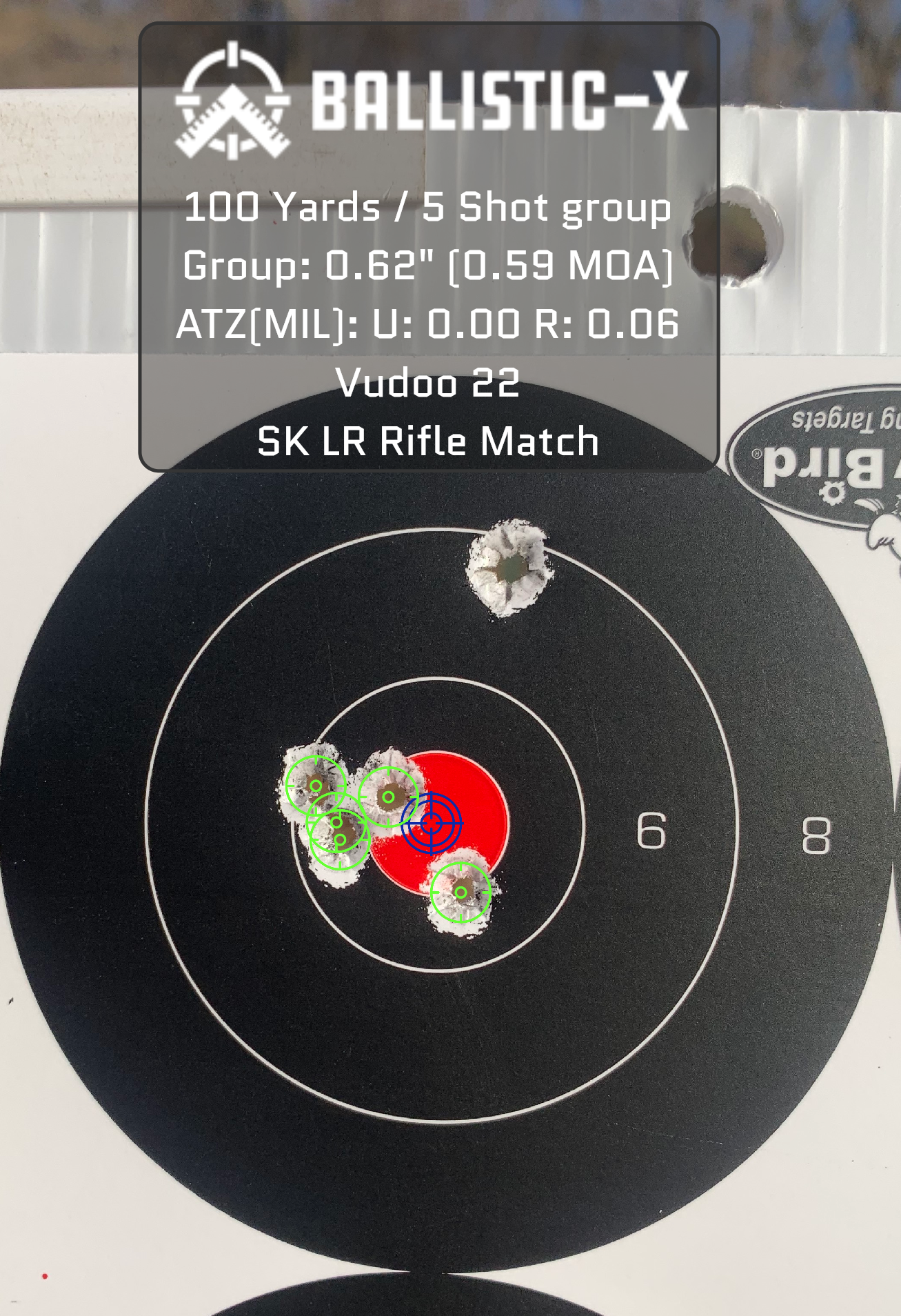

Out of my Vudoo with 22” MTU barrel:
My Long Range Rifle Match is in a black box with gold lettering. It shoots very well in my rifle (At least out to 320yds), even tho I am not the best shot. Here is my LR Rifle Match, 5 shots with a cold clean bore shot

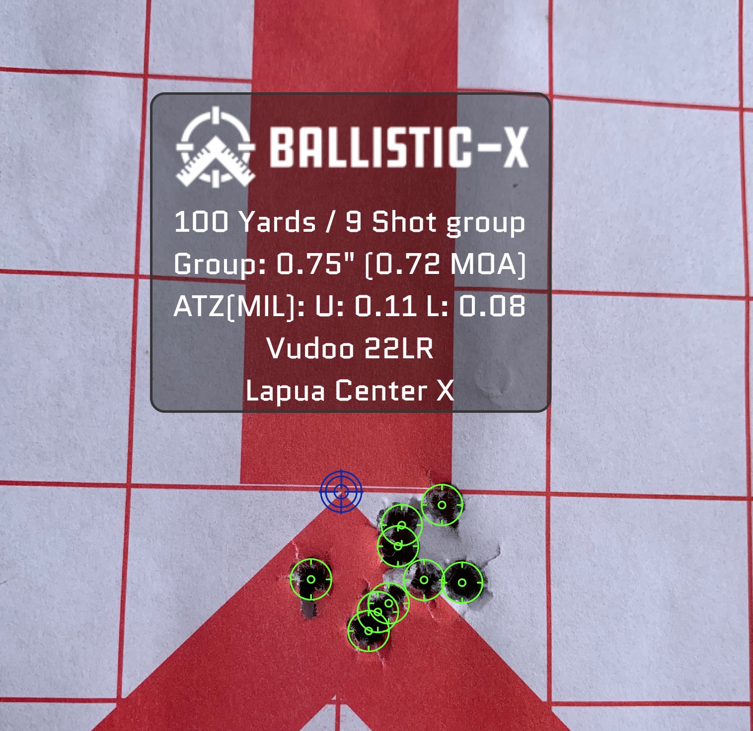

This is Center X with the clean cold bore shot removed (I have shot it out to 275yds):
The Rifle Match (Black w/red lettering) shoots the same in my rifle as the LR Match.

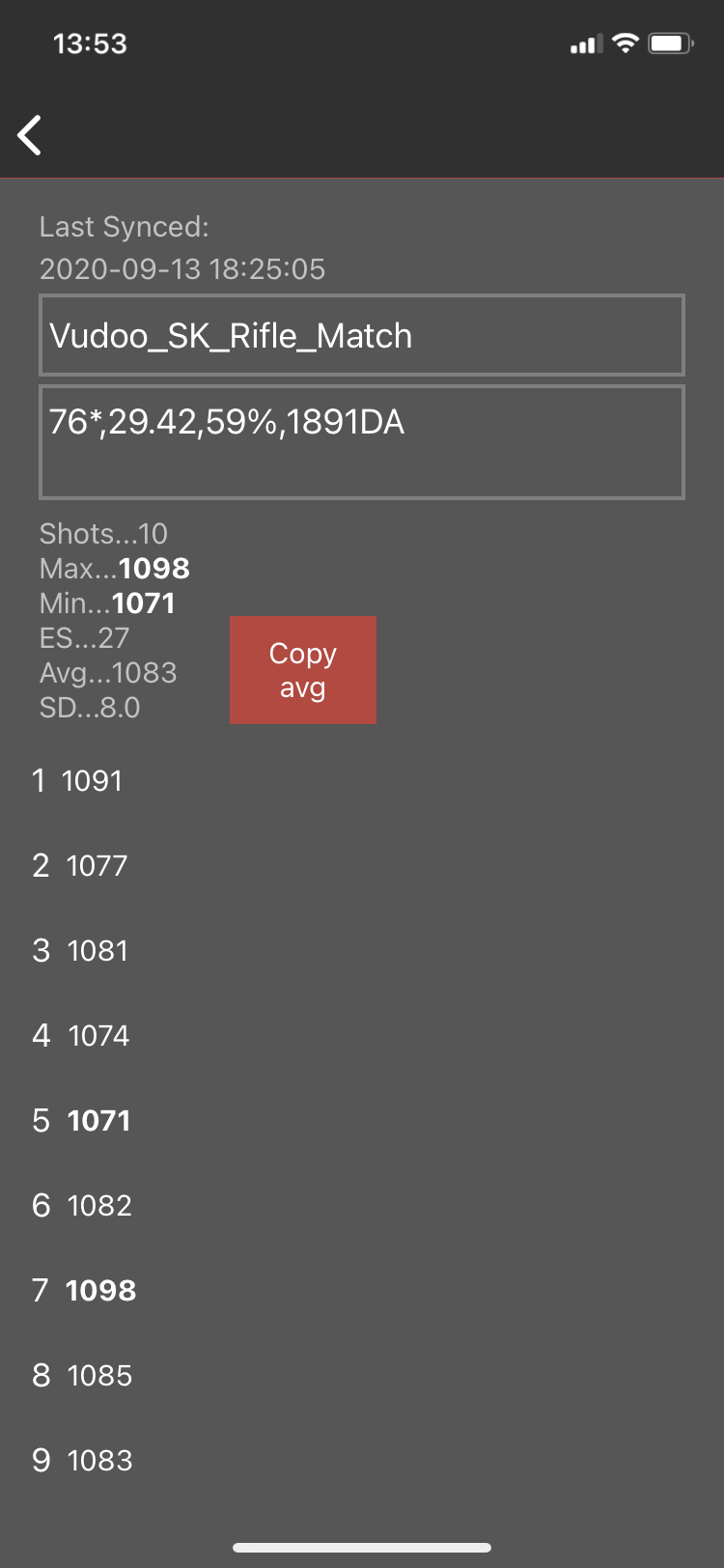

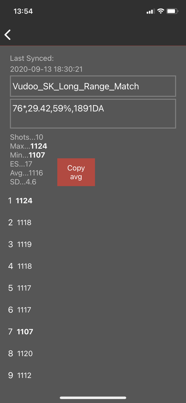

yea here at altitude of 5400’ I’m usually getting 1.6-1.7 MIL at 100yd with center-x which typically chronos around 1100-1110 FPS for me. The 1073 number for the slower SK products almost matches what I get when I chrono it with an average of 1068 FPS through a vudoo 18” and a tikka 20”.

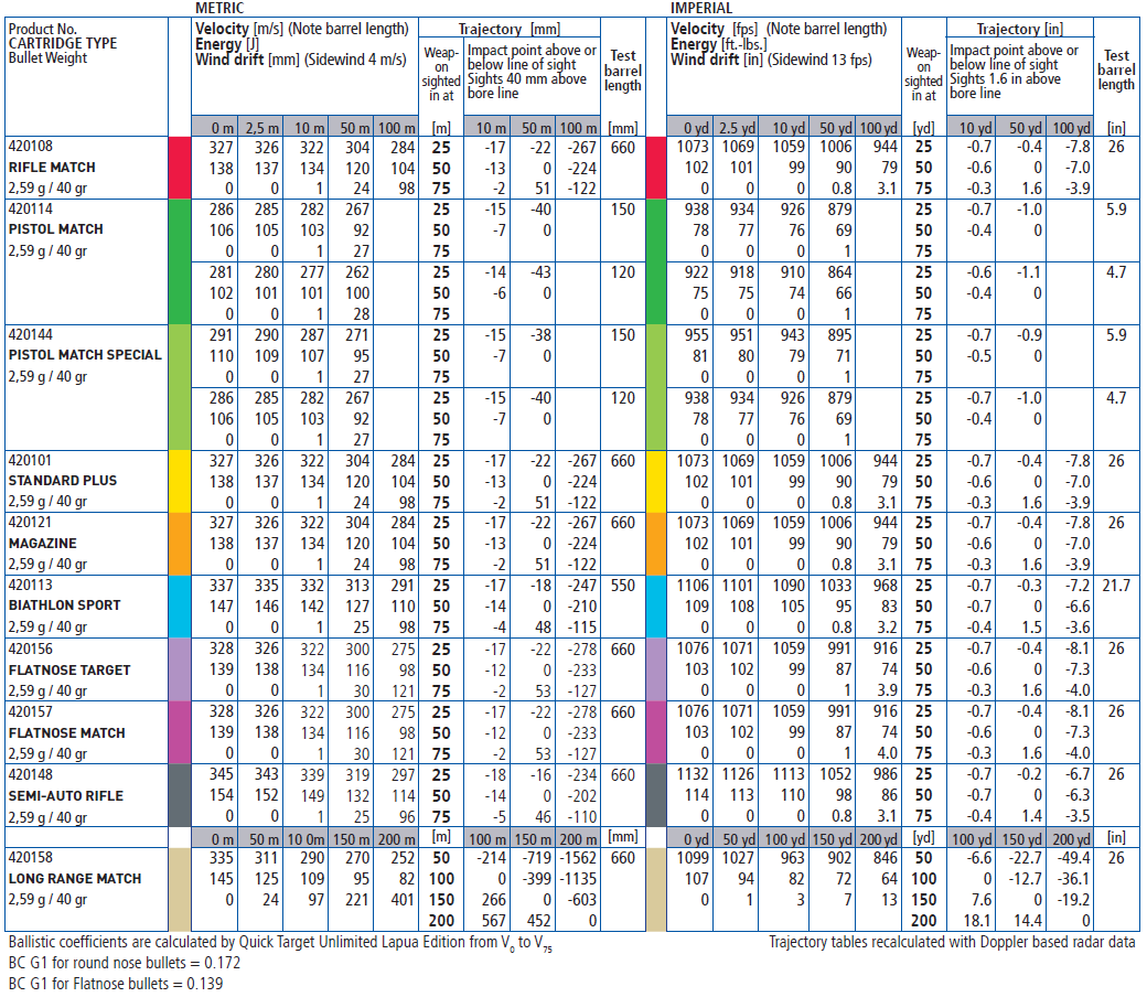

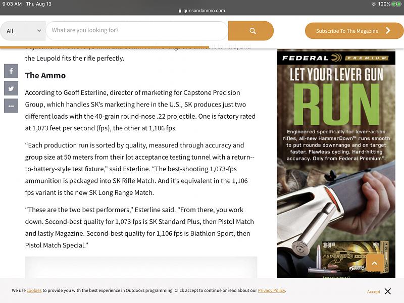

From SKs website and an unknown magazine article I don’t know to credit. EDIT ADD: magazine article is g&a.com
View attachment 7486177View attachment 7486178
So SK has 2 batch runs - 1073 and 1106 fps.
1073 goes from Red -> Yellow -> Pistol Match -> Magazine
1106 goes from Long Range match -> Biathlon Sport -> Pistol Match Special

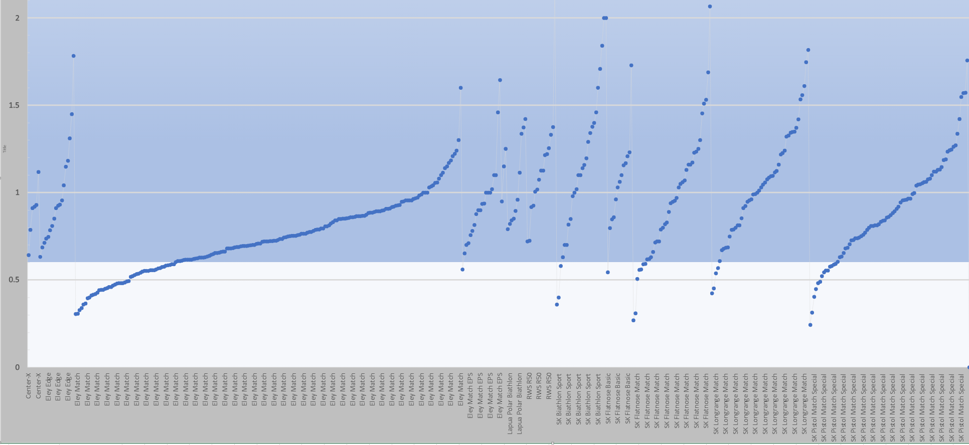

From my experience I can tell that either due to some process failure or just a regular fimfire quirk, their test bench cannot really determine lots from best to worst. It may have some correlation, but in my testings I have not noticed this AT ALL.
I have ditched last 3 or 4 SK Long Range lots and bought all of the Pistol Match Special as it shoots nearly as good as Tenex. Tested another lot as good also but had to save some money for a new project.
