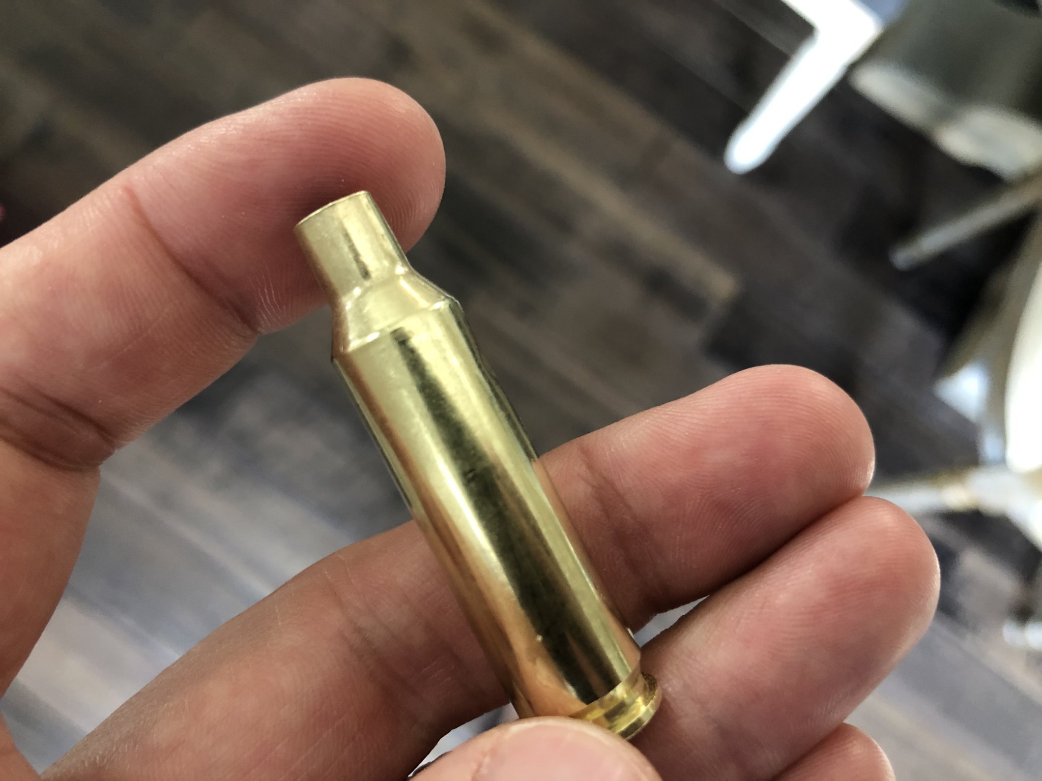

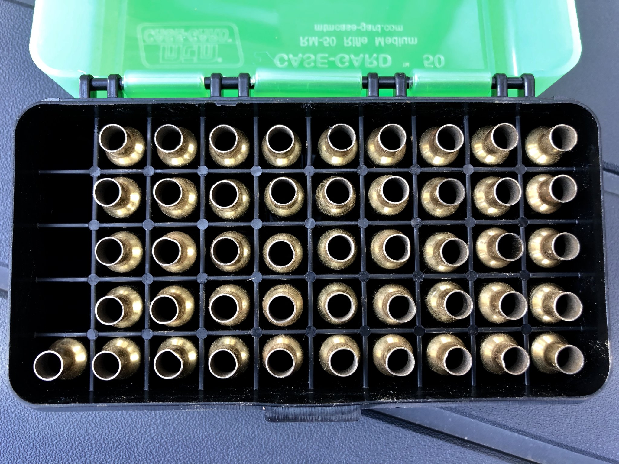

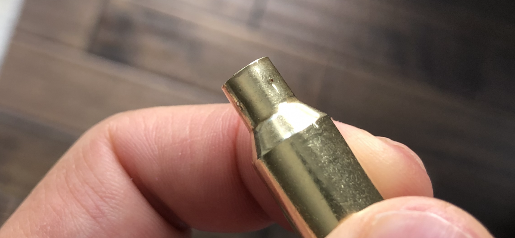

Hey guys,
I have some 6.5cm Hornady brass used to break in my Stag10. While adjusting my gas block I chew up some of the brass a little bit.
These are the photos of the worst of it. I’m wondering (as a new reloader) when is a dent too bad to reload?
There are also some “scratches” on the neck of all rounds fired, as seen in photo.
Could I, SHOULD I reload this brass?

Any body dent that has sharp creases to it is an immediate reject. The concern there is that the brass has been plastically deformed in the crease and will rupture/crack after a few firings. But that's an extreme case.
Smooth, shallow dents like yours will iron out just fine as soon as you pull the trigger.
-----^ my brain meant to say this, but I'm far less eloquent than this guy.
