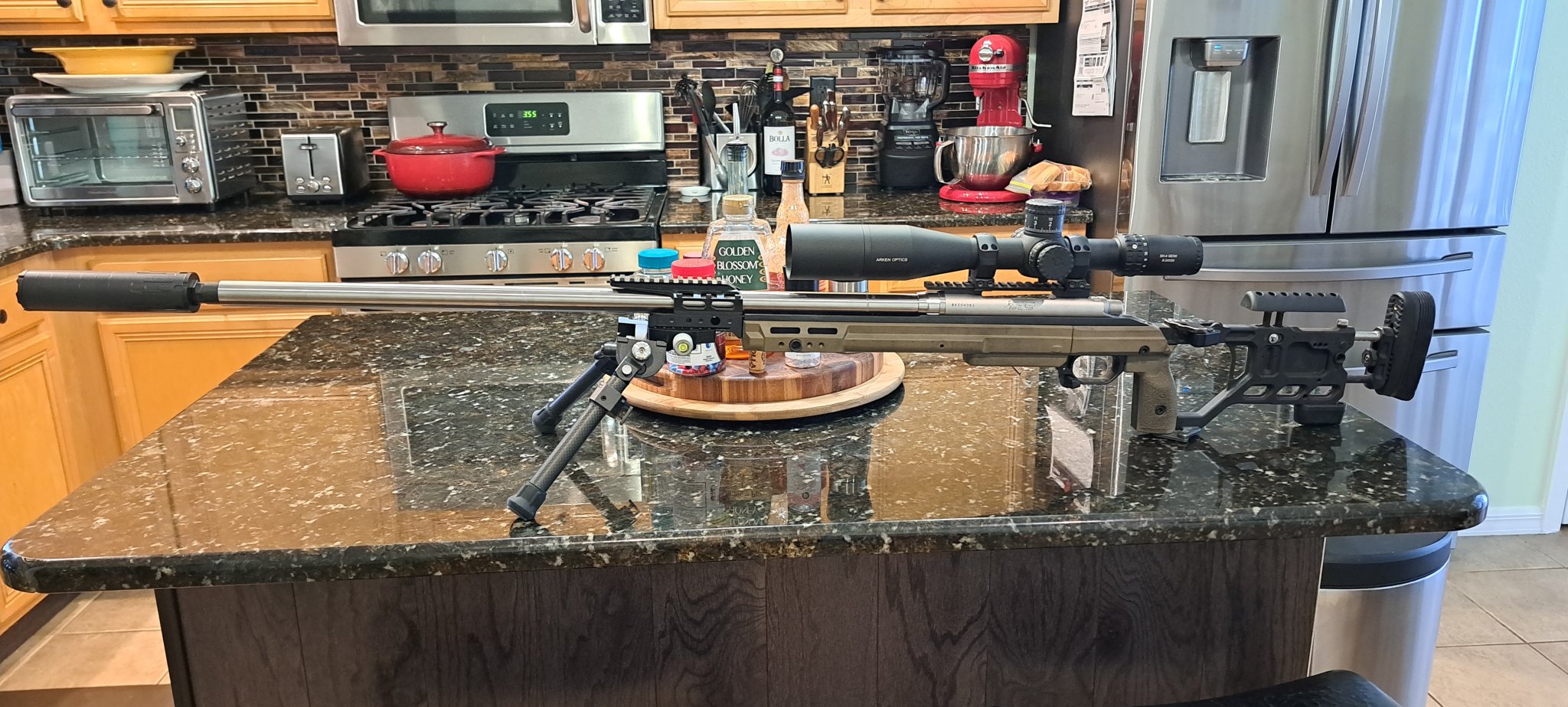

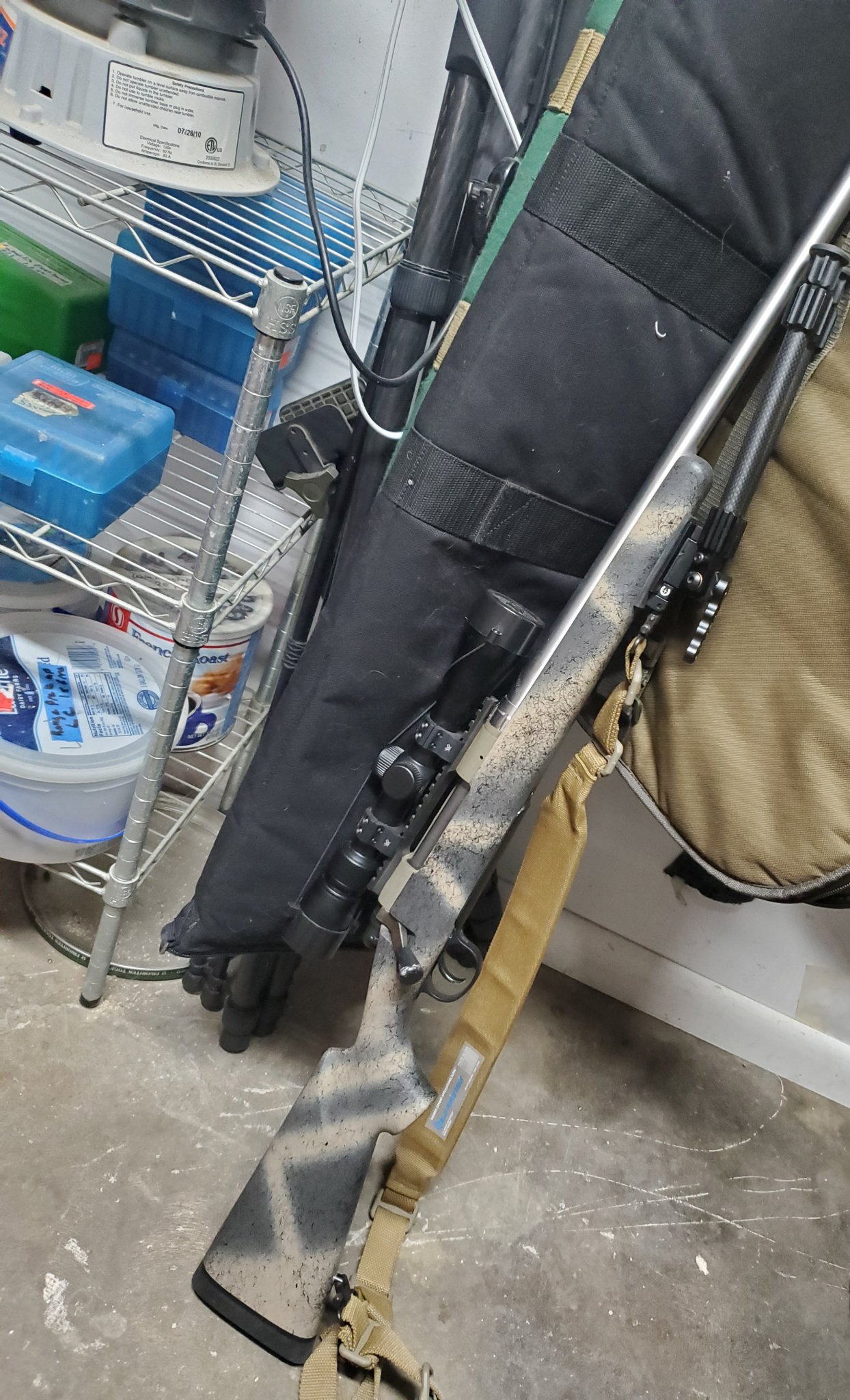

Got it all back together without breaking anything.
New recoil lug, barrel nut, 8tw Criterion 300 WindBag match bull contour and a new Lahar 30 to cover the end of the barrel.
Had to buy a step down adapter because the barrel has 3/4×28 threads. Silencer shop had it in stock and it also arrived today.
Gonna start with Berger 185s and 210s.

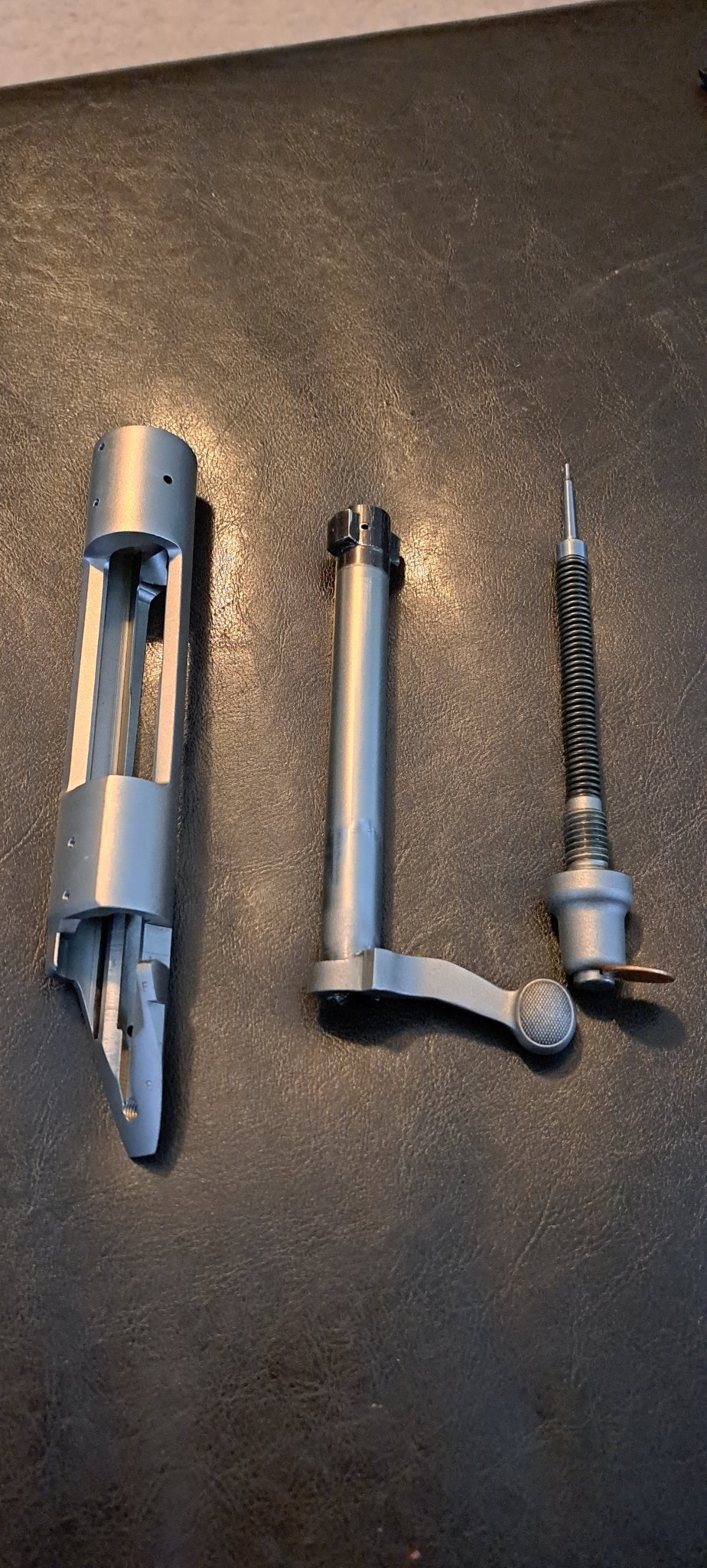

This rifle started life as a 1st production run 700 Stainless mountain rifle in 7 Mag.
My dad bought it the day it hit the store. It was an absolute hammer with 140 Noslers and Sierra.
The barrel is real tired and the velocity just keeps dropping.
It would have remained a 7 Mag, but Northland only had 26" barrels in stock.
I wanted a 28-32" barrel.
Since I already had a bunch of 300 Win laying around, it was a no brainer to grab the 30" 8tw 300 With the .160 longer freebore.

Can't believe you've put that much into it and have a Arken SH4 on it, blurriest scope I own (have one on a AR308).
Recently bought a Zeiss 4-16x44 conquest v4 and I am seriously floored by the clarity, it's the equal in every way of my Swarovski professional hunter that until now has been the best I have ever looked thru.......maybe I just got a lucky one? who knows.
BTW, TIG that bolt handle to the bolt, if you don't, it WILL come loose at the worst possible time.
Don't use any filler rod, just fusion weld it, works a treat......if I remember right, about 18VDC and 40 amps.....could be wrong there since it's been a few years since I did one.
Another thing, take a flashlight and look up inside bolt body, never seen one that didn't have *some* chips and shit in it.....and it's a place people rarely look for that.

That Arken has been on a bunch of different rifles. It tracks as well as any other scope I've seen or used.
Clarity? Meh, it ain't the best, but I have no issues spotting shots at a mile with it. I have better scopes, but the rifle will get tested with this optic.
The rifle will never be hunted with in its current configuration. No need for a hunting scope to sit on top.
The bolt body was cleaned out the day the rifle was brought home. It got a good cleaning and trigger adjustment at the same time.
The rifle with the previous barrel never had issues. It's just worn to the point where my 7-08 has almost caught up to it, velocity-wise.

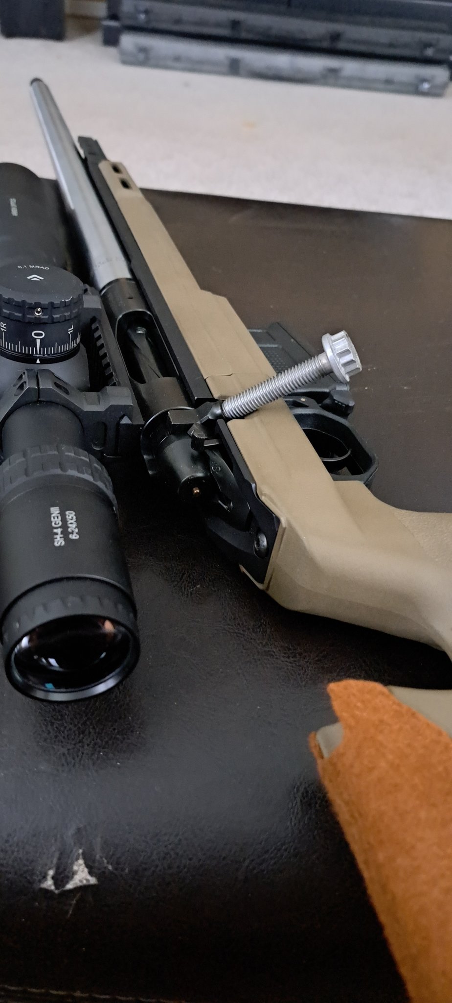

The "bolt" handle on the Origin action was an inside joke for a couple of shooting buddies. It spent enough time on there to snap a quick photo, then it came off.
That's the fancy bolt knob. You've got 12 point flange bolt money.
Meh, should have gone for a triple-square bolt head for maximum flex. Sure it doesn't have the tactile feedback and grip of the 12 point flange, but it's one of those "flexing on the poors vs function" things.
By the by, I'm something of a gunsmith myself, I build high-end custom rifles. Like this:
View attachment 8448185View attachment 8448186

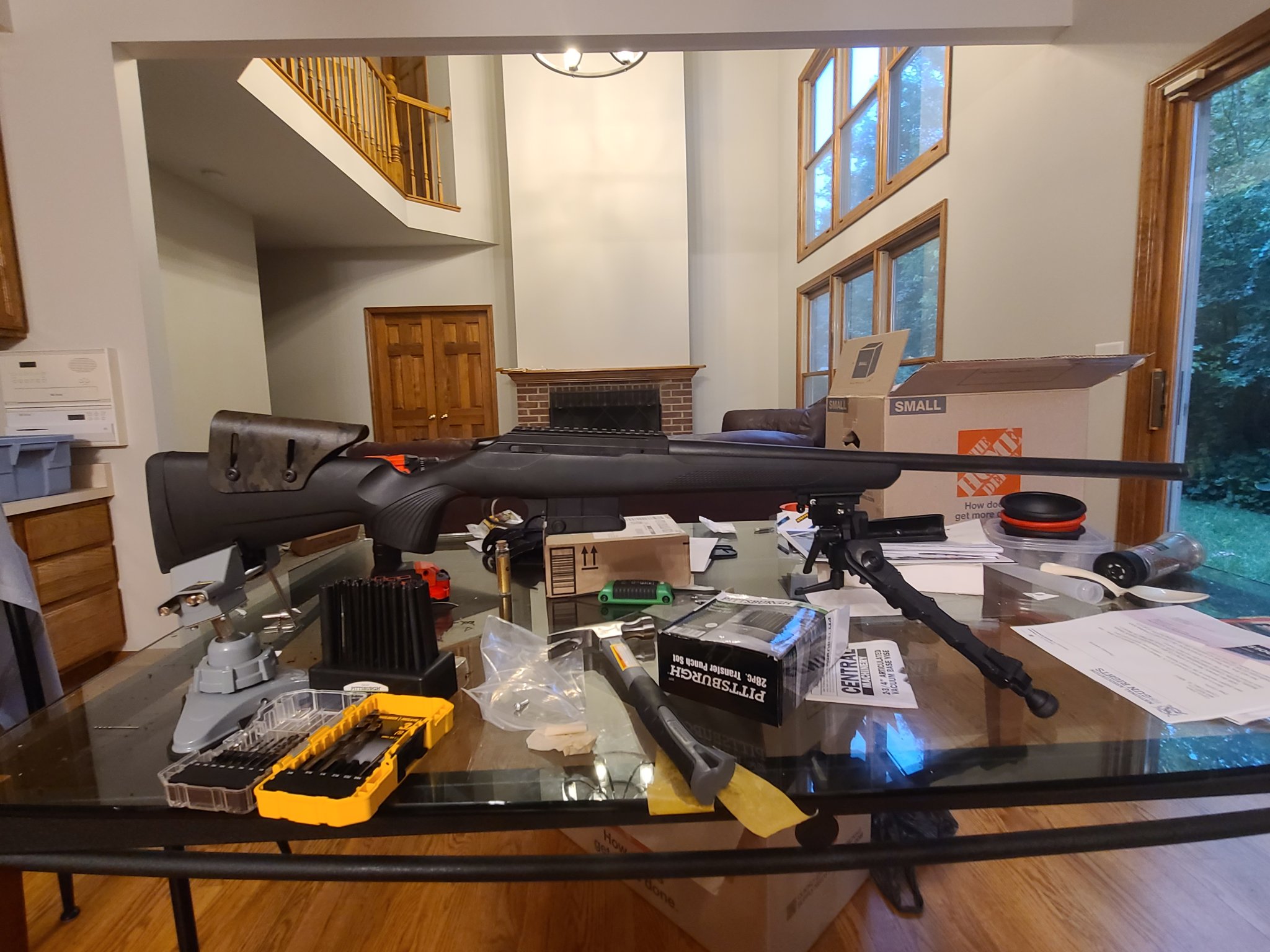

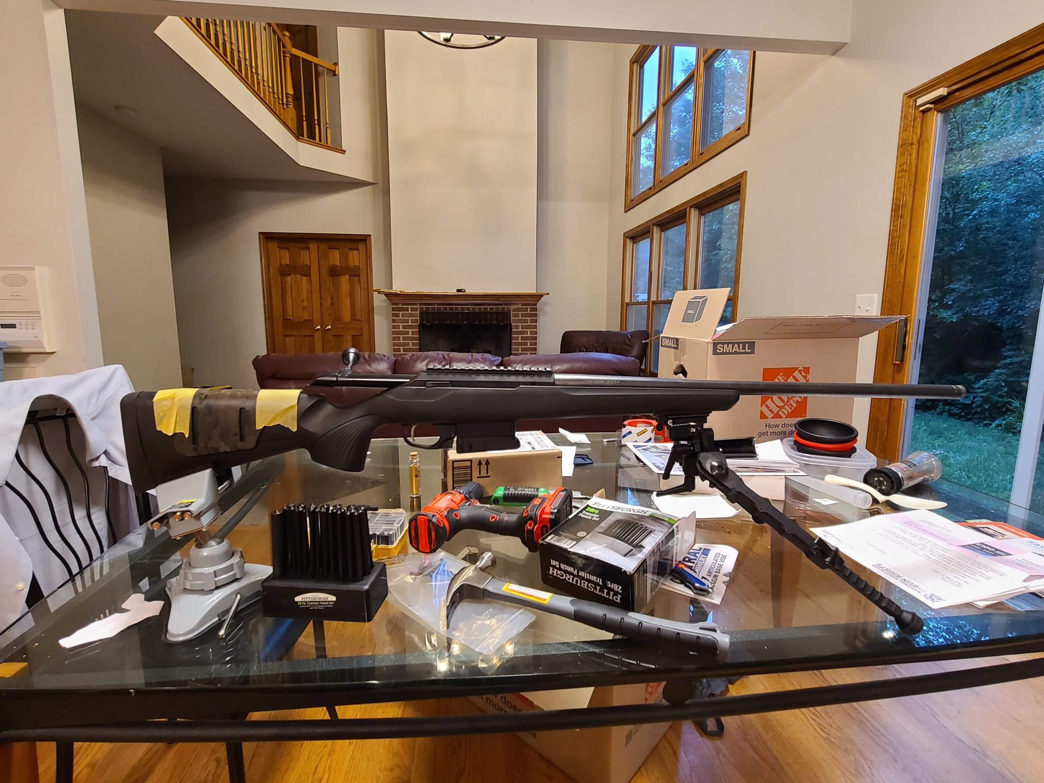

Hey it's a proper Tikka.
I thought it might be fun to start with a factory rifle and some bolt-ons, see what I can do with it and then upgrade it from there, or if I decide I need more, put together something on a custom action. The adjustable comb was an absolute must.
Now I'm waiting on an M-Brace to arrive, to hold the XTR IIIi.

What I was meaning is that the Remmy bolt handle is silver soldered to the bolt body from the factory and they tend to pull off at some point....needs a real welding job instead of solder.
Here's an older thread about it....
I'm fully aware of the Remington bolt issues.
I don't overload my ammunition. I've never beat on my bolt handles like uncle Sam teaches.
So far, in 40 years of using Remington rifles, I've never snapped a bolt handle loose from the bolt body.
Appreciate it though.

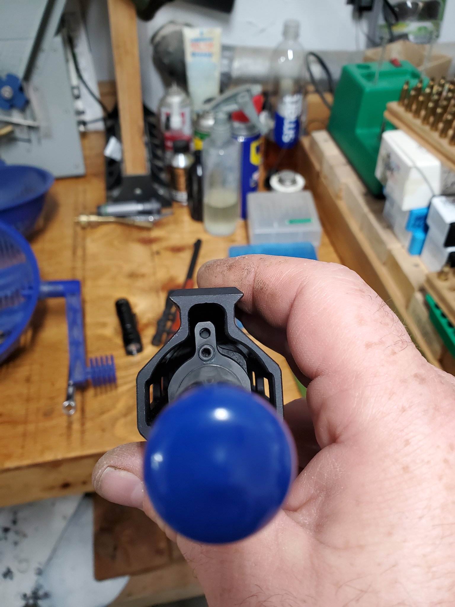

Somebody put your bolt handle on the wrong side.

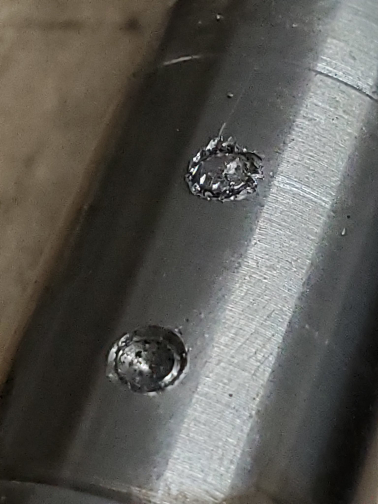

This new gas block didn't come with the tubie thing in it. Can I take this other one apart and get the tube? Does it screw out or something?
its held in with a little roll pin .it can be a bitch getting it in. come to think about it getting the tube out of the block was a challenge with one of the gas block's . i was whacking it rather hard to get it out of the gas block
Do you have to go all the way in from the back through the tube to make the pin roll? I have a long stick I might could reach in ther with. I don't see any pins that roll on this thing. 🤭
