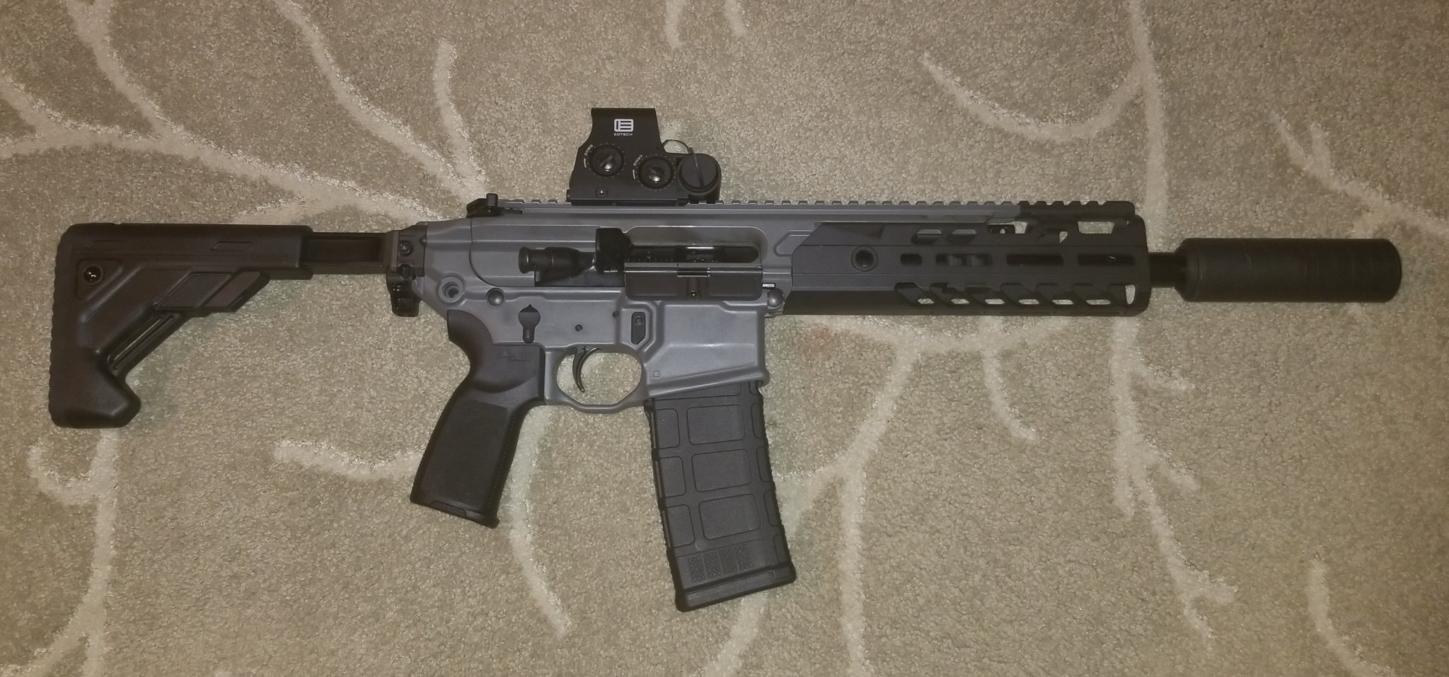

FFD1F067-C25A-4153-BE69-0AB045ADD9FF.jpegBB0862BE-3360-47AA-B702-940F1E8761FB.jpegDD9FF74D-22F5-4500-9E73-C488E262E15F.jpeg
Nice ... similar setup to mine, except I've NEVER been able to get the Silencerco Osprey to stop rotating after 20 or so rounds. Have you?
Ya I’ve never heard of an issue like that... Sorry to hear your having that problem I love the Osprey on this setup. Do you have the XL size piston so you can utilize all the threads and get it good’n tight?

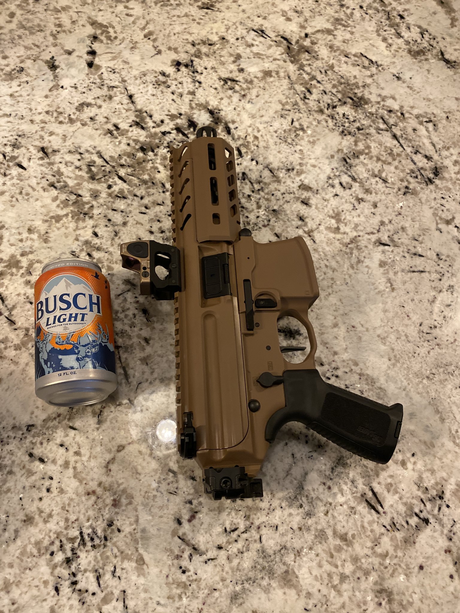

Hi guys, new to forum here. I purchased a Sig MCX Rattler last week and it was only the 5.56 version, I was really wanting the .300 BLK , but this was all I found locally and after looking online as well.
Anyone have any ideas where I can find then conversion kit for this 5.5” version? Is my best bet to just call Sig an back order? Also, someone in the thread mentioned barfcum, I couldn’t find a reference to that if someone can help me there.
There’s 1 kit on Gunbroker, but it’s for a 9” barrel and I have the 5.5 and would like to stay there.
Thanks
