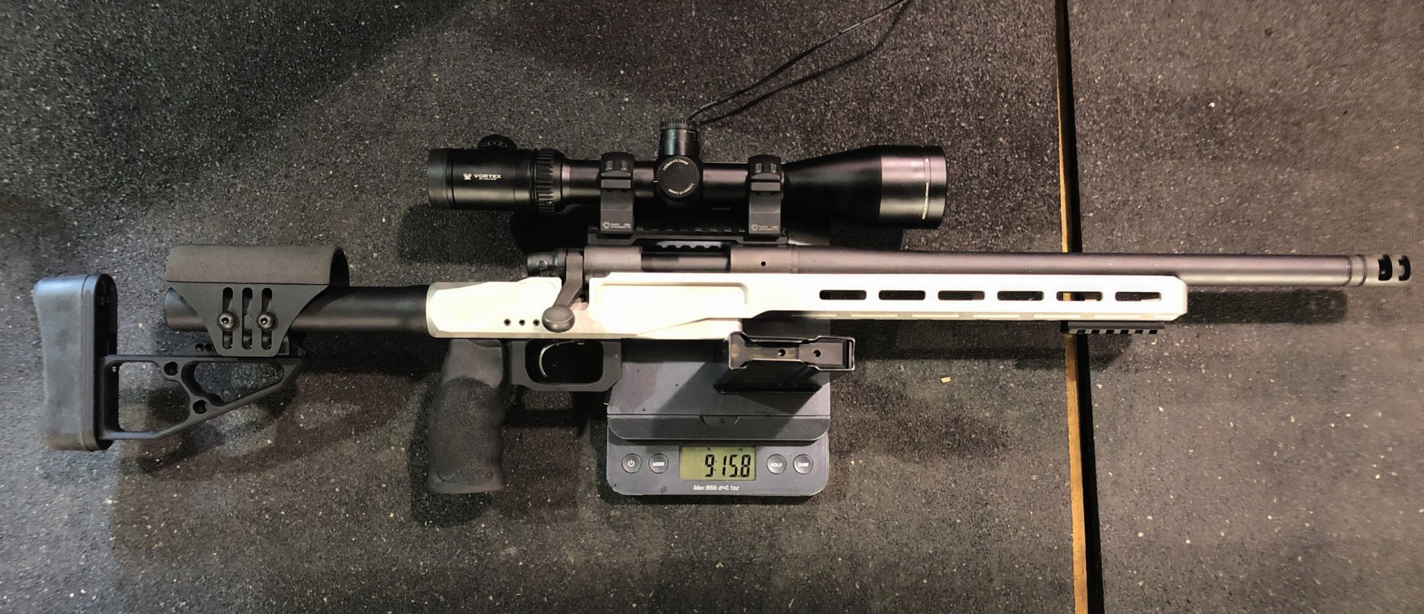

Just for fun, here is the new Magnesium Element 3.0 chassis with the aluminum buttstock ($745) with a factory Steel Remington 700 in 308, muzzle brake, scope rings, Vortex 4-16 PST, and AICS 10 round magazine under 10 lbs. Granted, this is only a 16.5" bull barrel but that is still quite decent considering its all-steel and the rings, and scope are not the lightest.

A precision rifle with scope under 6# is amazing. That's exactly what I'm talking about. The mammoth challenge is one thing, but I doubt I'll want a heavier rifle on hunting trips the older I get.
