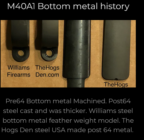

Guys,
Now that Williams is closed, where are you finding Post 64 steel bottom metal for your M40A1 builds? I already know to stay away from TMA.
John

So a few options. You could also try numrich gun parts and ebay.
I think the difference between The pre and post 64 bottom metal is metal thickness. So You could just build up the area during the bedding process.
Winchester Model 70 Floorplate and Triggerguard in Steel are what is correct. There is pre-64 and post-64 styling, post 64 being more A1 looking and the pre-64 having been used on some earlier stocks. Both of these can be found on eBay and then will need fit by a gunsmith. Pacific Tool and Gauge is offering A1 bottom metal ready to go and is certainly worth someone trying it out and letting everyone know.

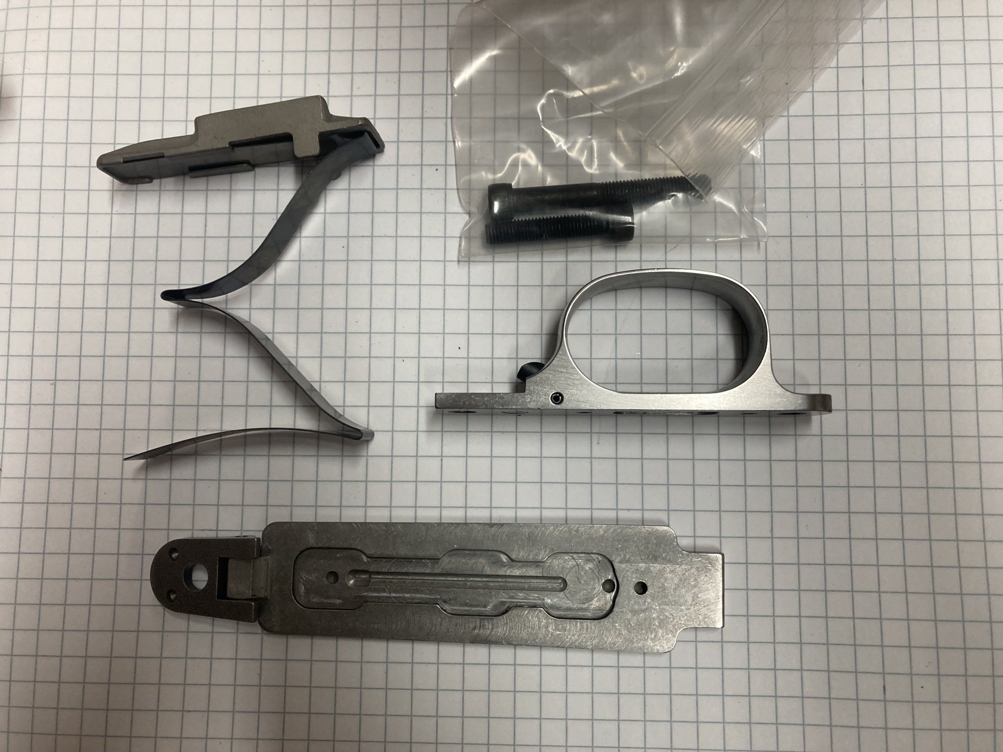

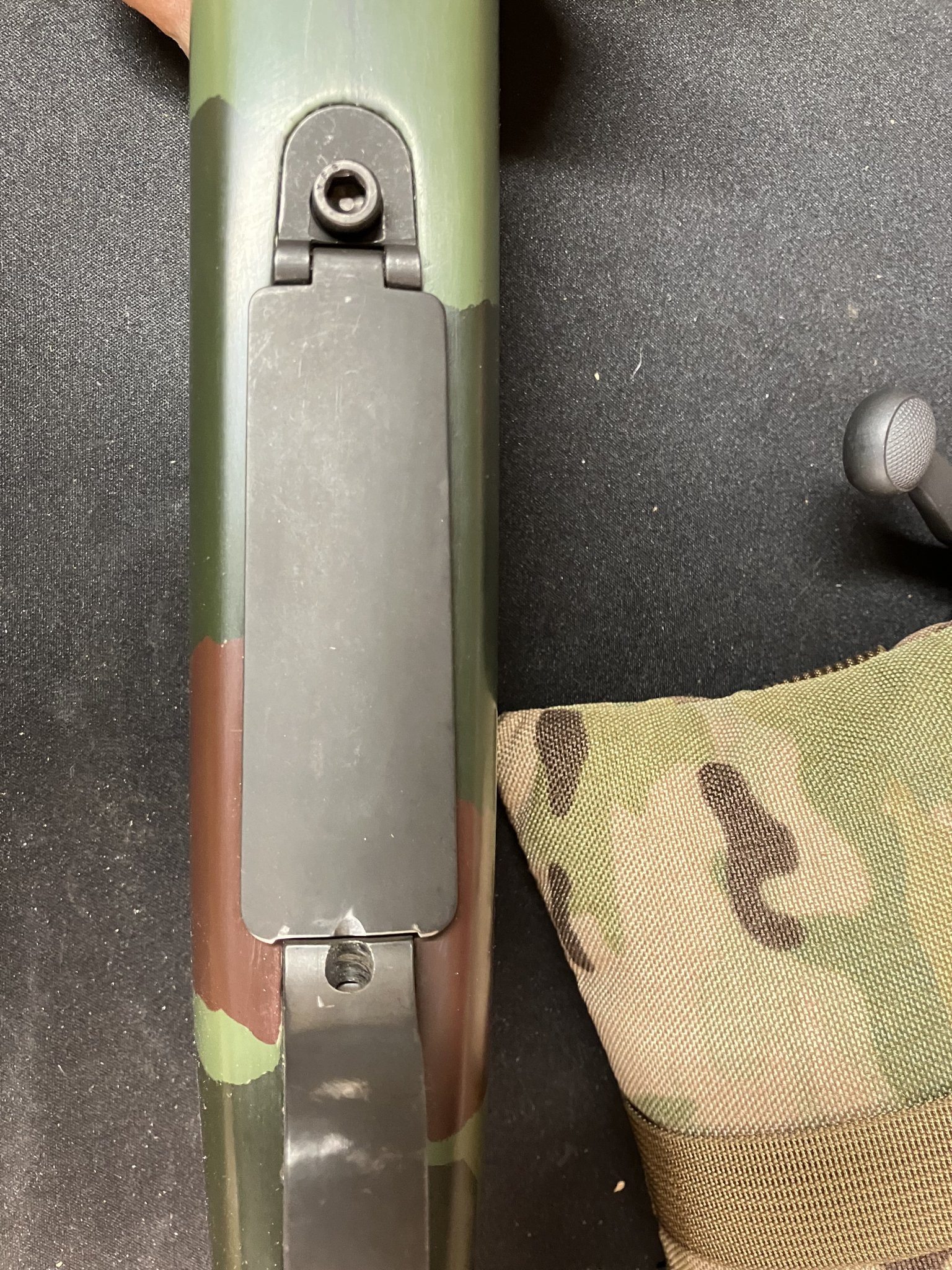

Being in the UK my options are limited around sourcing parts. I went with Pacific Tool & Gauge, ordered the bottom metals, mag boxes, springs, screw sets and follower.
I have just received the two limited edition Smear Stocks that I was able to purchase from a member on the Hide.
The attached photos show the PTG parts and they are a drop in fit on the new smear stock.
I presume the bottom metal should sit flush to the stock? If so, the front needs inletting slightly, otherwise an excellent fit.
Quality seems very good, as does the finish.
Shipping to the UK was trouble free and PTG are one of the few US retailers willing to ship parts to the UK.
All in all I am happy with quality and service.

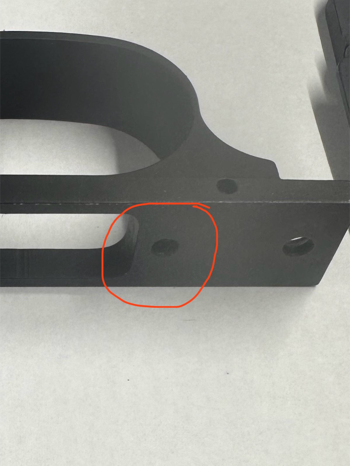

That floor plate is about 0.050" long, it is also missing the filed in notch for the retaining detent on the trigger guard.
That bottom metal was made by scanning a model 70 bottom metal that I modded to A1 specs. The final "perfect" length of the floor plate is to be done after bedding and then the notch filed in.
thanks for that.
So are you saying there should be a gap between the floor plate and the stock? Only the gap is widest at the front, hence I thought it needed inletting at the front.
Sorry, I wasn't very clear. It does need to be deepened some in the front. I was just letting you know the plate itself is long and missing the notch where the detent int he trigger guard goes. There needs to be a very slight gap between the plate and the trigger guard when closed for the plate to close correctly. That will need to be cut to length still. They are basically modded up the point of installing and final fitting per the build procedures for the A1, it is not a finalized drop in part.

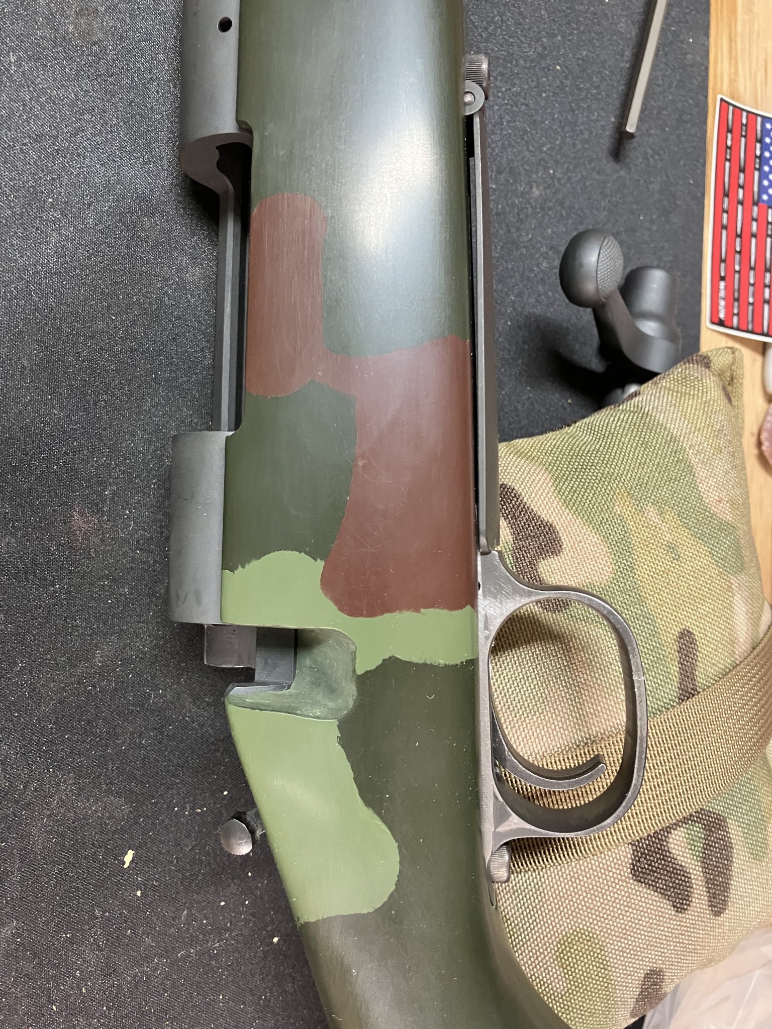

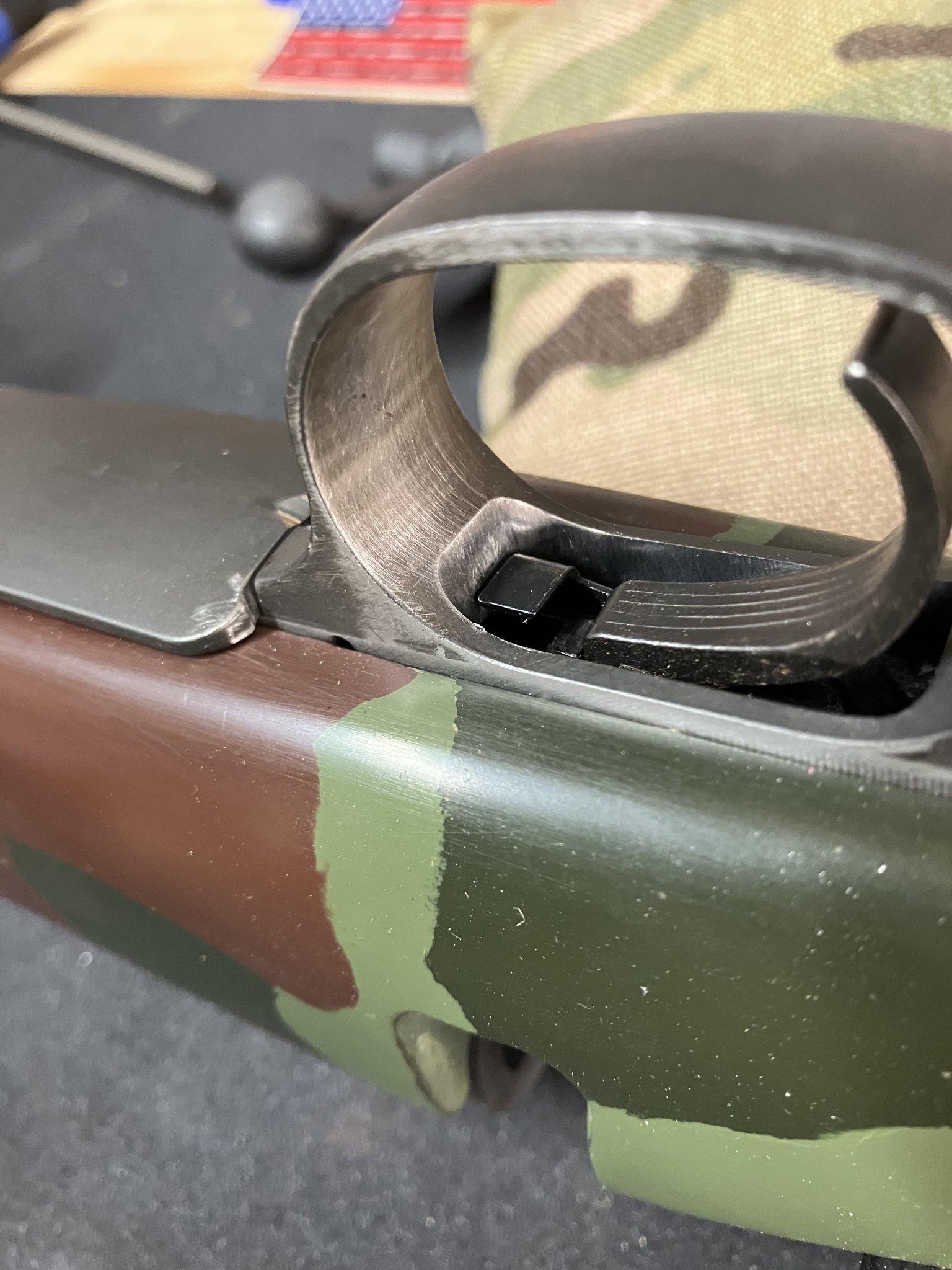

Decided to work on my bottom medal for Memorial Day. I didn’t have EOD 100’s luck with PTG’s M40a1 bottom medal. The floor plate was too long and the cutout for the trigger guard compressed the bolt stop release. Unfortunately the guide hole for the plunger was too close to the inner edge. I ended up having to weld it to add material to the plunger hole cut so I could relieve the trigger guard opening enough to fit.
I used EOD ‘s pic of the plunger guide hole since I didn’t take a pic before cutting. Mine was only .050” from the edge.

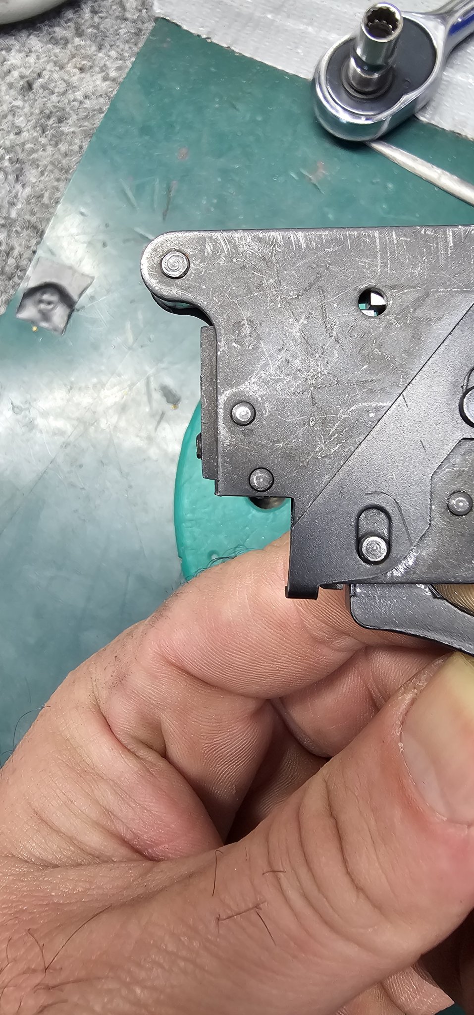

That bottom metal was made for clones, so the rem 700 trigger won't fit without modification to the housing and bolt release like the originals had. It is also intentionally slightly long on the floor plate and should be cut to exact fit after bedding, just make the back of the plate flat along the whole way vs the middle cut to length for a more clone correct look if going for that.
