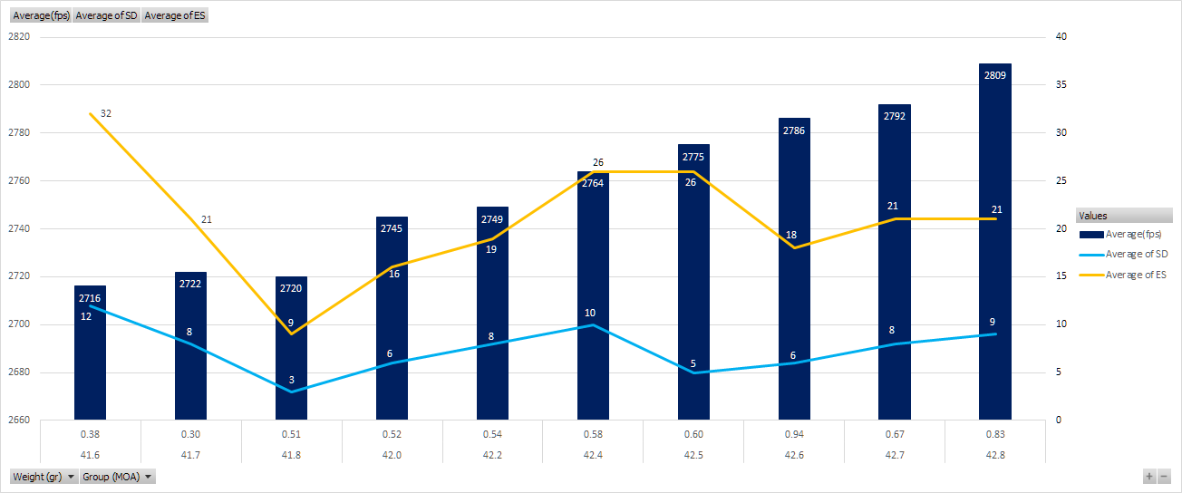

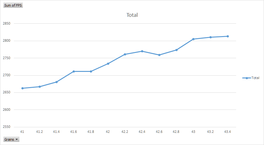

I just got access to a range (two hours away) that extends to 1,000 yards + purchased a range finder. Should I load up five-shot groups at 42.0-43.4 and go shoot at say 300 or 600 yards? Or should I run to a local range and shoot groups at 100 yards? Or should I run a seating depth test at 600 yards? This new range opens up a new world of load development for me. Typically, I just do load development at 100 yards.
Below is a pressure test I ran on a fresh barrel and fresh brass.
Until you've got your 100-yard reference load ... distance shooting shouldn't be the priority IMHO. The high node (43.3-ish) is interesting, but that's some damn high velocity for 6.5-CM. Are you seeing pressure signs like cratered primers or a heavy bolt at that speed? I'd be loading for group testing at around 41.7 and see if you get tight groups and low SD's just above 2700 fps ... but that's just me. Over 2800 is really hot for 6.5-CM ... at least so far as I've discovered in my Tikka T3x TAC A1. My reference load there is 43.4gr of Winchester StaBall for around 2660 average fps ... and SD's of 5.5. That said ... wherever you want to shoot ... JUST DO IT !!!

At Which charge weight did you see your first signs of pressure, if any? What brass are you using?
Yeah, maybe I will start at 41.6 as my barrel should speed up.
Peterson, 43.0-43.4 were just slight ejector marks. I likely wouldn't run a load above 43.0.
How long is the barrel?
26"

Gotcha. I’d run an OCW at 100 yards topping out at something like 42.7 with the expectation you would see a stability node somewhere between 41.2-42.5 grains.

5 shot groups at 100 yards.
Rifle definitely shoots better than me; no reason all groups can't be smaller than 0.5 MOA. I'll probably load up 41.7 and 42.1 and go shoot at distance. Might even do a seating depth test on both of those loads but I feel pretty dialed in (with any load I use, to be honest).
This was with factory brass. Once I bump the shoulder 0.002", continue to fireform, and seat with a CPS I am sure I can reduce my SD/ES.

Nice graphic, looks like you’re getting there.
Controlling seating pressure consistency and inner neck diameter (and to an extent, interference fit) is the way to reduce SD/ES
