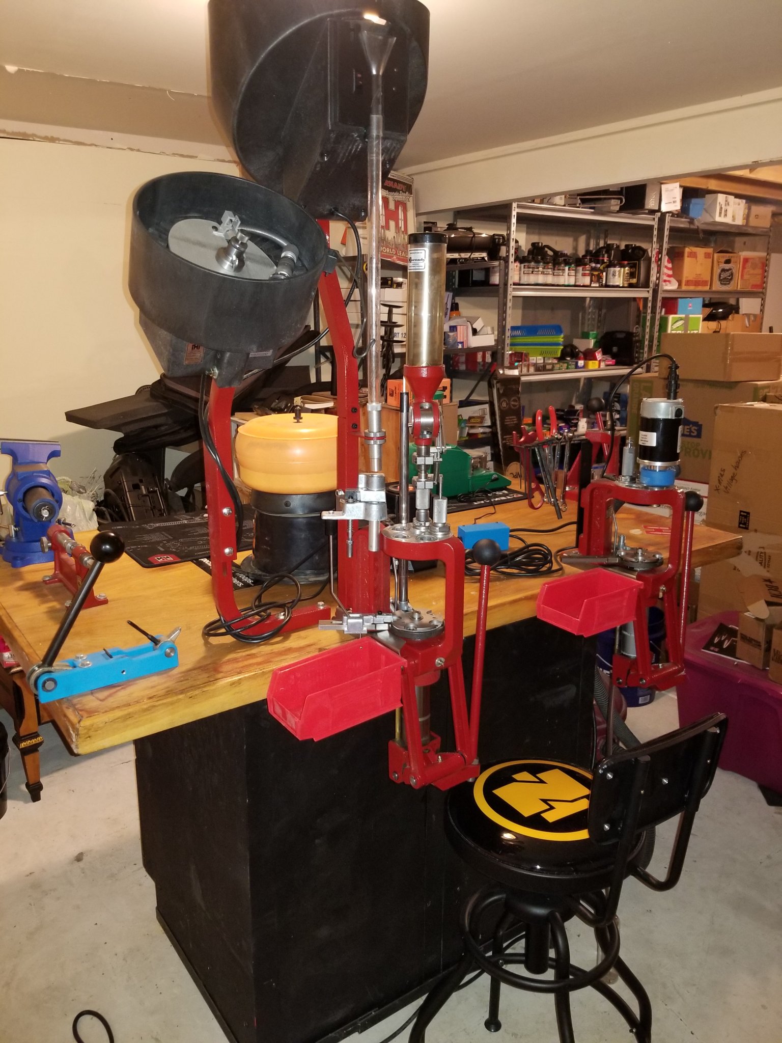

My setup is similar:

It’s lagged to a 2x4 screwed to the wall studs with 3” sinkers. The casters are locked on 1/4” plate. The bench is solid. Before I did that it was shaky at best.

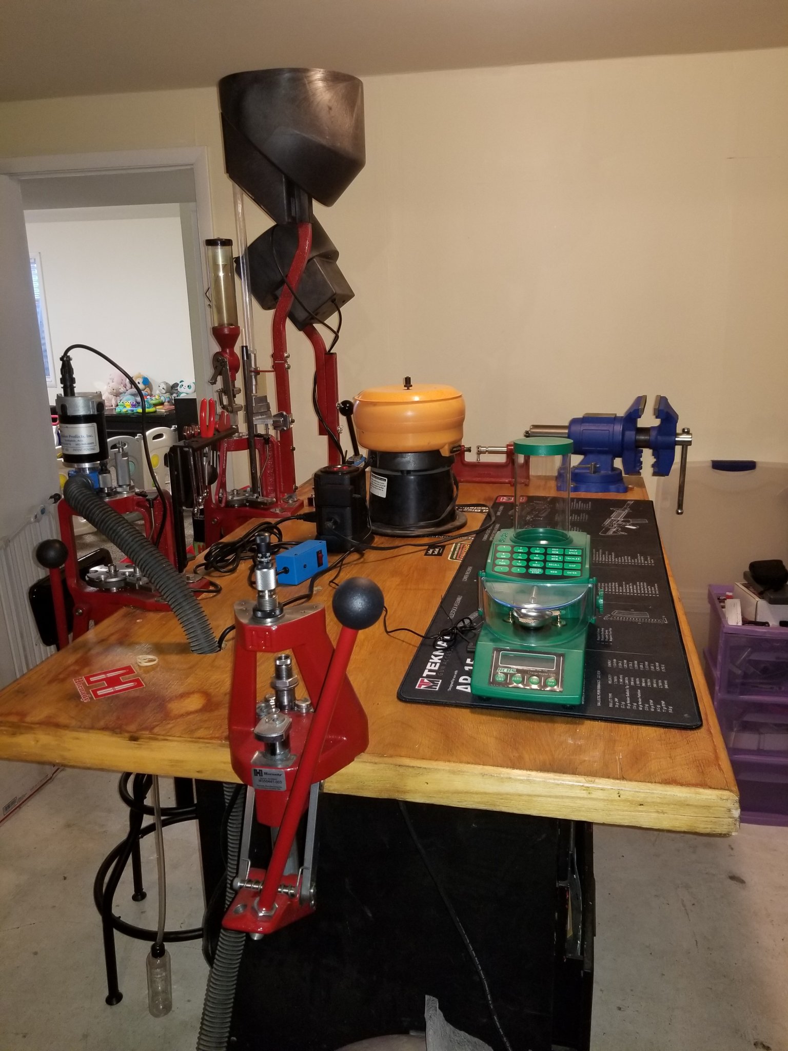

I mounted an old table top on top of a tool box kind of like yours. I can spread the presses out further and spin it around to use the sides for case prep, cleaning, etc. Gives you quite a bit more room to work.
