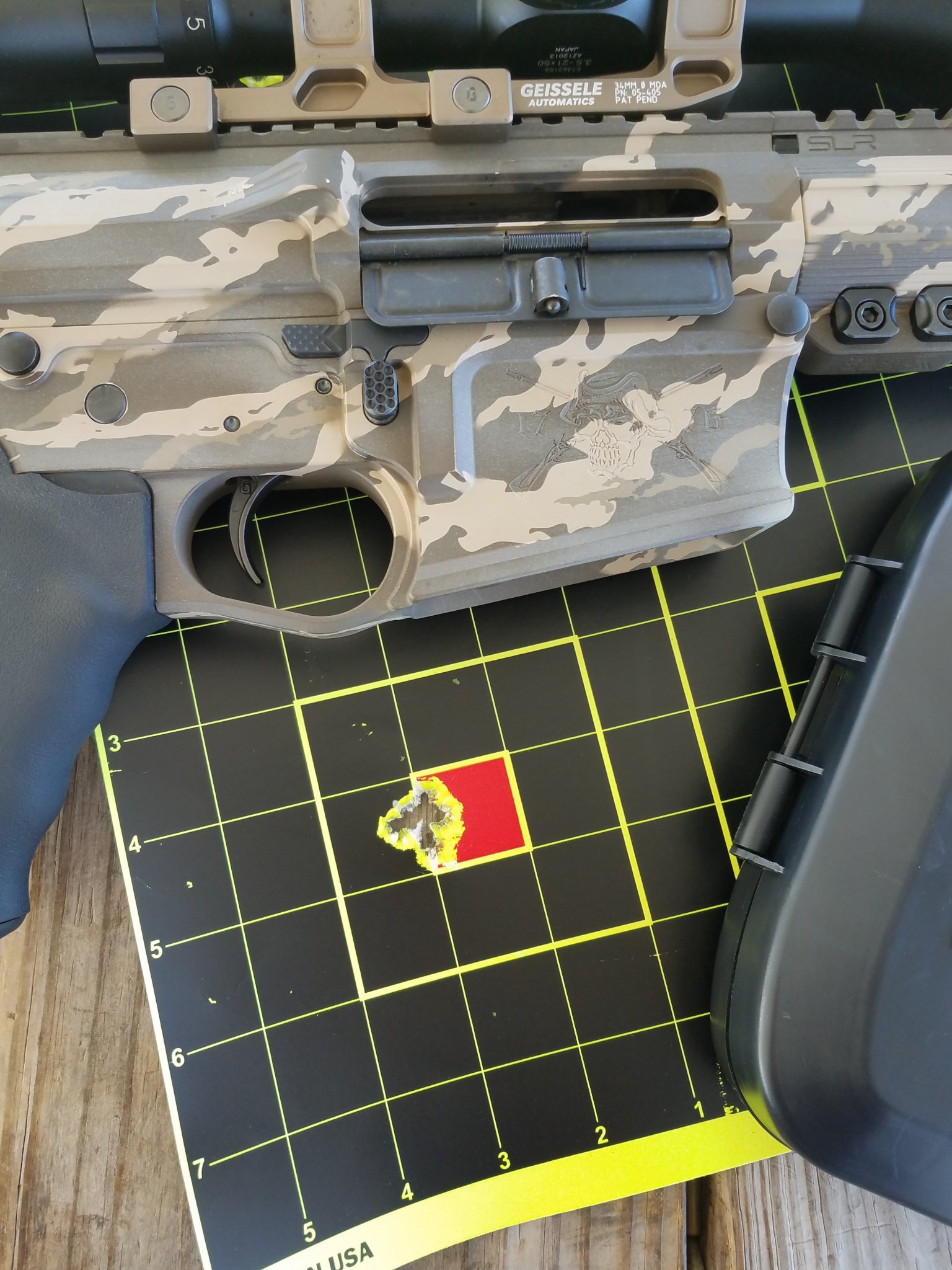

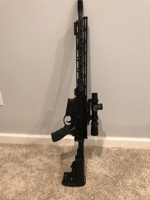

my recent, and long gestating build:
2A upper & lower
Geissele trigger (can't remember if it's a SSA or SSA-E)
JL Billet handguard
Ranier Ultramatch 16"
EFAB Hybrind muzzle break
VLTOR extension/emod/buffer
Troy ambi mag releases
seekins ambi safety & bolt release
Geissele 0moa rail & Nightforce NX8
(I can't remember where the LPK was sourced, or the gas block/tube, probably Brownells or Ranier)
Ergo grip
9.25 pounds with optic & mount w/o any accessories & mag.
I believe I could shave another half to three-quarters pound with a CF wrapped barrel and low mass BCG
more weight could be saved by going with a red dot, I think a Aimpoint Micro in a Scalarworks is something like 5 oz - that alone would shave a full pound off my build.

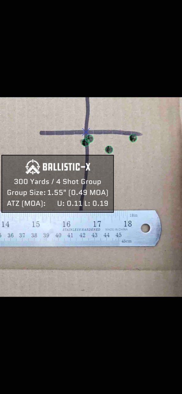

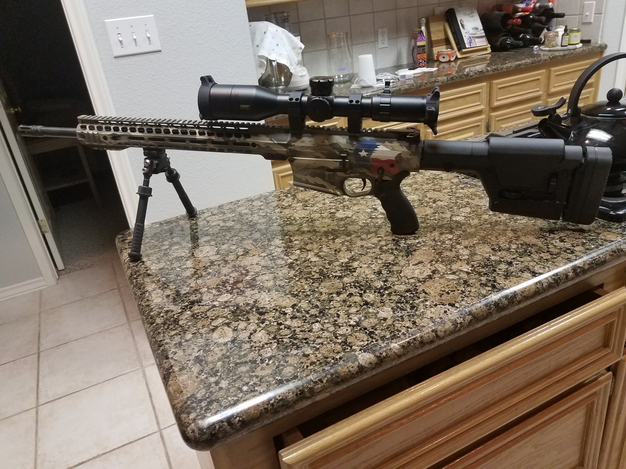

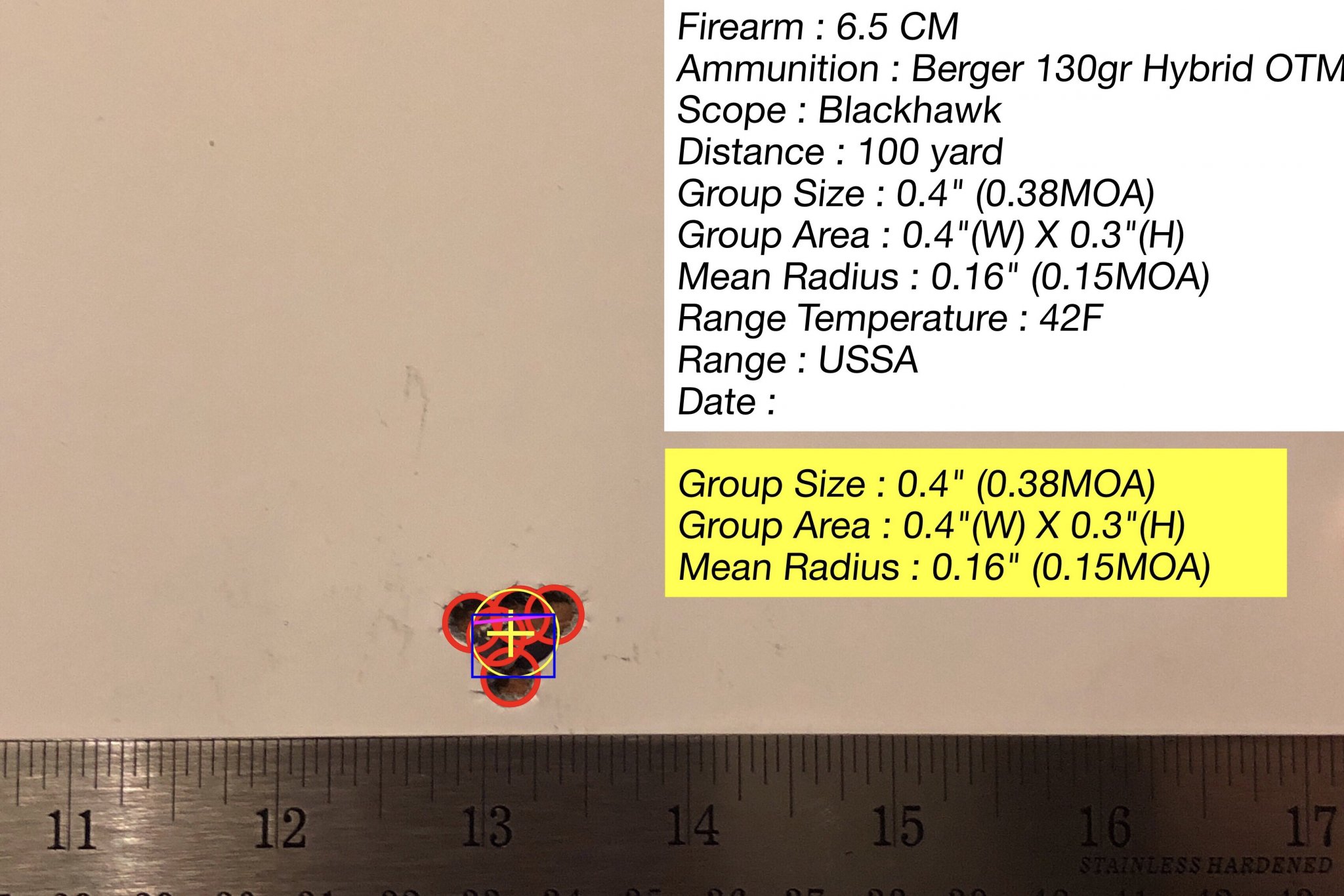

I’ve recently completed my large frame build in 6.5 Creedmoor. Pleasantly surprised with the performance. My rifle comes in at a little over 14 pounds (haven’t weighed it since I’ve mounted the new optic). Here’s what I’m running, as well as some load data I’ve developed.
M5E1 upper and lower from Areo Precision
18” Ballistic advantage barrel
SLR 15” MLOK handgaurd
SLR adjustable gas block
Stock nickel boron Aero BCG with the JP high pressure bolt and firing pin (must have for 6.5 CM builds imo)
Luth Ar fixed stock
Athlon Ares ETR.
Right at $3k with optic. I’m currently shooting the Berger 130gr Ar Hybrid over 38.6gr of Varget, seated at around 2.800 for a 90thou jump. This gives me 2715fps. Currently running lrp brass but plan on switching to srp brass now that I’ve got the hp bolt. I was seeing a lot of primer flow and pierced primers from the oversized firing pin hole and firing pin. All that went away after swapping bolts and firing pin. Best MOA from this setup has been .38 at 100yrds and a respectable .49 at 300. I’ve had no issues banging steel out to 870. I’ll include some photos.
