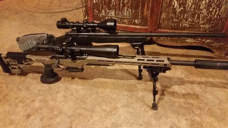

hi everybody, longtime listener first time caller.
okay so long story short.(i had originally wrote out the long version on how i got to this situation but decided to scrap it since nobody probably cares and it got kinda off topic.)
my budget is spent! and I dont have the rifle I want!
I currently have 700 aac-sd barreled action (.308, 1-10" twist, threaded barrel) that does not shoot better than a 2.5" group on a good day no matter what I try and believe me I've tried. if it grouped decent it would be exactly what i wanted. The barrel does not sit center in a stock, tried 3 different ones. off by 3mm or so at the end of the forend. I believe the receiver is out of true more than the average 700.
I also recently got a 700 in .308 with a 26" barrel. not threaded. 1-12 twist im assuming. dont know how well it shoots yet but atleast the barreled action is straight.
the things i plan to keep for the final rifle: ess chassis, vortex pst, timney, aac 51t break,aac sdn6 and harris bipod
i have the original hogue stock and a bell and carlson m40.
what would you do in this situation?
try to find the money to true the aac action after selling the other rifle?
rebarrel the 26" to keep and sell the aac for next to nothing cause i doubt many would want it?
lmk what yall think. I've been having nothing but bad luck out of the last few new firearms purchases and its kinda wearing me down.

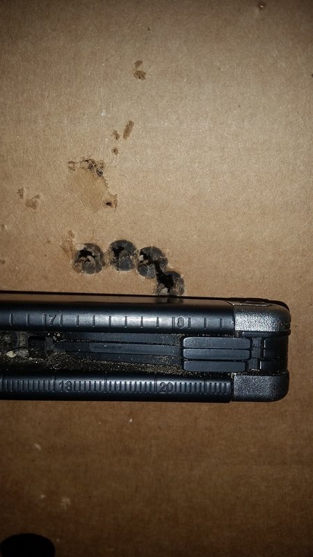

well guys, I think it pretty well worked out. last monday i got a call from the gun smith and they informed me my brand new rifle was here! remington warrantied the barrel and action! I was out of town for hurricane clean up so i couldnt go pick it up until monday, but i also had to replace my wifes water pump on her truck so that ruined me getting to shoot. put it in the chassis, swapped the trigger and mounted up the scope and suppressor. I was able to make up some loads last night with 180grn sst and 39.8 grn r-15 and just got to shoot as the sun went down. if you minus the shot i pulled, I managed a solid 3/4" 4 shot group off a plastic picnic table so I actually believe me and the rifle can do better in more favorable conditions.
