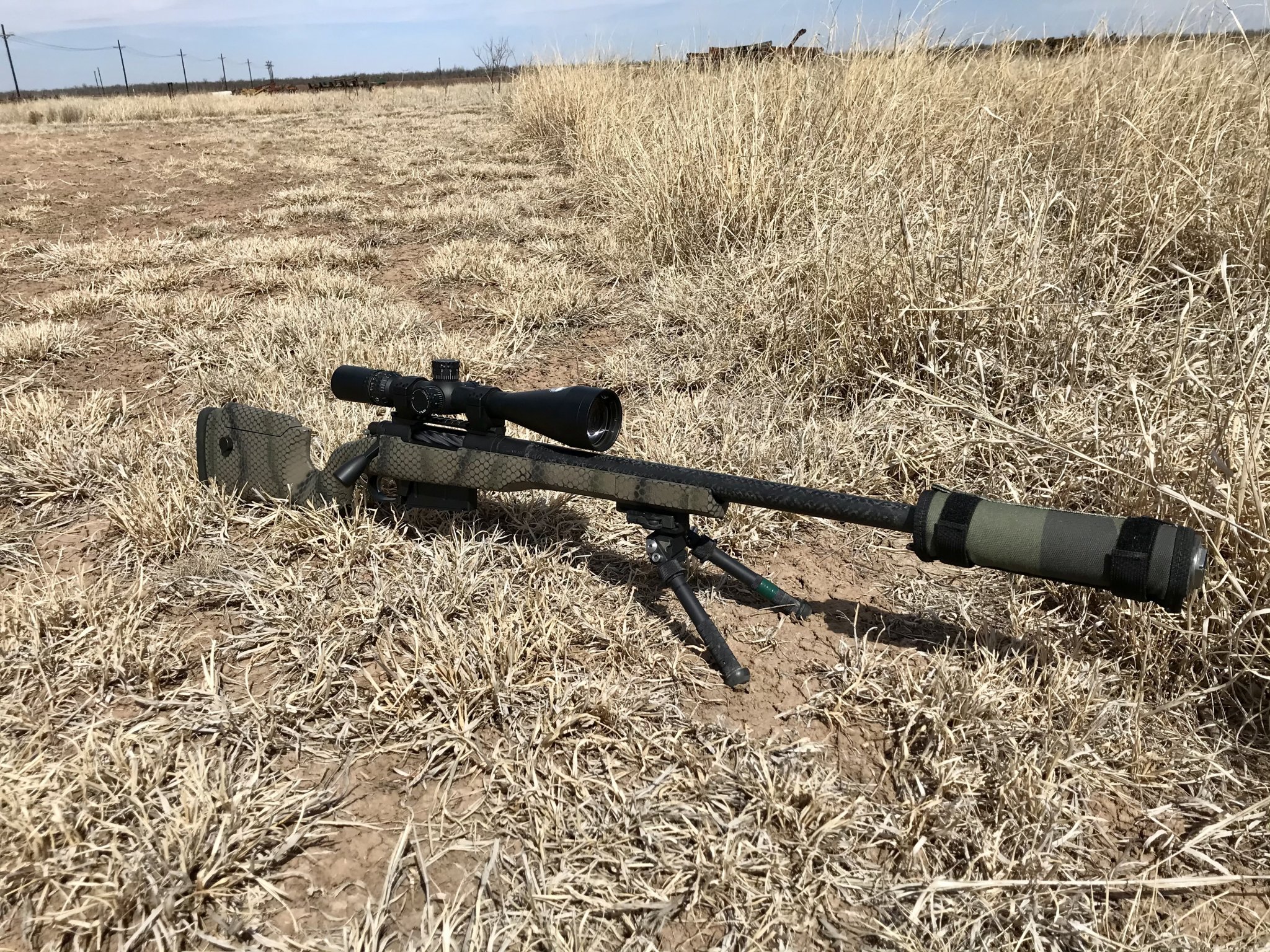

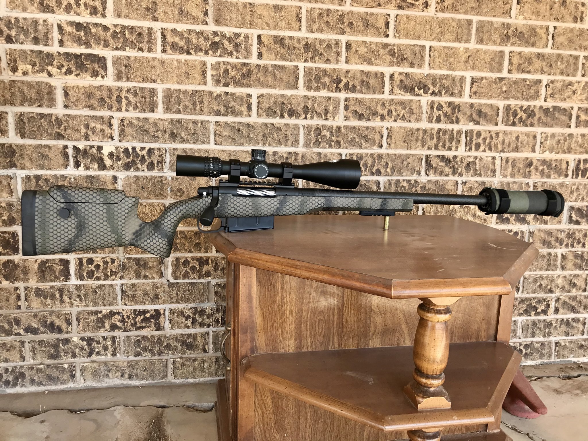

I run a 20” 30 Sherman Mag, Proof CF Bbl. I shoot 215 bergers at 2950fps with N570. Not running it hot either. It also shoots factory 300 PRC 212 ELD-X ammo at 2750fps

@CA48 thats a sexy build! I'm really impressed with the speeds of the factory 300PRC in the Sherman chamber. Do you think there would be much velocity boost in a standard PRC chamber as energy might not be wasted on pushing out the shoulders in the 300SM chamber for factory PRC ammo? And were those numbers based off of your barrel before or after it sped up?

Slowshot18, those velocities were after the barrel sped up. I don’t think you would see much difference in velocity with a standard 300 PRC maybe 10 or 15 fps.
