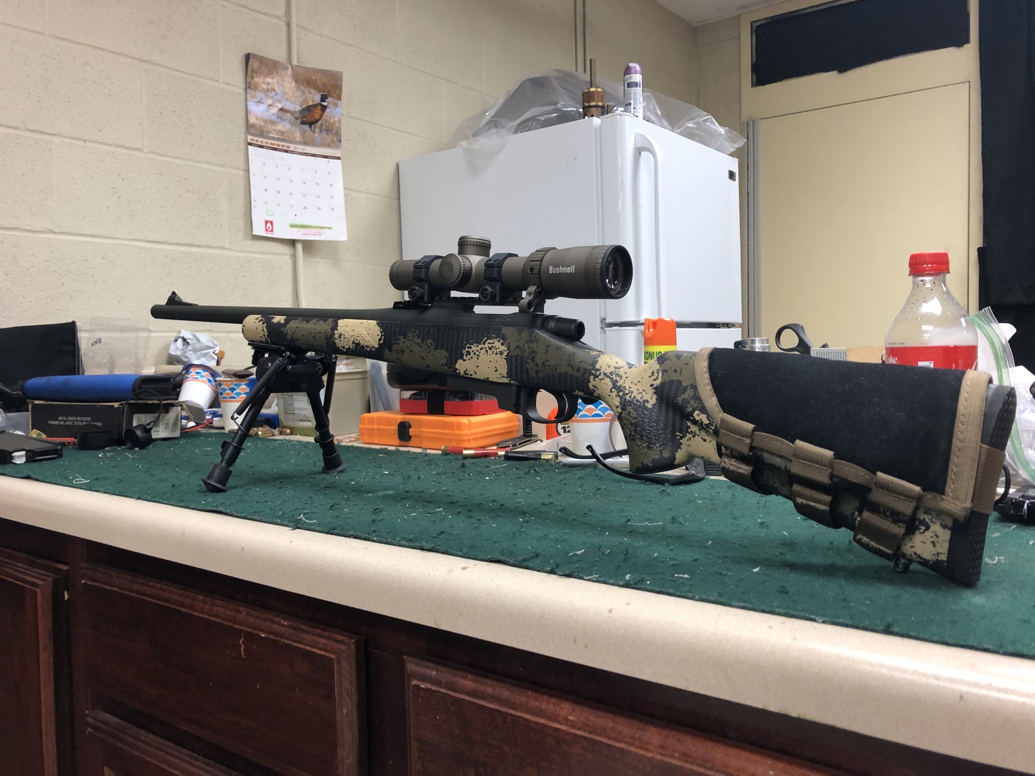

First one I’m having built is a 27 Nosler on a defiance deviant hunter action with HCA carbon fiber barrel bedded in an AG Compiste Alpine hunter stock, with either a trigger tech special trigger or a Bix’n Andy, zero delta rings and Schmidt &Bender 4-16x50. Dan Pedersen out of Prescott Az. is doing the build.

That is without.
