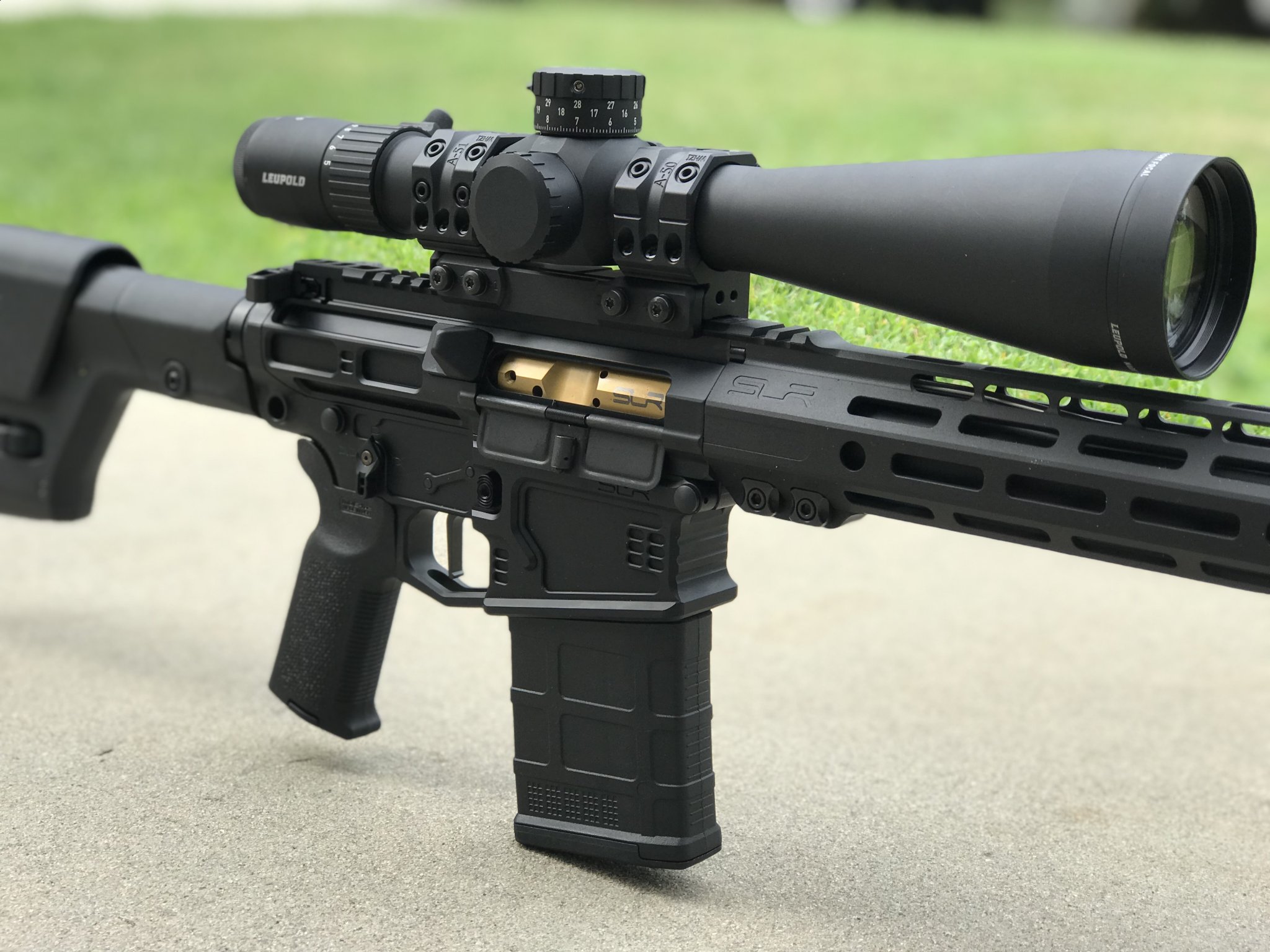

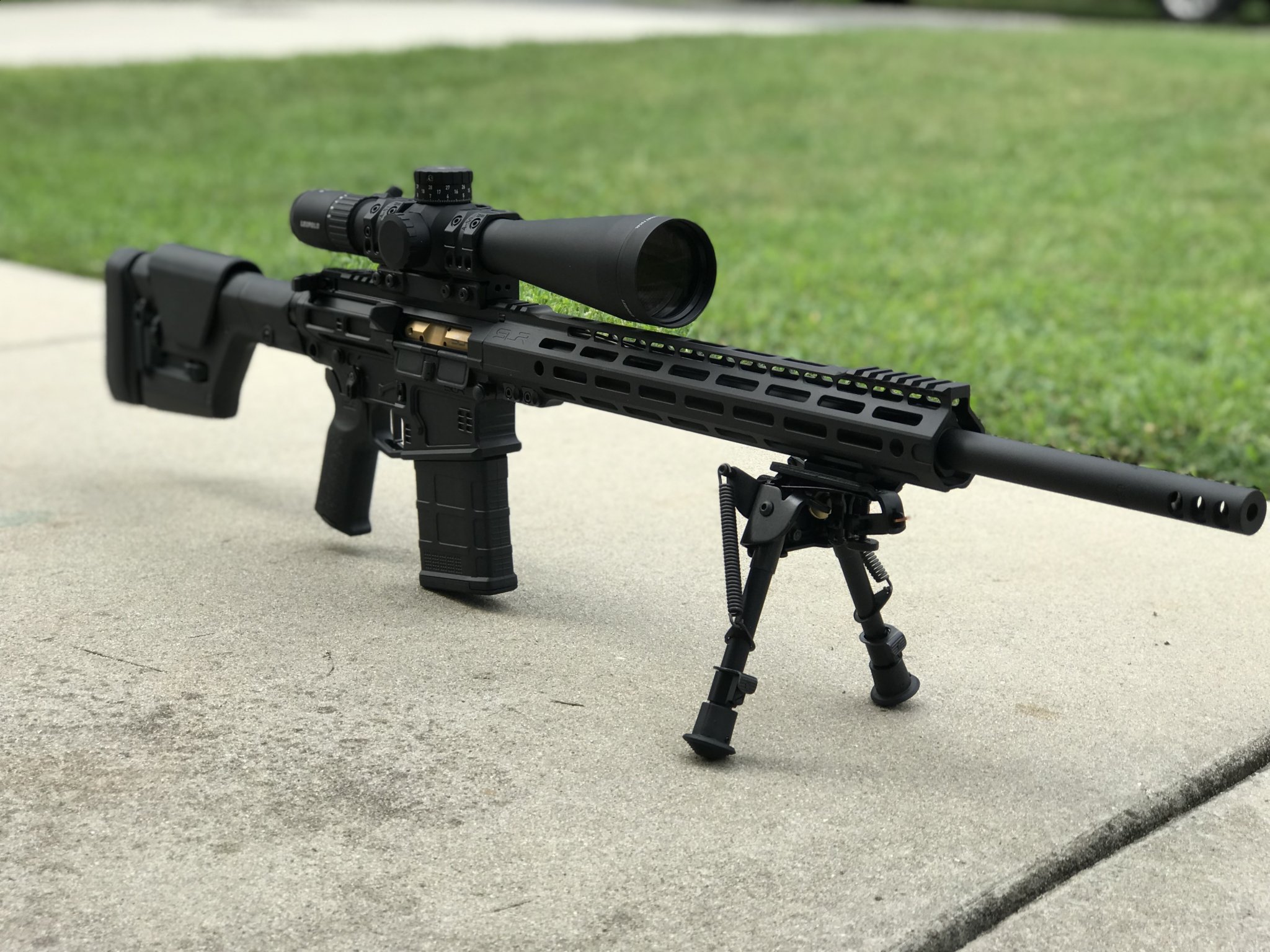

I received my SLR 308 Upper/Lower today as well as the handguard and BCG. Ordered a gas black and charging handle through them as well. It’s not together yet as Craddock is still turning a barrel for me but just initial fitment to each other and finish is just remarkable. I’m kind of hard to impress and like the finer things. I expect high quality when I order high quality stuff and their stuff is legit. The machining and the finish is some of the best I’ve seen. Their BCG’s are extremely nice as well. Properly staked and the finish on them is top of the line too. Curious myself to see how true the face of the upper is as well as the extension to upper receiver fit. I’ll know in a few weeks and update.

Damn good looking set up Pusher. Is it 308? 20"? I'm just guessing from the pics.
Also what charging handle is that? Looks an AX? I'm putting my 308 together slowly but surely just trying to narrow down my small items.
