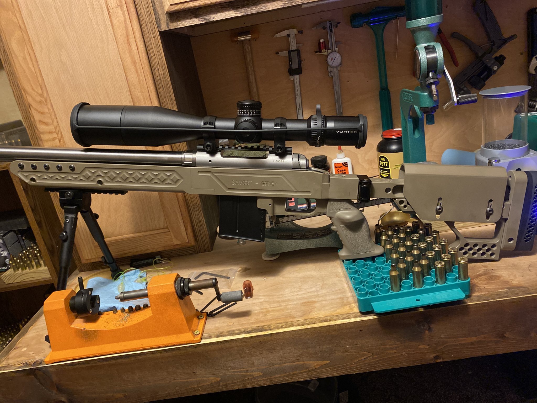

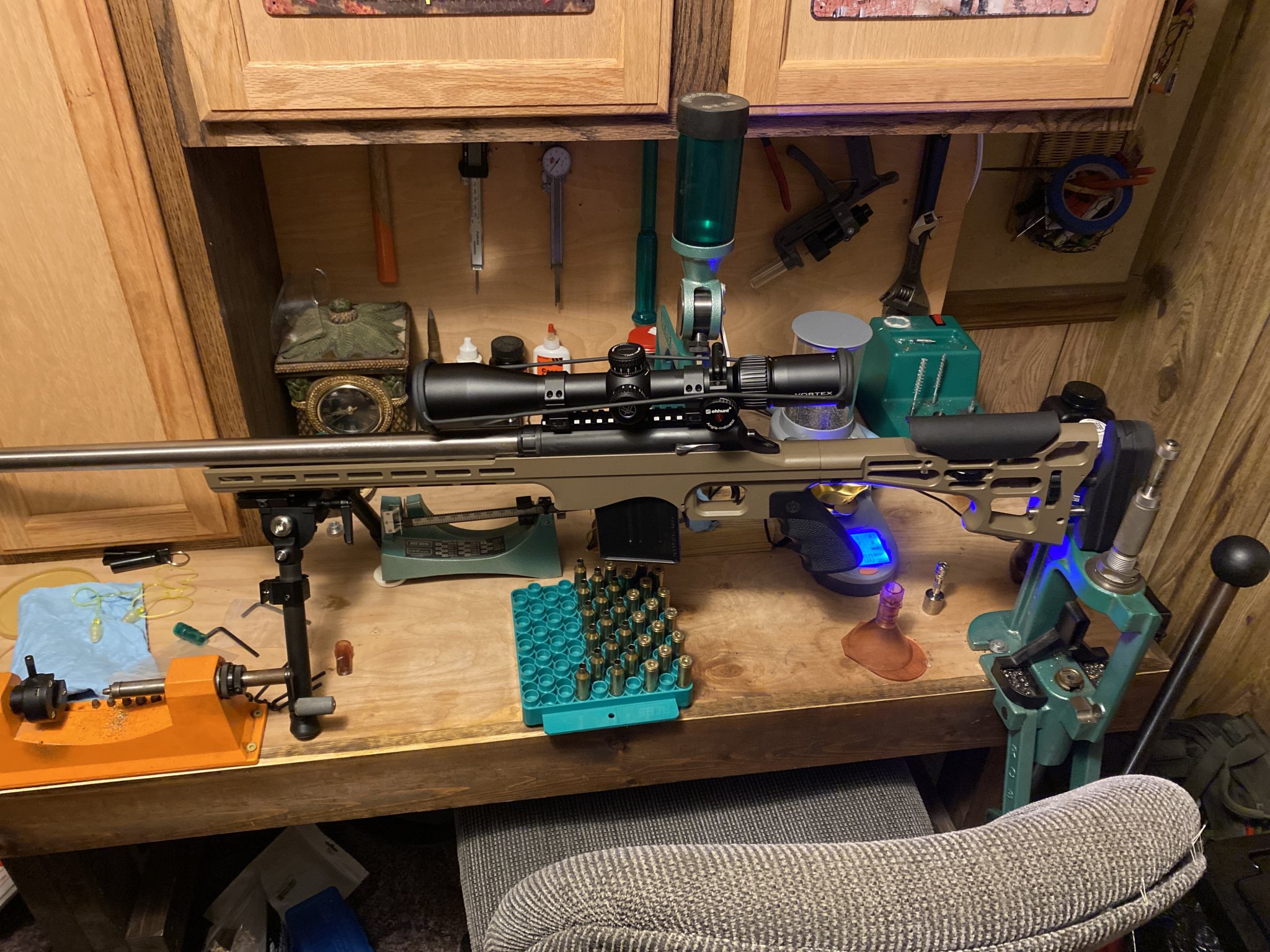

I built mine for about 1300 it is savage 12 action mcrees. Chassis off e bay Schilen Ssm barrel it is tack driver apa fat bas.... lol I can’t spell
Reactions: TheChief

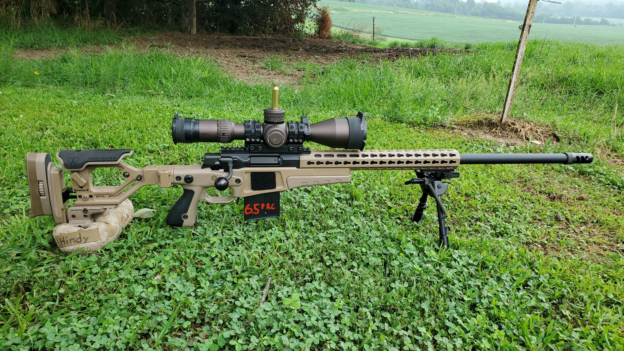

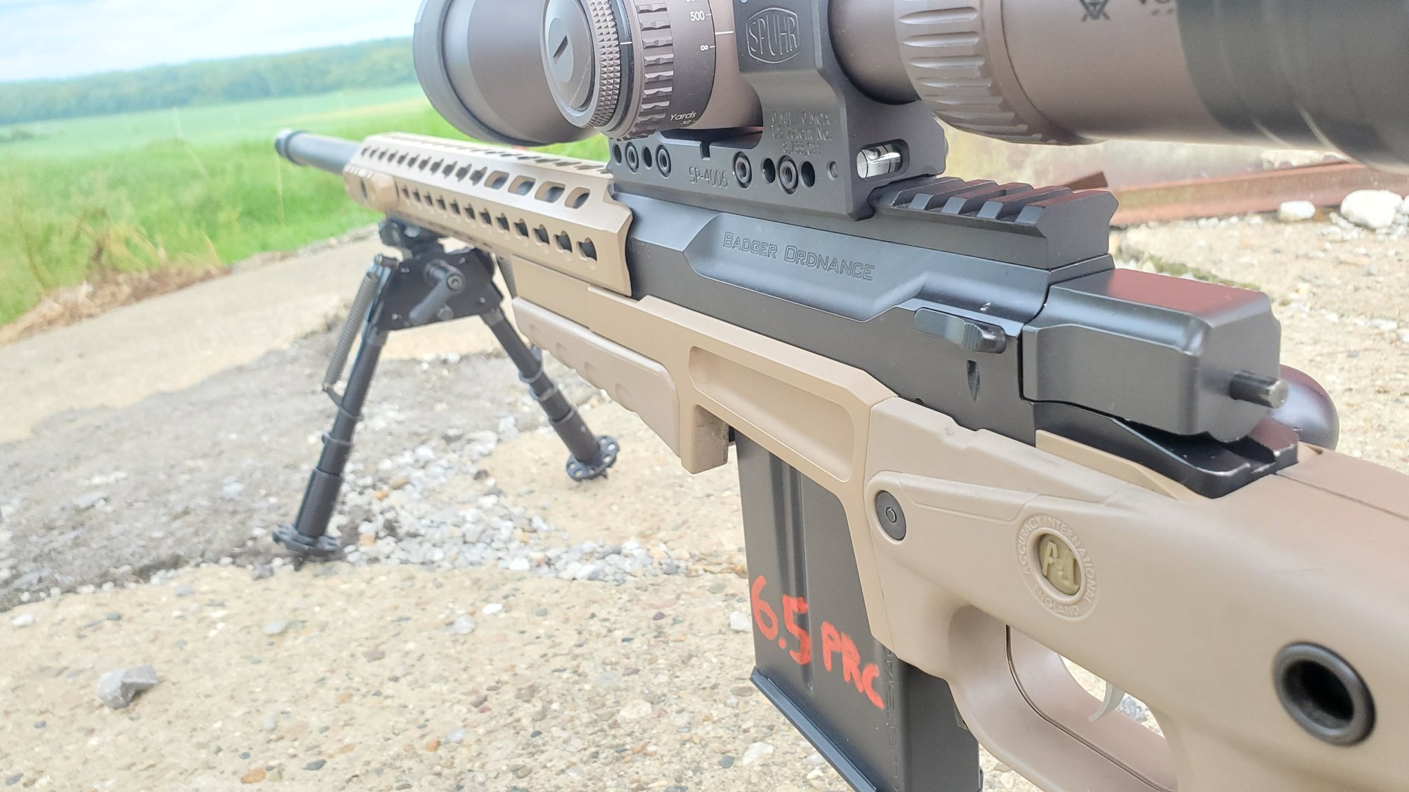

View attachment 7427077View attachment 7427080
I gave up on an ax short action mag bolt. Badger 2013, with standard and mag bolts, 6.5prc and 6.5creed barrels, ax chassis, and bix 2 stage pro trigger.
That is a nice peace just outside my price range I have to stay on a little lighter budget but I have lots of lower budget guns that shoot 1/2 moa or better that is what I’m after see how cheep I can build a 1/2 moa or better gun
I bought the 2013 with 2 6.5 creed barrels and chassis for 2750. I bought a mag bolt from badger for 475 and had a bart hvy palma spun up in prc with a no turn nk and .155 freebore. Not counting glass or mount, im at 3750ish

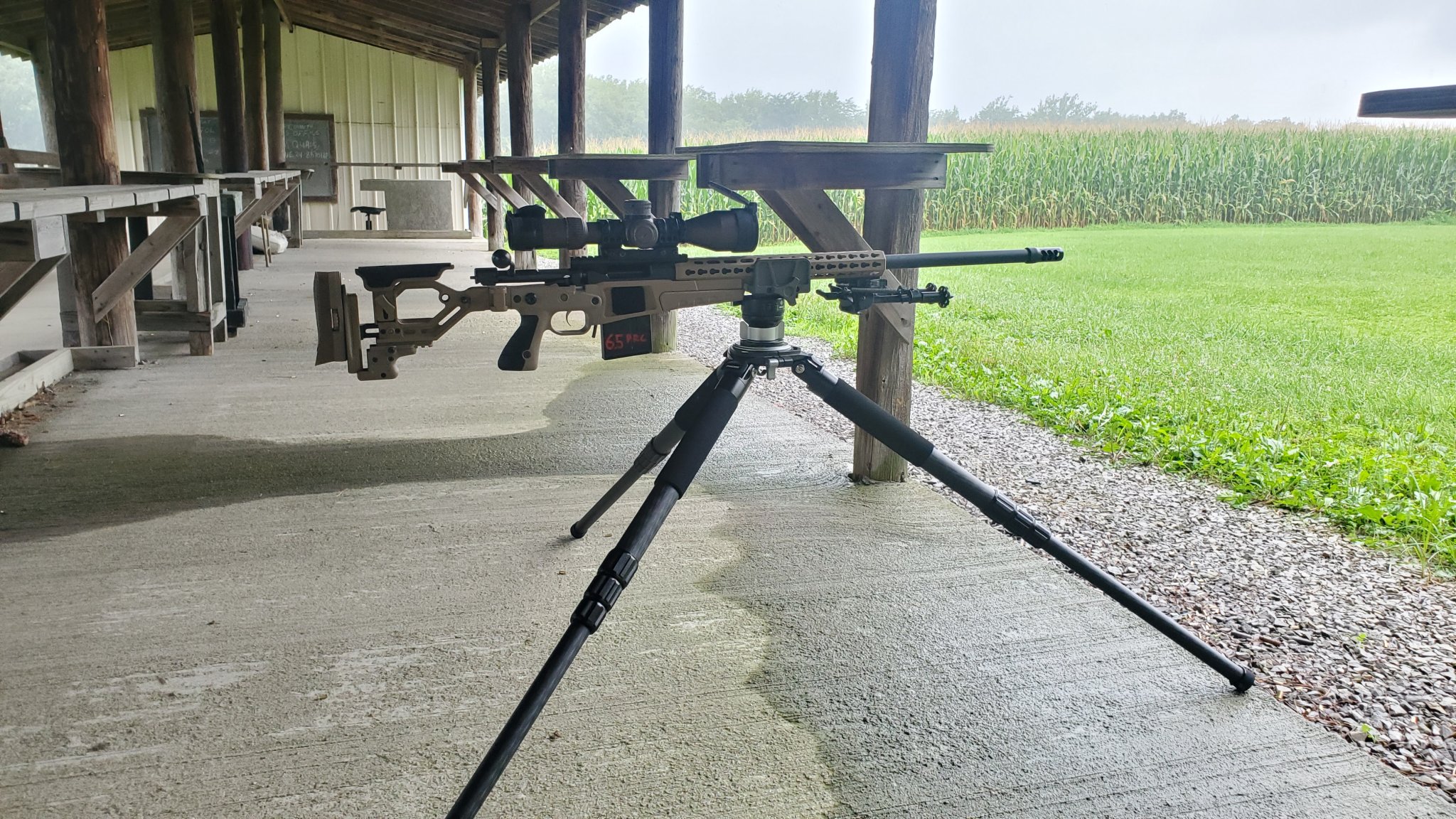

definitely not cheap, but not as bad as it looks, lol. I swapped brakes and shot these 2 groups when I rezeroed. It was pouring during the tripod group and hog saddle wasn't near as solid as arca. 4 shots are in 3/4"
Bighorn Origin Action - $825
Proof Research Steel Prefit 6.5 PRC barrel - $479
TriggerTech Diamond - $279
AREA 419 Hellfire brake - $160
MPA BA Comp Chassis - $999
Harris BRM 6"-9" bipod - $110
$2,852.00
definitely not cheap, but not as bad as it looks, lol. I swapped brakes and shot these 2 groups when I rezeroed. It was pouring during the tripod group and hog saddle wasn't near as solid as arca. 4 shots are in 3/4"View attachment 7427099View attachment 7427100
