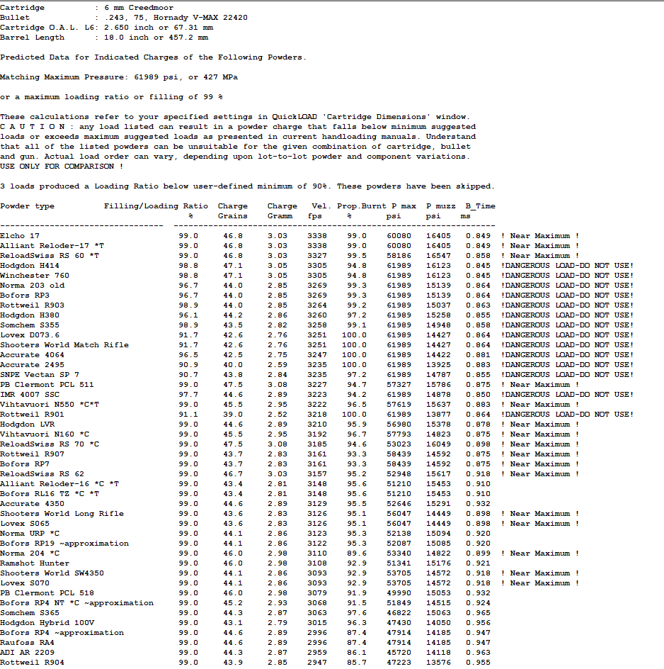

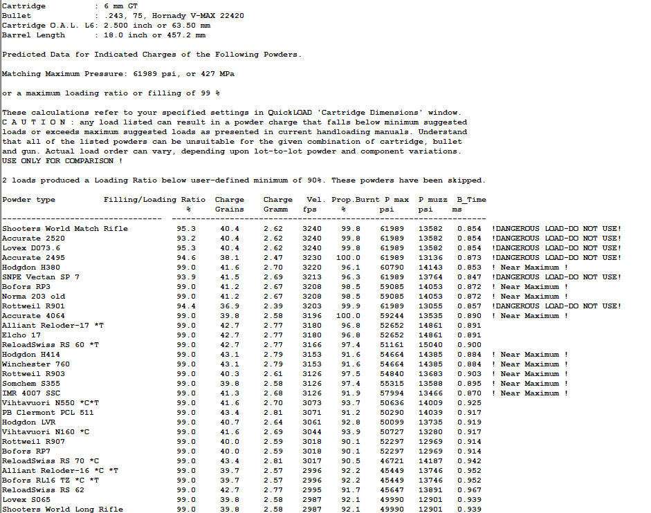

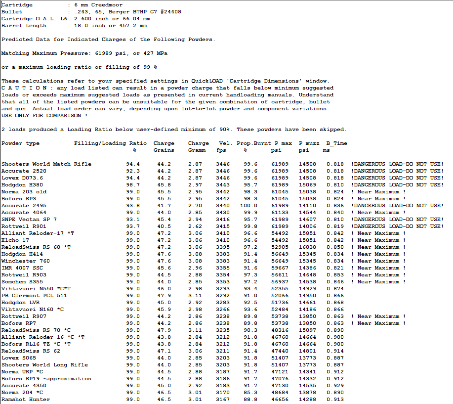

I am building a new predator hunting rifle and it will have an 18" barrel shooting light 58-75gr projectiles. It will be ran with a suppressor. I was going to chamber it in 6 Creedmoor but also considering 6xc and 6 GT. I started wondering if I would be losing much velocity with going to a 6GT over a 6 Creedmoor in that short of a barrel. Would the extra case capacity of the Creedmoor gain me anything over the GT with such a short barrel and light projectiles? Does anyone shoot a combination like this? If so what are your velocities?
Just running some numbers....
With a 65gr BTHP in 6mm Creed out of an 18" barrel, you're looking at somewhere in the 3400-ish range
And with a 75gr VMAX, for example, it's not a whole lot different.

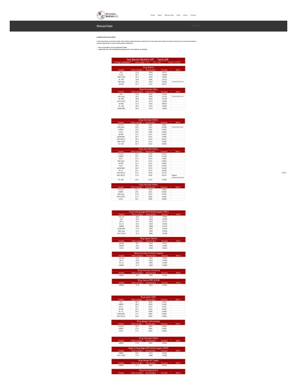

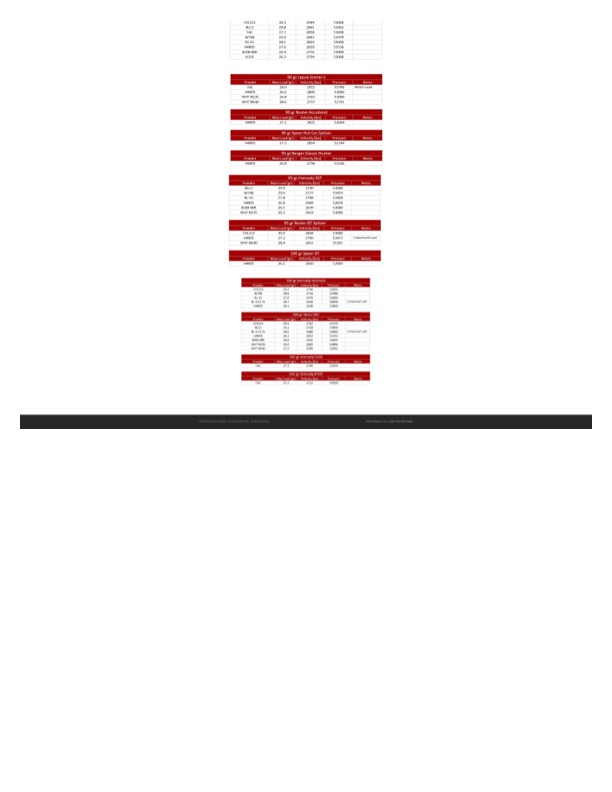

For reference, I'm shooting a 16" 6mm Creed AR-10 using 95VLDs running at 2800fps.
Also just for reference, and to follow up on my comment above, one of my 243 LBC (a 6 ARC predecessor, just a 6mm Grendel) AR15s is a 19" shooting that same 95gr VLD at 2,800 fps. (Not making that up - same velocity as yours.) It takes 3" more barrel to get there, and a load of Leverevolution powder; I'm guessing your load is with a stick powder of some sort.
This one also does the 90gr TGK at 3,000 fps (give up 100 fps if you prefer the 90gr ELD) and the 70gr TNT at 3,225 fps - not quite the 3,400 mentioned above but not too far off either. Case life is good in my rifles with all of these loads, meaning 10+ loads per case.
