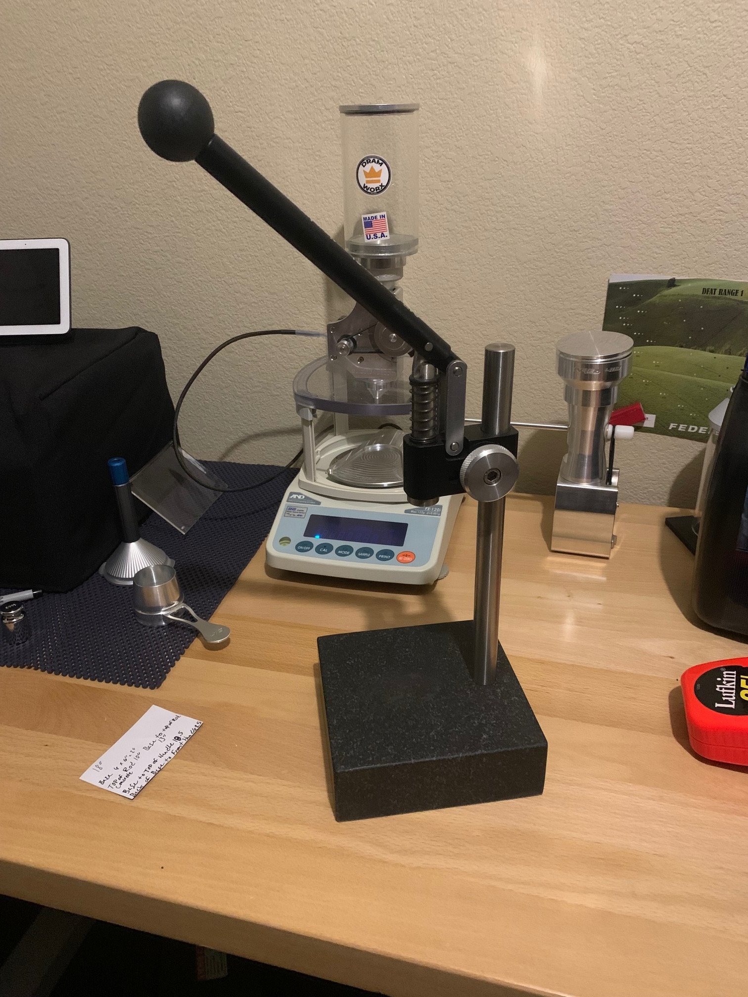

I purchased my first Arbor Press at the end of last year, and I ended up going with the 21st Century New Generation Arbor Press. I bought the head only, with their 10.5" post, and then purchased from amazon a 6x6x2" granite check base (below). I am sure the standard base from 21st century would be fine, but this base weighs right at 2lbs and gives it a nice solid foundation. At some point I would like to have another press with a Hydro indicator, but right now I am just looking to learn the feel of the arbor press. Compared to my redding big boss II, its kinda crazy how much more you feel in the seating process.
Nice! Did the post screw right on to the base? Or did you have to add your own attachment?

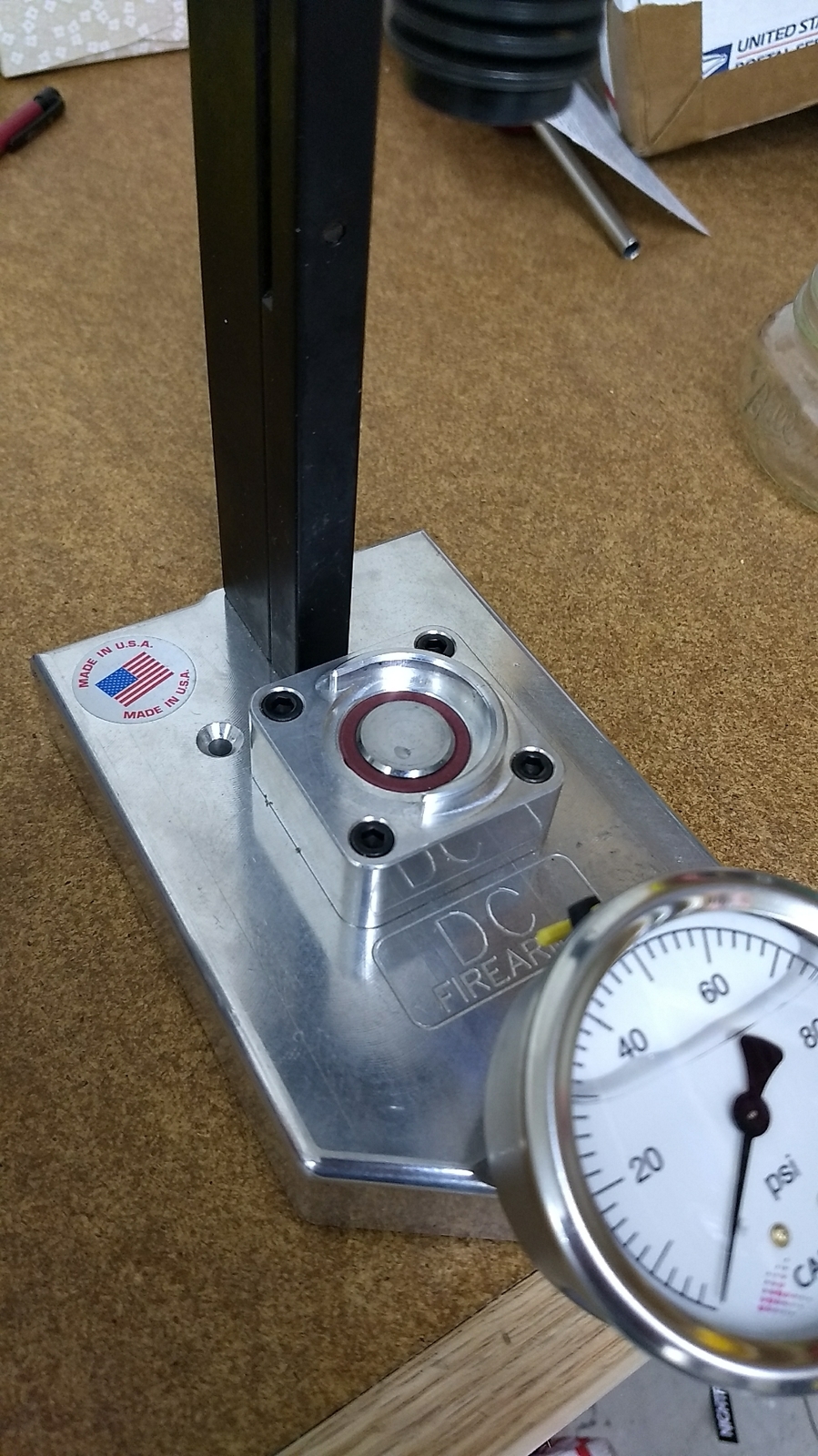

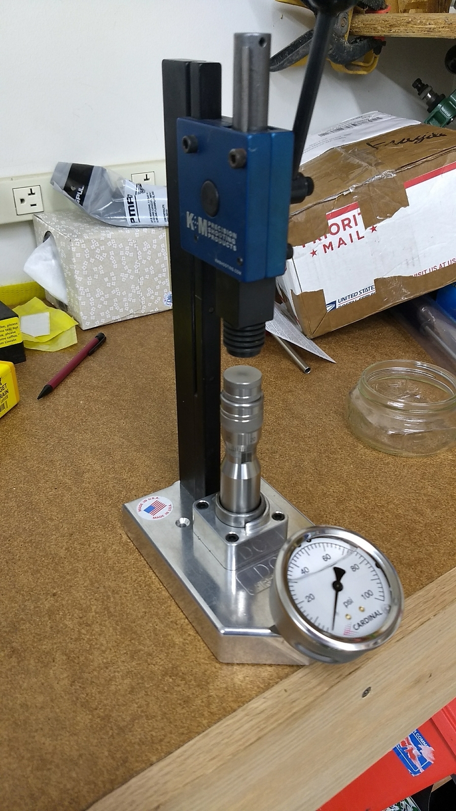

If you are interested in a hydro arbor press, although it may be overkill I find Dale Carpenters hydro press base pretty interesting. He can be reached at [email protected]
View attachment 7677405View attachment 7677467
Looks like a novel design for a seating press gage arrangement.
If that is your press, how does it go if you need to exert more than the dial indicates?
I have a K & M with the 46 Lb gage settup & sometime I take the gage well over 46 LB. It uses those disc springs &, although it seems to come back to zero, I've often wondered if it's damaging the spring washers.
If you exceed 100 PSI you are damaging bullet tips and there is no reason to go over 80.
No, I don't normally go over 35 to 40 LB.
I did some tests on my annealed cases to see what seating force was required after x number of load & shoot cycles without annealing.
I was wondering if the hydraulic units would put up with some overpressure without damage.
It won't damage the hydro press it will cause the gauge to read high it doesn't effect anything and really all you are looking for is a pressure spike or to stay under a certain number whether that number is 5 or 25.
