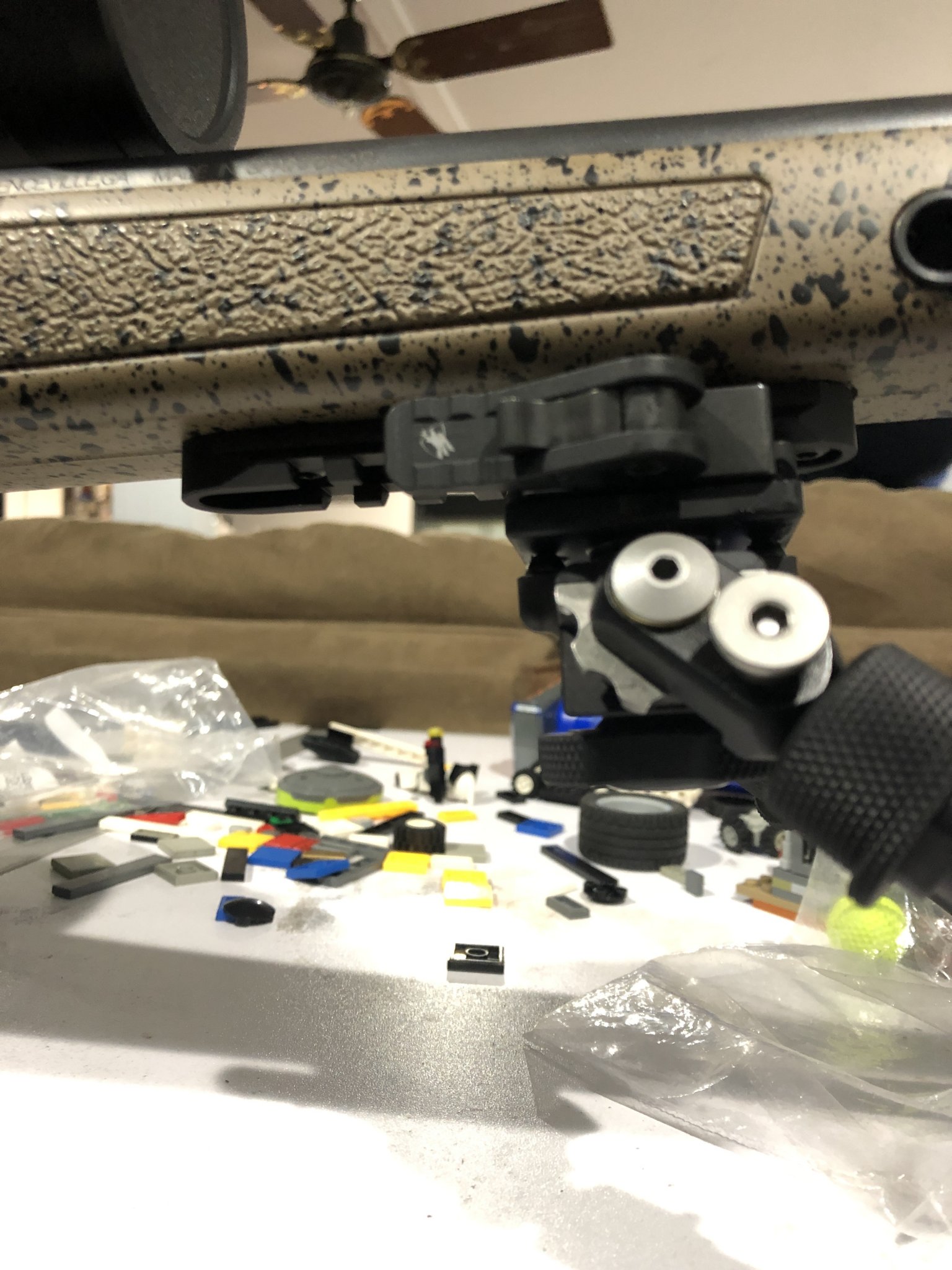

I got the BT17 4" rail for my HMR, fit perfect. Flat bottom matches the flat forend on the HMR stock. G2G
ETA: I used the rear sling stud with a crush washer (basically just a plastic gasket under the stud head, lets you time the sling stud while still keeping the rail attachment tight) and a #10-32 screw in the channel that threads into the front sling stud spot. The screw should be a 30 cent part from a local hardware store.
Awesome man, I appreciate your quick response. I went and snagged it after I read this and they had mounting bolts too. I’ve got a QD sling and it has a QD spot as well as the two on the stock already. Took less than 5 min total to install and it fits perfectly.
Glad to hear it, it's a clean little piece of gear, and I'm glad the HMR stock has easy attachment points for it. I had to drill and tap another hole when I added a 10" ARCA rail, though, but that was easy too, just tapped the threads straight into the chassis core.
What length 10-32 and what size crush washer did you use? On a second note my swivel stud in the back does not seem to get more than a few threads into the stock to begin with. Any help would be appreciated.
