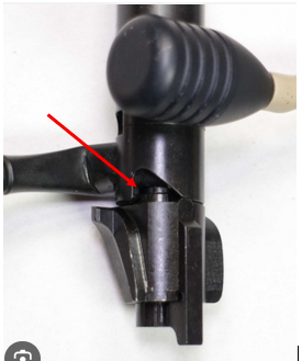

Ah, grease in pretty much any place that needs lubricating?? Only lubricant I use at all is a bit on the back of the bolt lugs and a bit in the primary extraction cam groove (there must be a more official term for this). This is on Rem 700 clone actions. Anyway, here...and I don't gob it up...just a bit of grease is good and it lasts (well, I guess if you use good synthetic grease).
