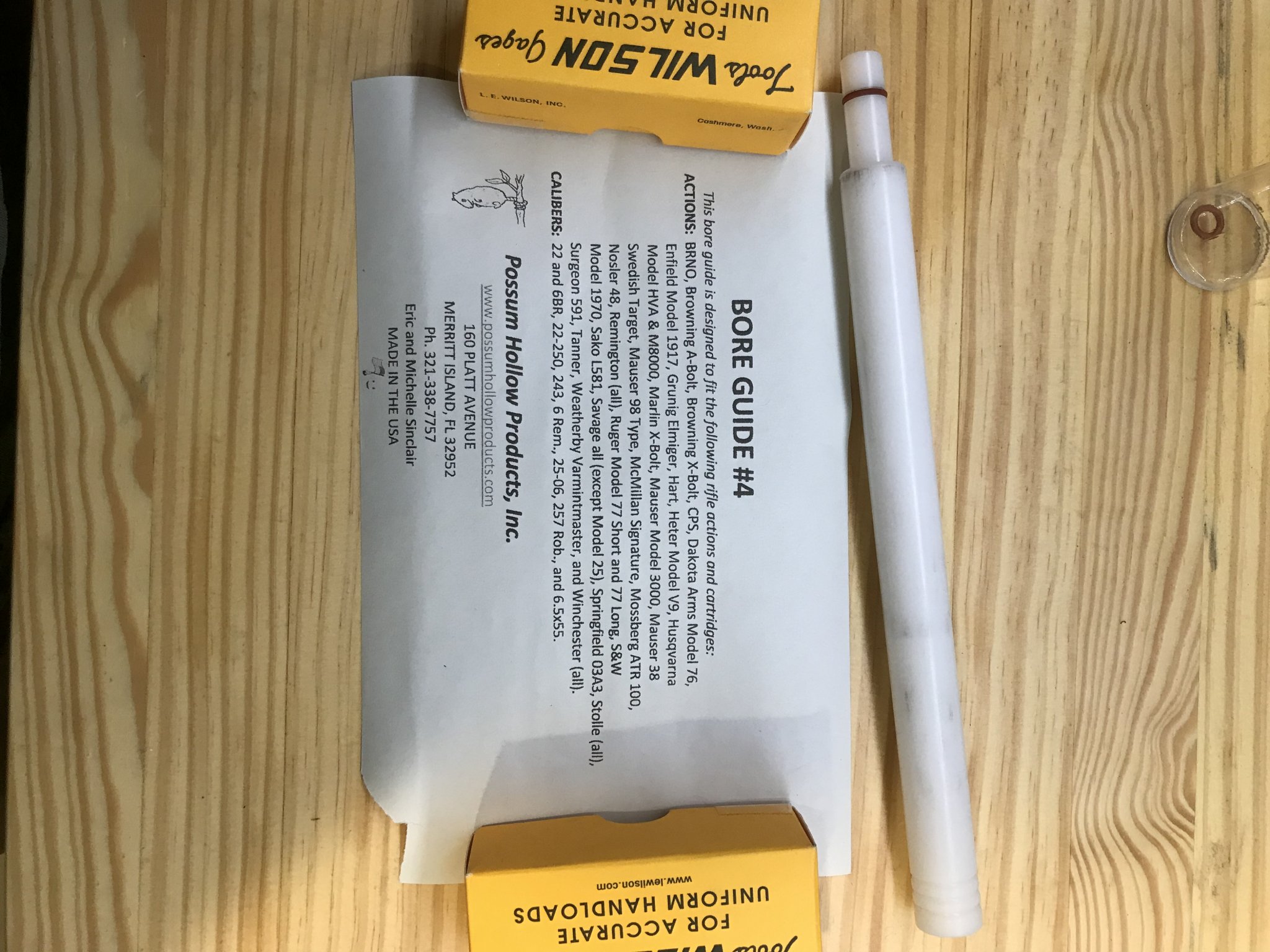

I've always used Lucas but he didn't make one for my SRS A1. Called Eric at Possum Hollow and he sent me one in a week. Another great guy to deal with and it's just as nice IMHO.

Just call his phone # listed on his website and he will eventually pick up. He will custom make a bore guide to whatever length you want for your particular rifle and caliber. As someone mentioned earlier, have him mill out a hole for solvent so the guide is 1 piece.
