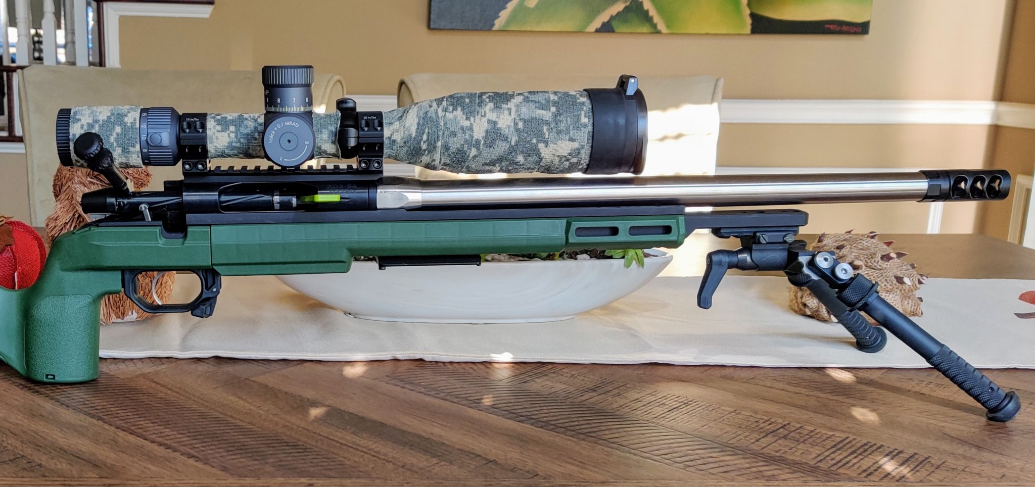

They will all get the job done. This not your barrel but you can use it for size reference. It's .89" right behind the PVA Jet Blast brake, The brake nut flats are .93" across. Perhaps an "advantage" of the 419 brakes is the knurled, round nut that will always look even.
