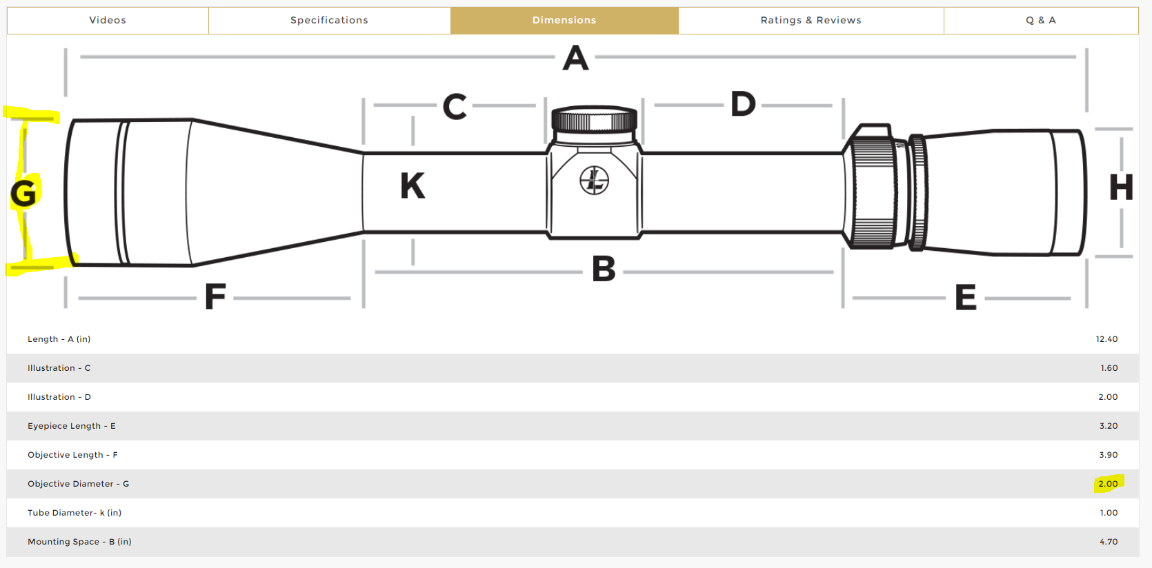

OP:
Objective diameter fro the markar 4-12x40ao is 2", that means you have 1" minimum below the scopes centerline which you have to overcome, and even more so that the scope isnt touching. Your 3/4" rings comment will obviously not work.
If you have the scope and rifle already then get some cards or something stackable to set on the picaitnny rail and then put the scope on top of. Then see how high you need to stack the cards to be able to properly see through the scope.
Most rings are measured from top of the rail to scope centerline. The 1" tube means that 1/2" of tube is below that centerline which you would need to consider. So if you need 1" of cards to see through the scope plus the 1/2" of tube means 1.5" tall rings. Some measure to the bottom of the tube though so in that case it would just be the 1" measurement of the cards. You need to know how the manufacturer got their listed dimensions to know what the listed dimensions are good for.
Reactions: Hollywood 6mm
OP:
Thank you for the illustration and information. I appreciate you sharing your knowledge.

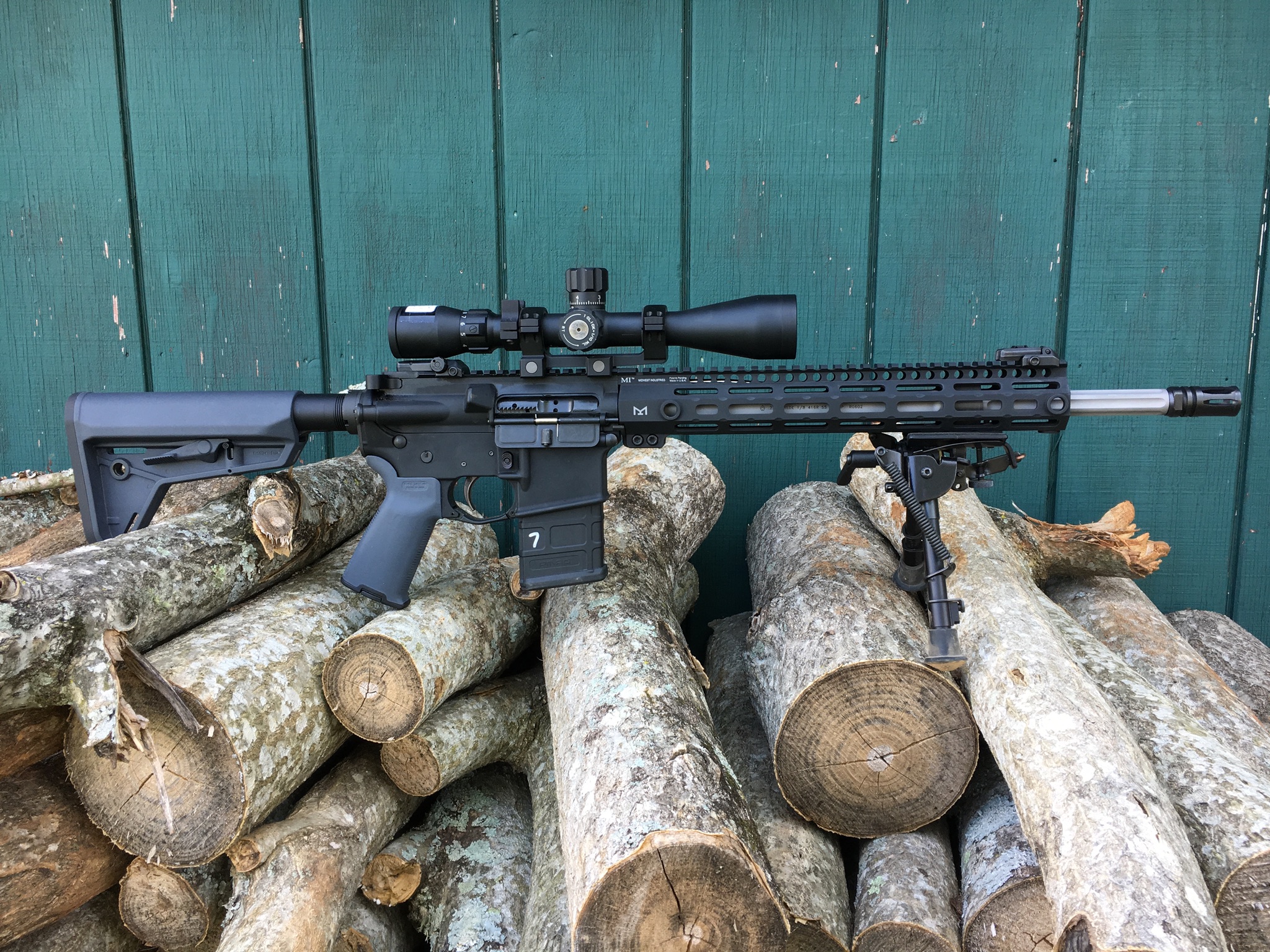

I was running an LT807 with a MK6 3-18x44 on an LMT. It’s a 1.375” mount and I had to run a CTR w/ a RISR to get proper cheek weld/height.
Lower mounts can be run an ARs, just depends on the type of upper and the ring spacing needed. You can also run rings on certain uppers. If you have a monolithic upper then you have nothing to worry about. Other things to consider are BUIS and their folded height, type of stock, and LOP. I'm about to experiment with an ATACR 4-16x42mm in an LT120, which if it is anything like how I mounted an NXS F1 in rings, it should sit within about a tenth of the MK6 setup. That means I might be able to run with just a SOPMOD or I'd have to toss on the CTR with a RISR. Regardless, don't let peeps tell you it won't work when it will. See what works best for you and the rifle setup game, especially on an AR, is all about experimentation (like college). lol
