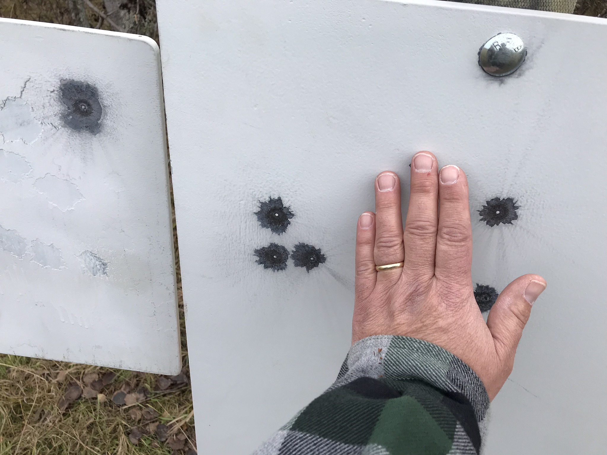

Currently using old stock 208amax@2905fps via 76.0 H1000, Fed 210, and RP brass. Phenominal results. Finalizing the 225eldm using H1000@ 74.2, Fed 215, and Norma brass. 2805fps. Also finalizing the new 208eldm ended up at 76.0 H1000, but a bit slower (60fps). Previous owner of rifle had good luck with the 215 and 230 Bergers. Below is the other day at 997yds. Three shots of the older 208amax.

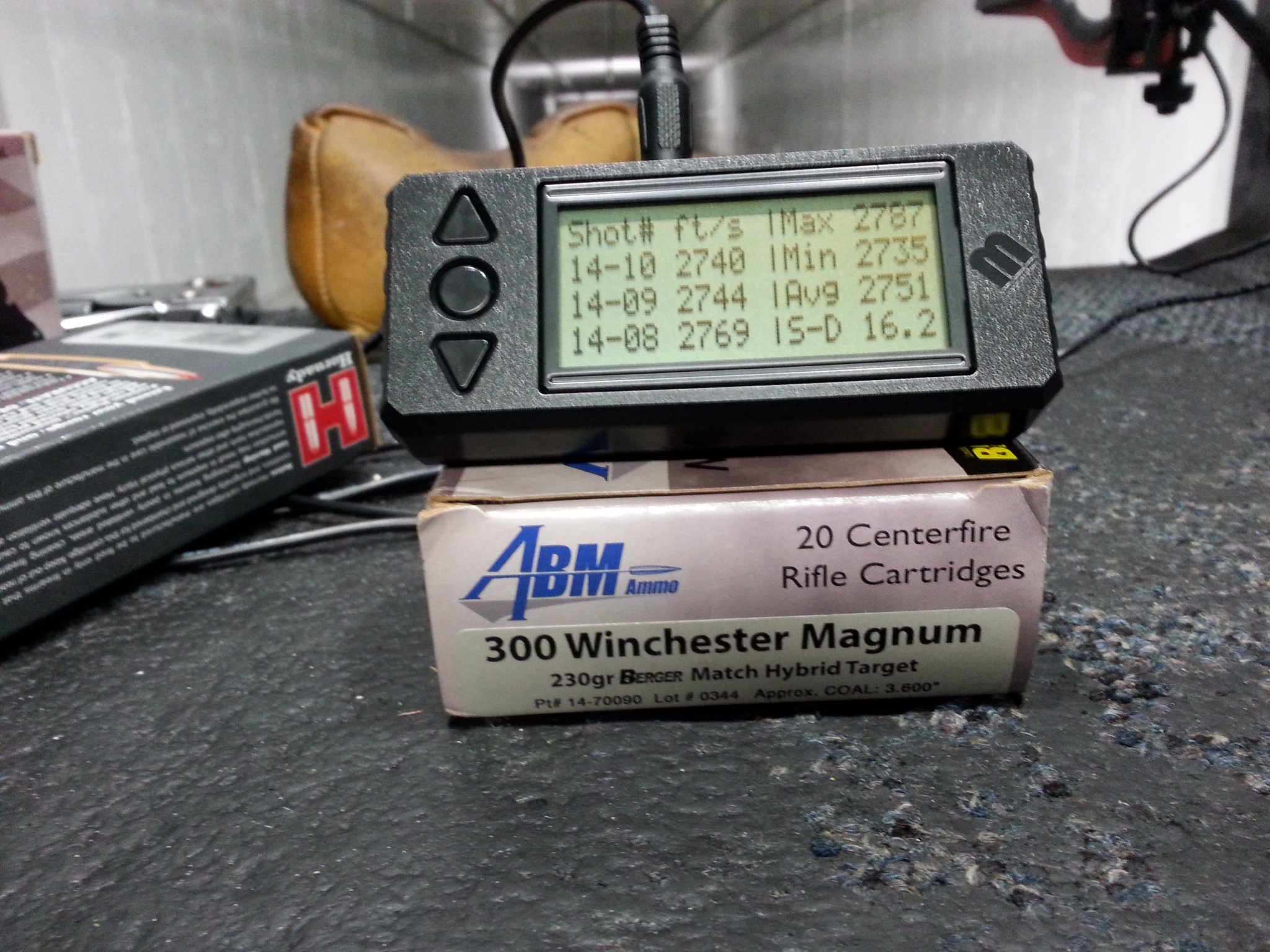

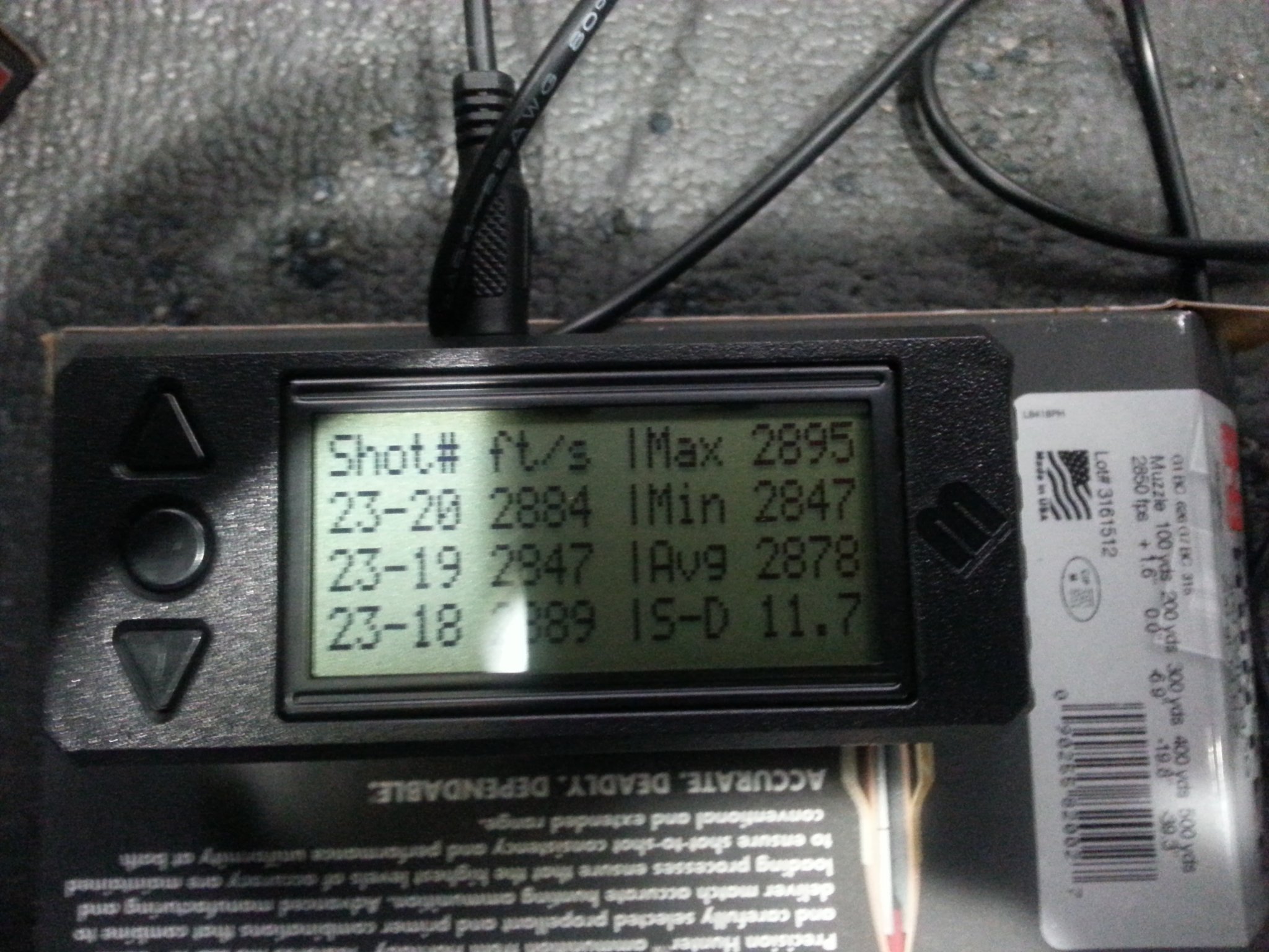

Top to bottom
Hornady 200gr ELD-X
ABM 230gr Berger VLD (ABM is now Berger factory ammo)
ABM 215gr Berger VLD I did email abm about the SD's and they said it was uncomon and sent me a free box of ammo that I didn't even ask for I was just enquiring of what to expect which was pretty cool.
