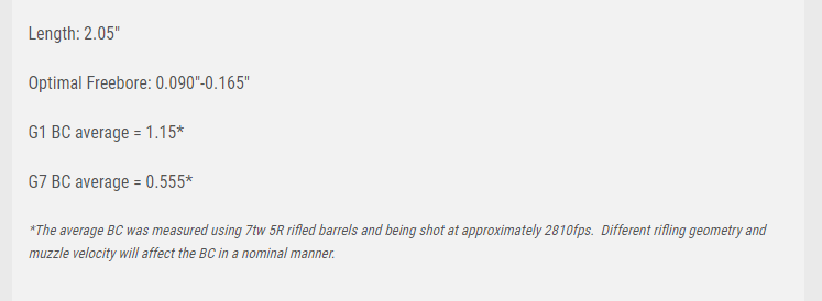

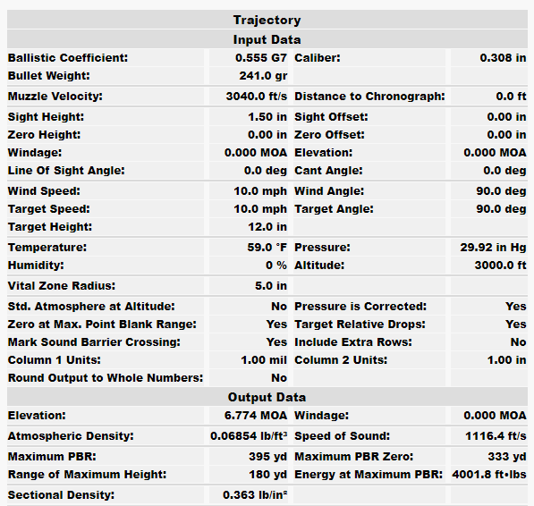

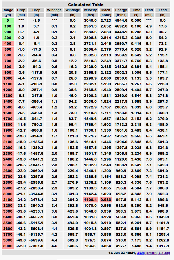

Case in point, I'm currently working on a 241 Seneca load with .300NM. While my 250 A-Tip load stays supersonic out to 2600 yards (at 3000' AGL), these solids at the same velocity will stay super sonic to 3100 yards.
