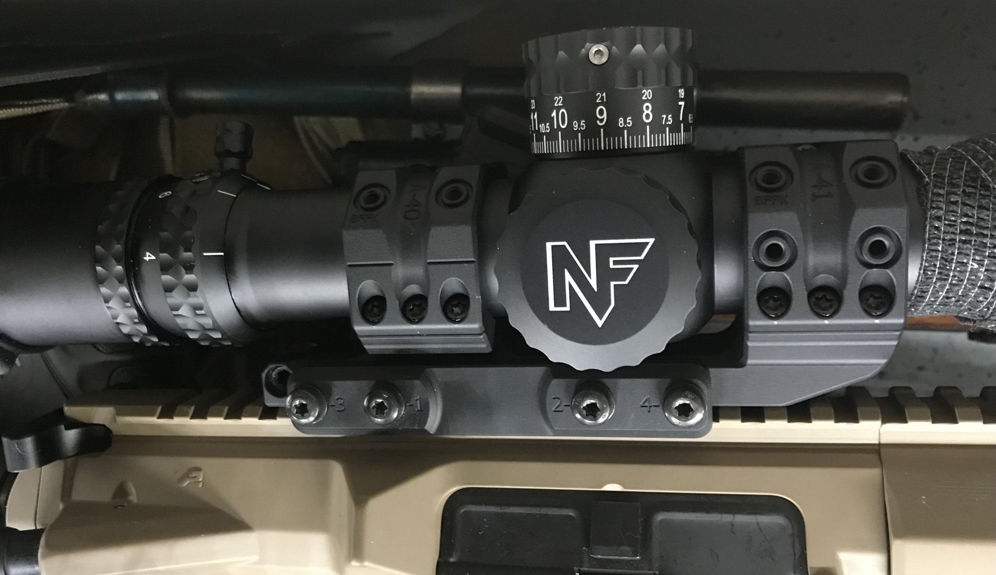

    As noted above, looks like this:

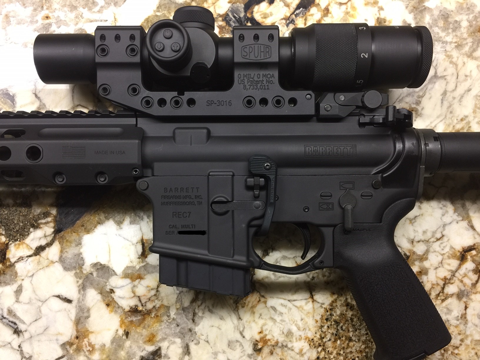

    I’ve got one of the spuhr cantilever amounts on an M5 and might have barely been able to get away with a standard mount, but didn’t want to deal with possibly running out of real estate before getting eye relief just right for my setup. The cantilever gives you a bit more leeway vs a standard mount. Likely a must on an ar15 upper receiver especially if using buis. I don’t see how anyone could go wrong with a cantilever mount on an ar platform. Plenty of options out there to choose from.

    I mean don't get me wrong I like mine a lot. But on OPs AR platform it would be overlapping/contacting the handguard rail, which is why you use a cantilever in the first place, is it not?
    maybe. maybe not. depends on the optic.
    of the two pics posted in the thread both could likely get away with the minor cantilever of an MBrace (#3 would be close, #6 would be good to go for sure)
