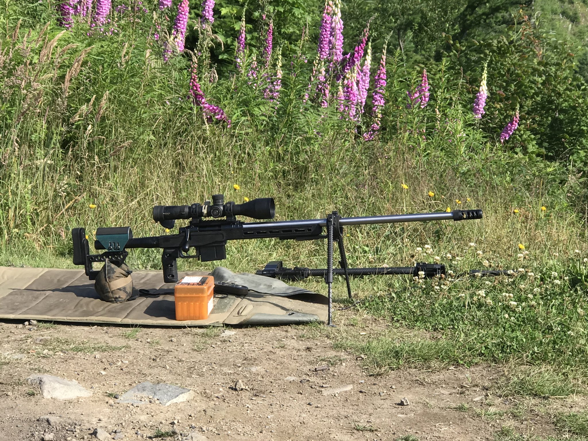

    On a short action I mag feed 168’s (Berger classic hunters @2.86 which is close to the lands) and single feed 190’s at a bit over 3.0.
    lighter hunting bullets in 7 saum absolutely work in a short action with lots of room in the mags and feed nicely.

    I shoot 168 Berger VLD Hunter in my 7 SAUM in a short action. Great rifle. I’m getting around 3100 out of mine.

    I see no point to a 7 SAUM if you are going to build the rifle on a long action. A 7mm RM will get you the same or better performance, handle the really long projectiles better, has readily available good brass, and a very wide variety of factory ammo. I urge you to reconsider. I say this as someone that just built a 7 SAUM on a short action.
    Thanks for your opinion. I called up PVA today and ordered the barrel in 7SAUM. Also ordered the Archimedes action. A long action. I intend to shoot bullets in the 154 to 168gr weight. I don't want to shoot the ultra heavies. I want to be able to if I decide to. PVA',s reamer is SAMMI spec so I think it's probably optimized for COL's around 2.800" since that's the design length for a short action. Feeding longish "short action" cartridges in a long action with the controlled round feed of the Archimedes should be pretty reliable. And, I'll have the optimum chamber freebore for the bullets I want to shoot. What have I overlooked?
    I know that you‘ve moved ahead, but I agree with this statement. I was considering the same thing, but think it could be a bit of a waste. Thinking I’ll do a 7LRM or possibly 7-300 PRC until XLR builds the Element 3 Magnesium in a XM length.
    If you are shooting 168 gr bullets, this can be done very efficiently in a short action. Mine shoots great. Only reason I’d build another is to shave a small amount of weight, try a chassis and to shoot the 170 Cayuga.
    All good insight but I still prefer a long action for the 7 SAUM. My reasoning is: It works in a long action.
    2nd, If I decide later that I want a different caliber I'm not limited by my action to choosing only Short Action calibers. The Archimedes actions have interchangeable bolt faces so changing calibers down the road is just a re barrel plus maybe a bolt face. I like options.
    If you feel like lobbing some 180-190’s you’ll like the long action.
    My Charlie tarac shipped.
    There’s a possibility I might try for 3000 yards next week with my 7 saum.
    Reactions: The D
    If you're building in a long action I wouldn't use the sammi reamer, put more freebore in it so you can seat long bullets out farther. Gives you the option to use the 175-190 grain bullets with better BC. Personally I'd build it on a Tikka, it's about perfect with a 3.56 long action, MDT makes a chassis and mag to fit it. Hells Canyon makes a mag for the factory bottom metal which gives you lots of other options.
    Yeah,... short action might be better if I'm going to shoot the 168 range projectiles... Been doing a lot of research... Still undecided but leaning towards the SA. Starting to think the 6.5 SAUM by GA Precision might be the gun to model mine after.
    The short action route is what I’d do if I was doing a hunting build with 168’s and lighter.
    You can still single feed heavies if needed.
    Reactions: Jumper
    If you lived closer to OKC, I’d let you shoot mine to see how you like a short action 7 SAUM. I don’t have any issues with feeding 168 grain Berger VLD. Plenty of length. I’m getting about 3125 out of them. Crazy fast. Bolt gets a bit heavy with suppressor, but without it cycles just fine.
    My quandary is that I’m looking to shoot 170 Cayuga’s but really need a XM length to do that right. XLR doesn’t make the magnesium chassis in XM length yet (hint hint XLR...), so I’ll likely build a 7 LRM for the 170 Cayuga to whet my appetite for chassis.
    Thanks for the advice. I think choosing a chassis is the hardest decision about this project... I should probably start with the magazine that feeds the 7 SAUM reliably and then get the appropriate chassis. Would the 7 SAUM work in 6.5PRC magazines?
    With 168 and under, yes.
    With 180’s, yes with some jump.
    After cancelling my initial order with ARC for a long action (Sorry Mr Karaigis) I ordered a short action Archimedes, action wrench and a set of M10 scope rings. I was really undecided about doing this caliber in a short action. A couple things swayed my decision; input from this forum, and finding a mag from area 419 that lists a max c.o.l. of 2.925. for the 7 SAUM. That's long enough if I want to try some heavies. Now for the chassis. Base option is the KRG Bravo. If my budget doesn't get consumed with peripheral things like dies and triggers I had planned on the Magpul Pro700 folder. Looked at the MDT models. Nice, but just doesn't appeal to me but I'm sure I'd be fine with it if I saw it in person. Thanks all for the info to all who posted. Very helpful.
