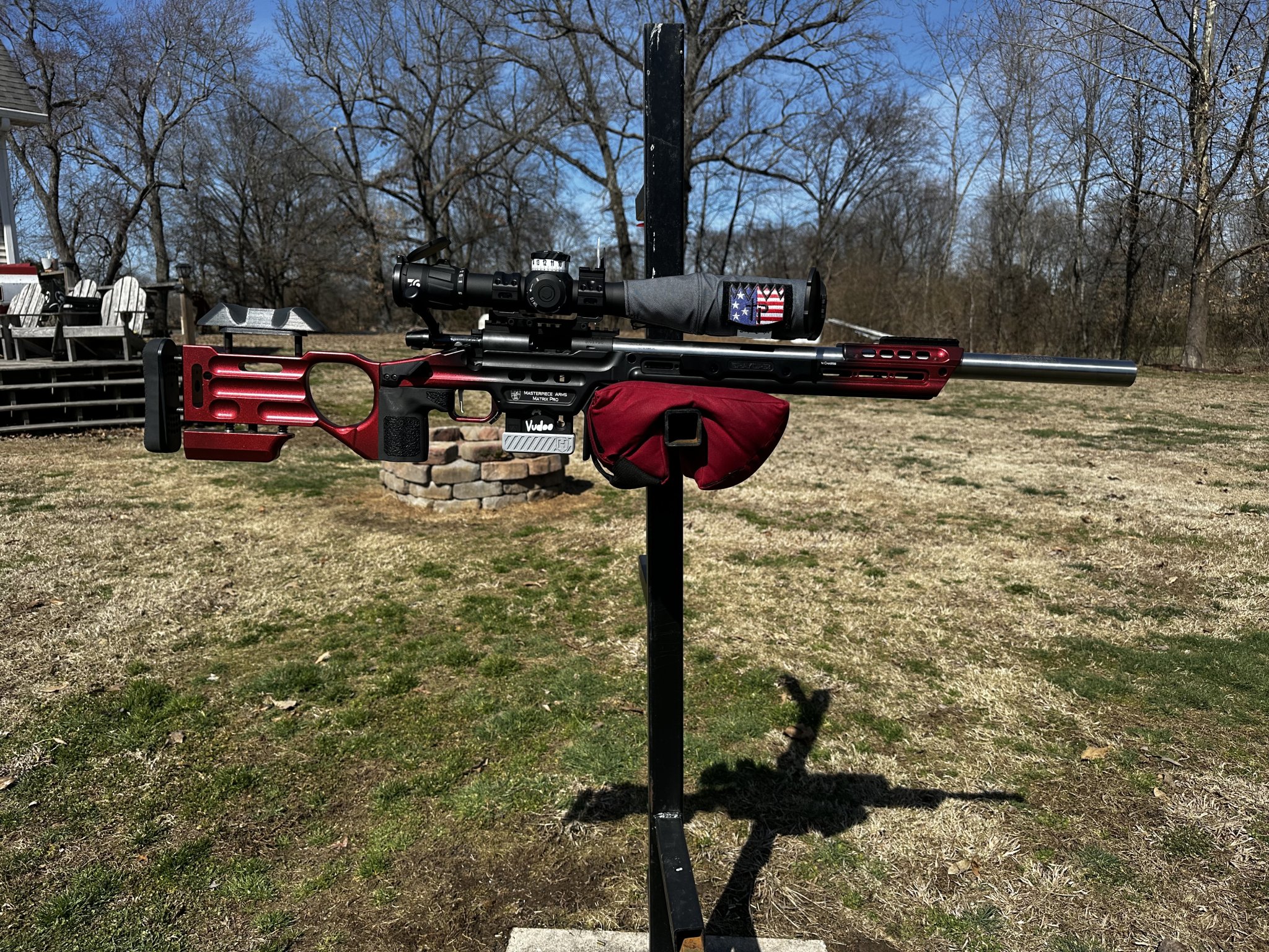

I have .22s in both - Vudoo in MPA BA Comp and Rim-X in MDT ACC (Premier gen 1).
Let me start this by saying I am an unabashed MDT fan. MDT went above and beyond for me early on in my precision rifle journey. Their customer service has always been top shelf for me. I have three rifles in ACC chassis.
With that said - if I am asked which one I'd recommend for a .22 build, I would say the following:
  • You really need to put hands on both, if possible. MDT used to offer a 30-day return window. Not sure about MPA.
  • The MPA BA Comp has a 12" forend. The MDT ACC gen-1 and Elite have 18" and 19" foreends respectively. This means that a 20" barrel won't clear the forend nuch if at all. My Rim-x has a 22" barrel (Heavy Varmint contour - almost straight 1.2") and looks kinda stumpy.
  • The new MDT ACC gen-2 has a shorter 15" forend. I'd go this route if I were going MDT (keeping in mind the first bullet above - best to put hands on).
  • With all that said - I like the look and feel of my Vudoo with its current 22" Bartlein MTU-contour barrel in the MPA BA Comp chassis. I have moved away from super-heavy contour barrels on all my rifles - old-age arthritis and loss of muscle mass make building positions in PRS-style matches challenging enough without the weight.

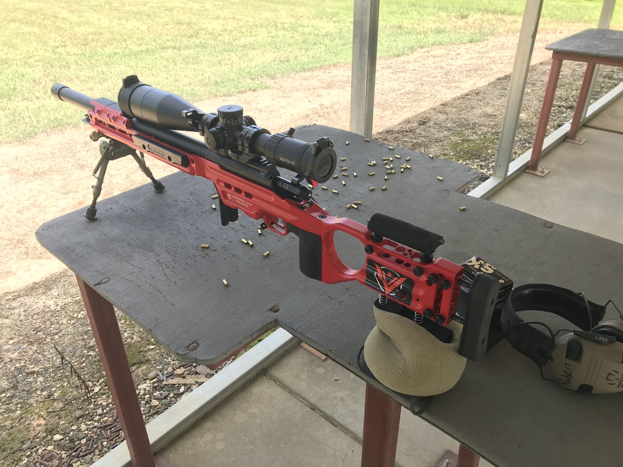

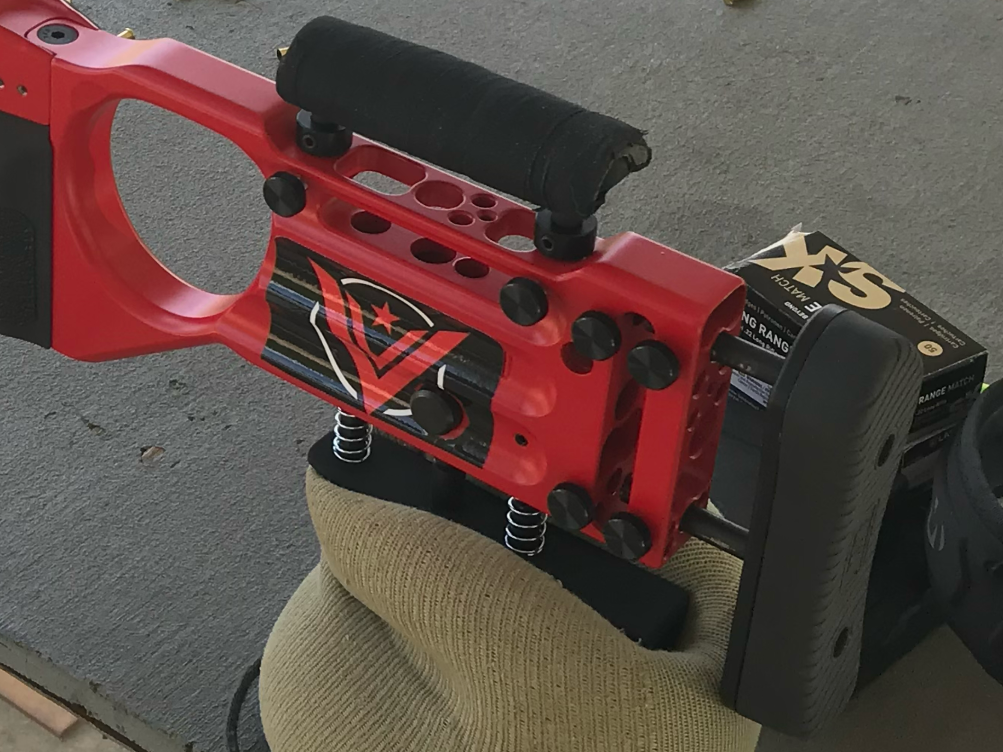

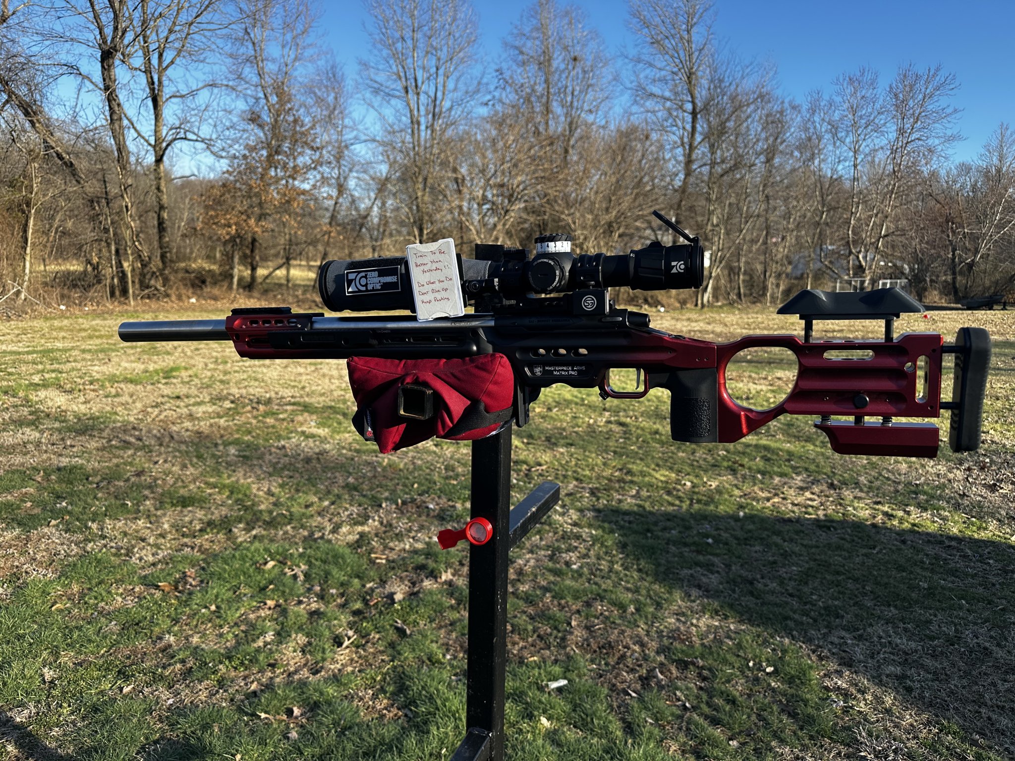

Here is an absolutely awful photo of the Vudoo (with original 20" Ace barrel, mid-weight Kukri contour) and Rim-X (22" Shilen, Heavy Varmint contour). The latter looks inordinately bigger because of the camera angle. Pay most attention to the barrel/forend config - again, Vudoo with 20", Rim-X with 22" barrel. The Rim-X has a KSS tuner on it which does NOT lengthen the barrel. Obviously, the 20" barrel would look pretty strange in the ACC.

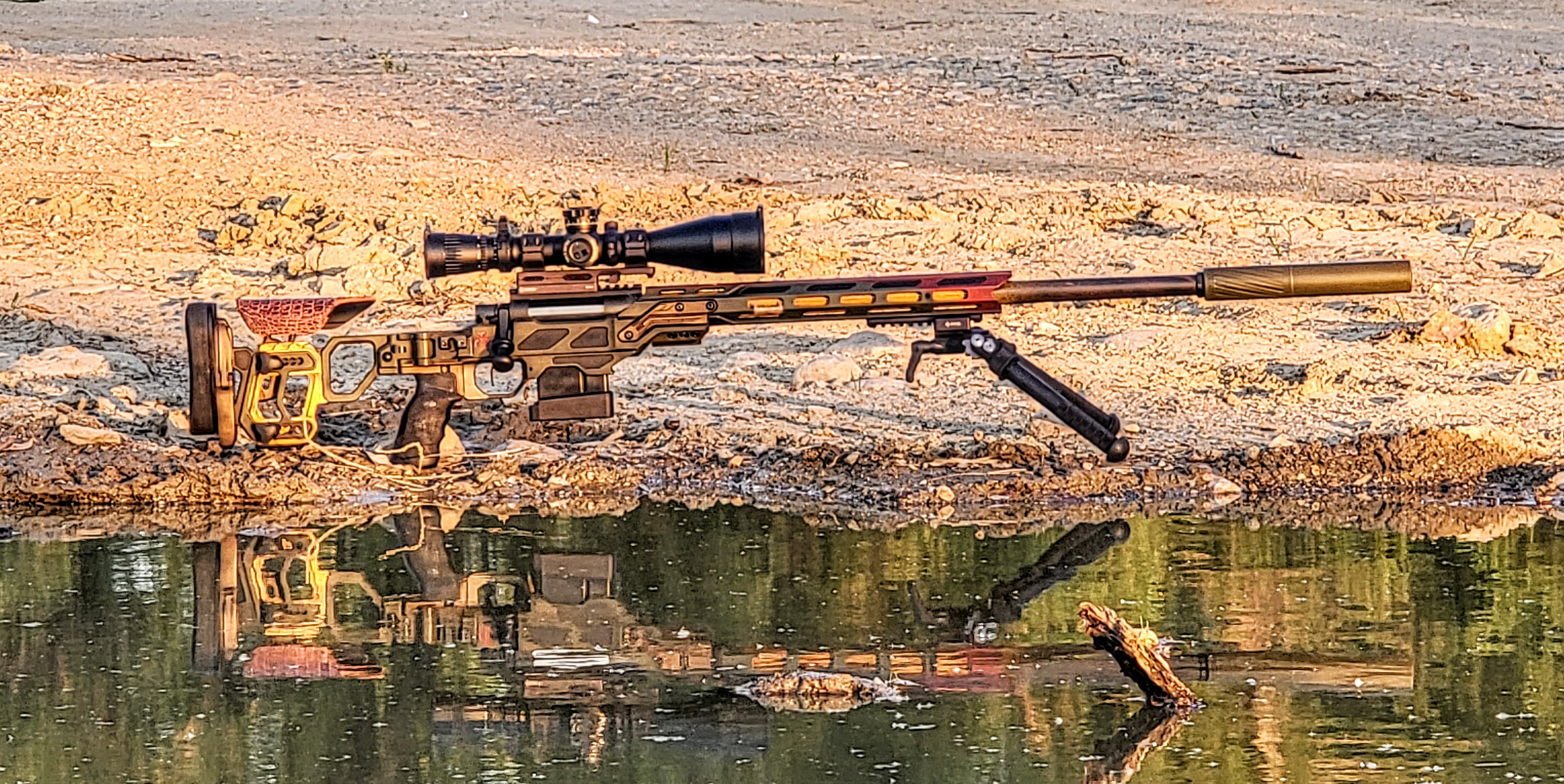

Pictures are of my ModX. My ModX was one of the first 5 Johnathan built before he went public and started taking orders. I have since had Rachel Precision spin a Brux barrel for it (Pictured) & that's what enabled Randy to build those as well. I have a 13T MW w/ Eley MCR Chamber and a 16T Brux w/ RP Lapua Chamber.

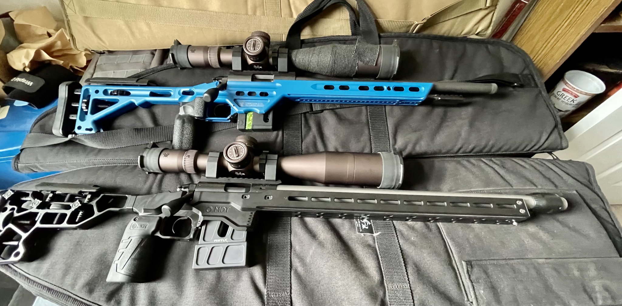

I have a standard Matrix Pro and also a Matrix Pro II with the light weight rear. That’s the close up and you can see the difference of the rider, no wheel adjustment and more drilled out areas to drop weight. I made a similar adjustment to my standard Pro by taking out the wheel in the cheek piece as you can see in the last pic of the standard. Also the bridges out front are different now but that really doesn’t make much difference.
I’d vote M-Pro2.
Have that and a ACC Elite and love the MPA.
I extended the grip and moved it forward an inch…. Perfect for my feel.
Currently at 22lbs and balanced 4.75” fore of the mag well.

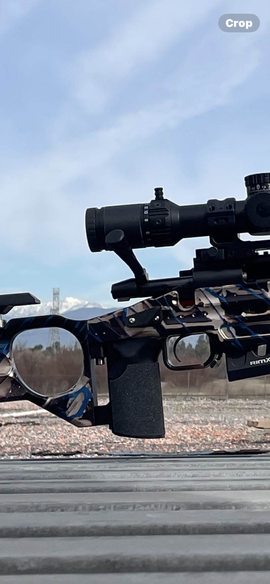

One of my RimX actions sits in an ACC Premier. With a vertical Ergo grip, and aftermarket thumb rest, it is very hard to beat. I own 3 chassis’s from PDC Custom - two for Kidd 10/22s, and one for a Cz 457. I have a Remington 700 on order. The PDC chassis just works for me. And Craig is a super nice and humble guy.
