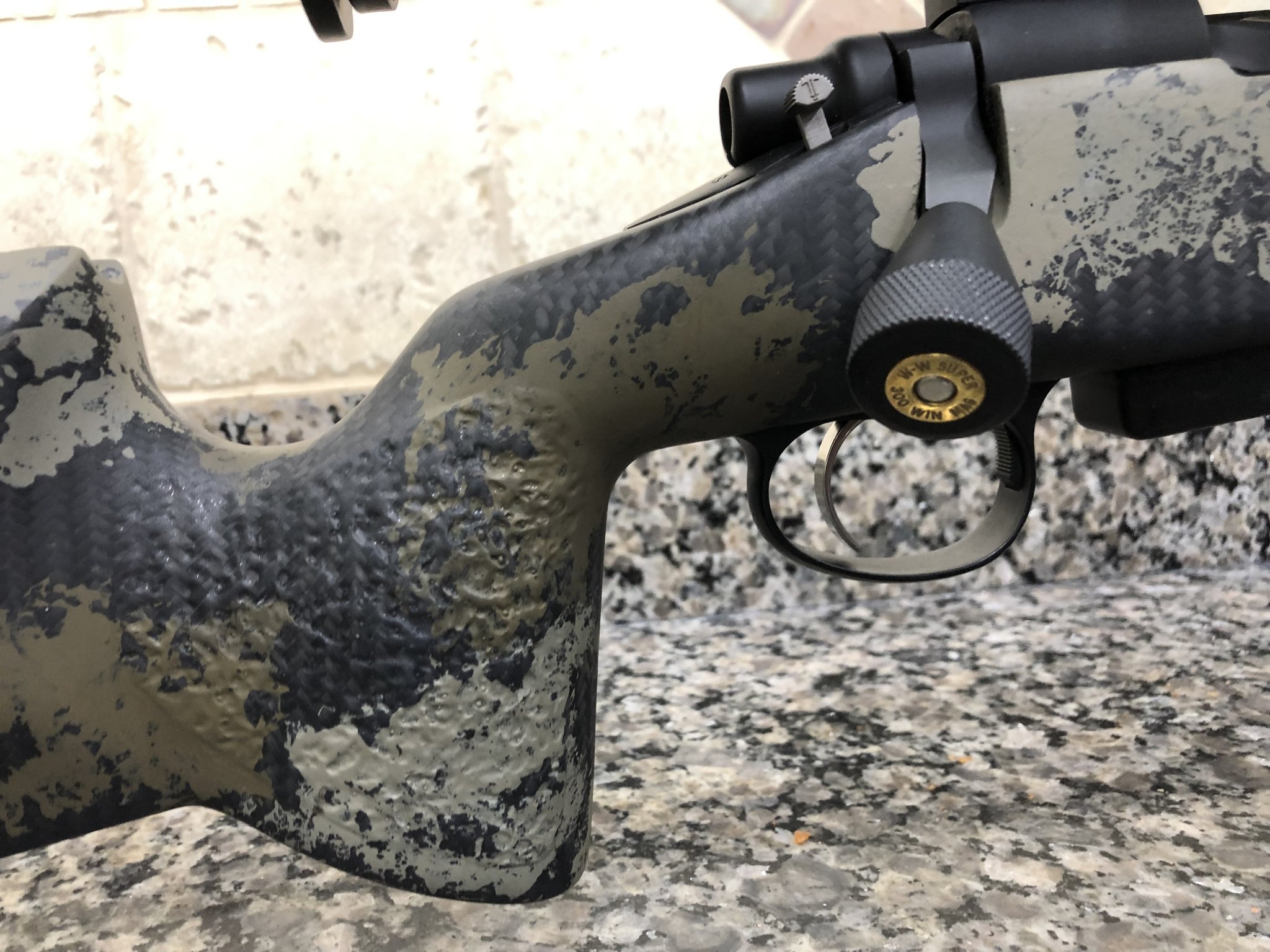

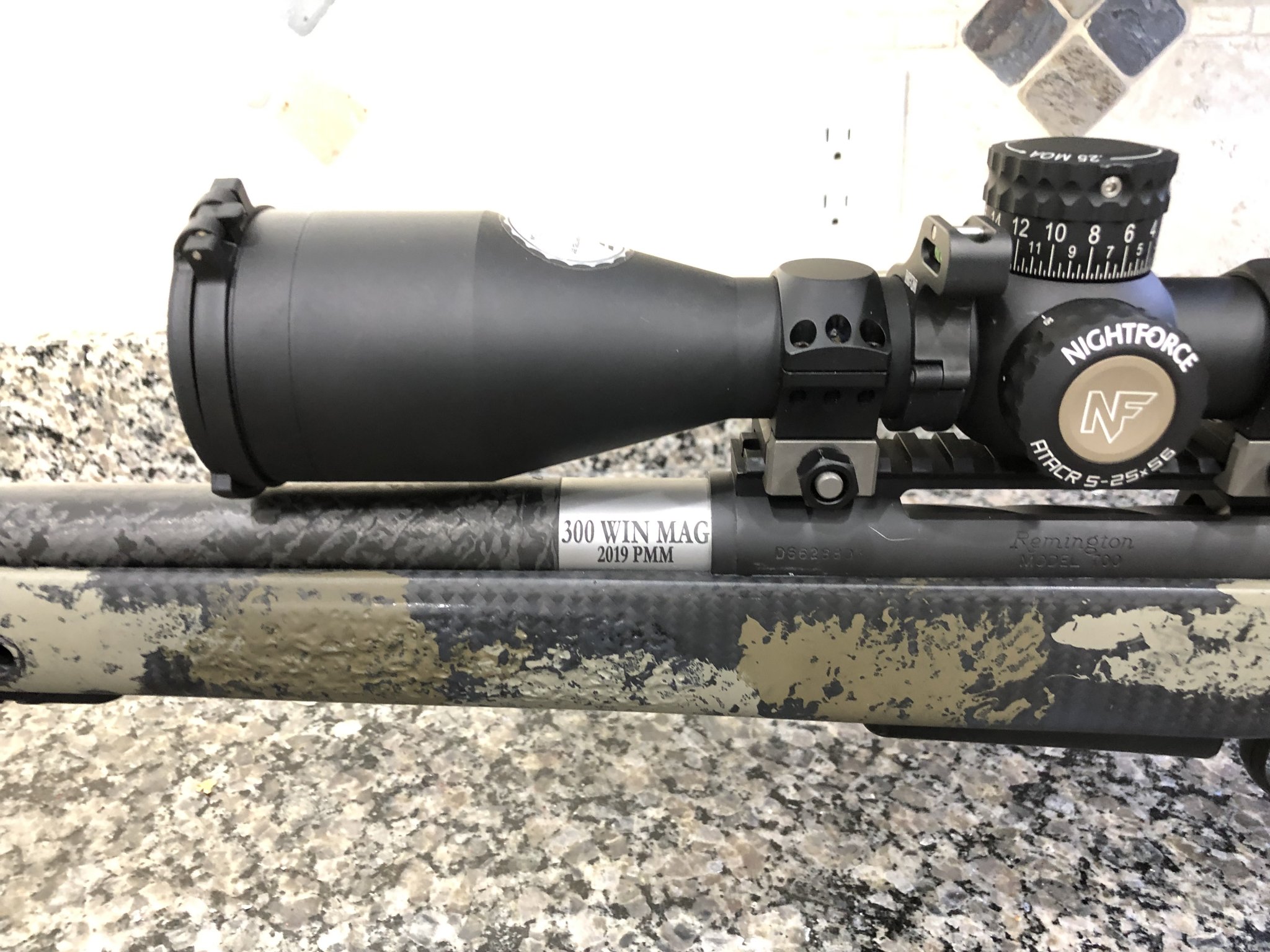

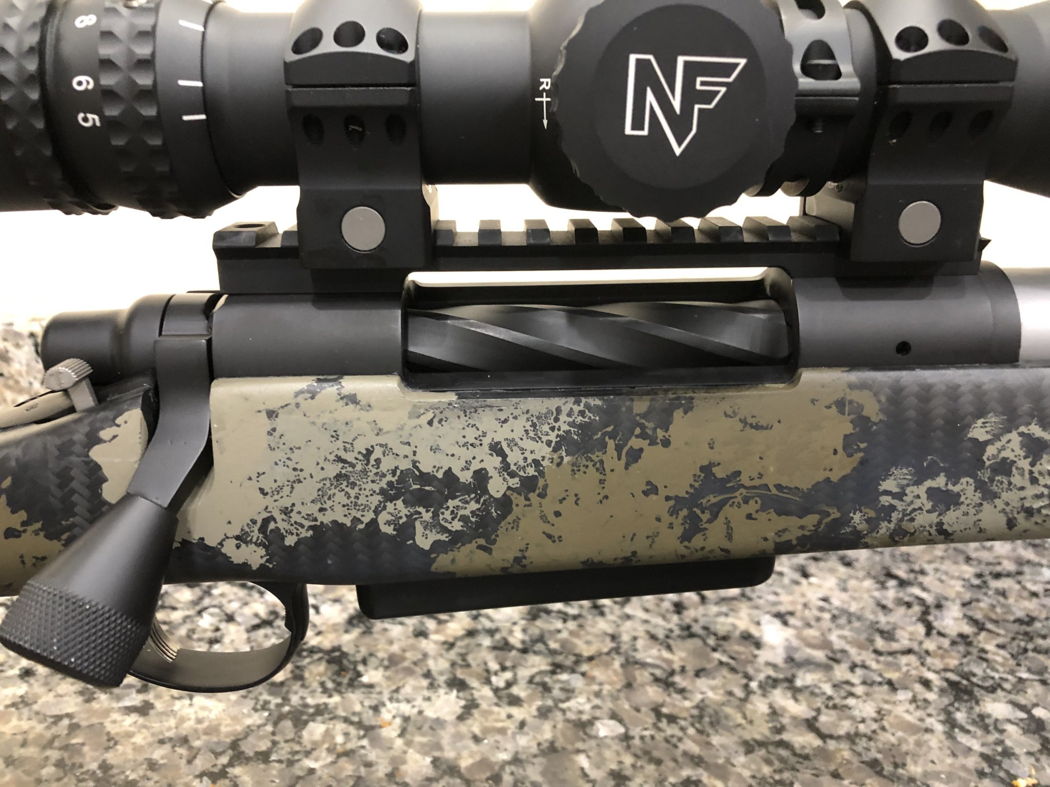

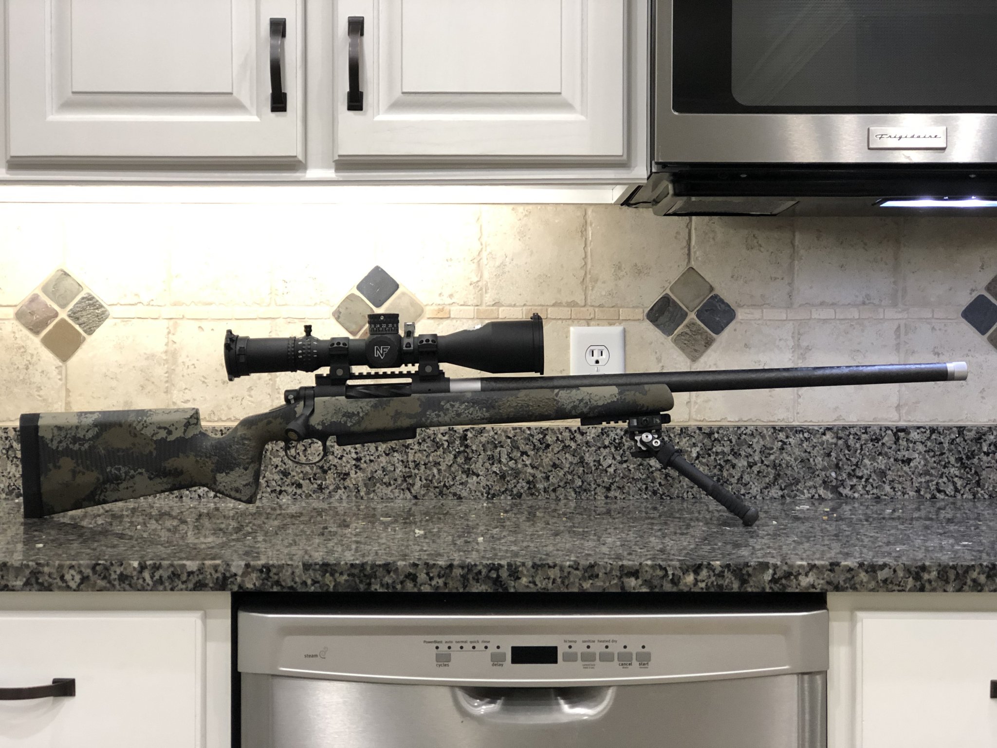

Idk how much either rifle is going to cost you but you may be able to build one for close to the same price. I already had a rem 700 300 and built off if it but I am super pleased with the price and how it turned out. My son actually built one almost identical to mine after I finished. I had the action trued, a 26” proof barrel chambered with a Rhian Manthis reamer(for the 215 Berger), Hs Precision bottom metal and bedded in a Manners EH1 stock. It shoots the 215 Bergers right at 3100 FPS and shoot .4 MOA. I basically have 1200 in smith work and cost of components. I wanted it to be light so I could carry it but heavy enough to shoot a long way.

I want that, just lefty and an adjustable cheek piece.
Beautiful rifle.

God that’s screaming quick!! What a beautiful rifle you have there sir! I’ve weighed out a few options and building off a 700 will run me more then the surgeon rifle but about par with the defiance rifle. There’s more invested in the surgeon yet it is almost too cheap to be true! The owner of both rifles are extremely great, willing to answer and send anything I need!

My sons rifle is almost identical. He used a Manners T4 elite in scorched earth and put a vortex razor on it. That reamer is what allows them to shoot so fast. I load mine as long as my DBM will allow and cram them full of VV N570. It’s a little hot to shoot in the summer but its fine in the winter. I don’t think you could go wrong with either option you are looking at but I’d for sure suggest the 215 Berger. It’s awesome in a 300wm.
Thanks for the compliments guys!
