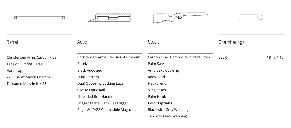

Worth looking into... It comes with a Bentz Match Chambered 416r stainless barrel tensioned inside of a carbon fiber tube, it's already threaded 1/2x28, comes stock with a 2.5 lb. adjustable TriggerTech Rem 700 trigger, a full-length picatinny rail, a carbon fiber stock, and sounds amazing with my Dead Air Mask HD. It also has produced some pretty amazing groups and accuracy, even out to 200 yards.
Specs right off their website...
