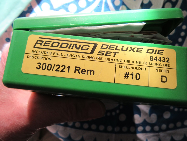

I was looking at the Redding Set. https://www.midwayusa.com/product/1018047141?pid=680890
It a few bucks Cheaper if you get this 3-die set .at the same dealer you looking at in your Link
It's ALL in the market labeling but , all is the same ... / 30-221 remington / 300 whisper / 300 Blackout .
300 Whisper . . $ 105 .75 . . 3-die set .
https://www.midwayusa.com/product/1018047141?pid=244465
