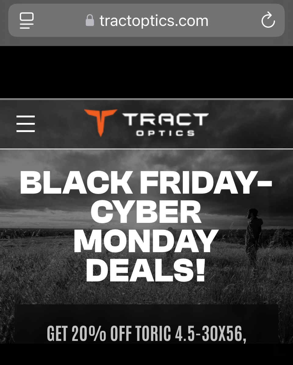

Tract had 20% off one of their scopes for Black Friday @Bgriff008.
