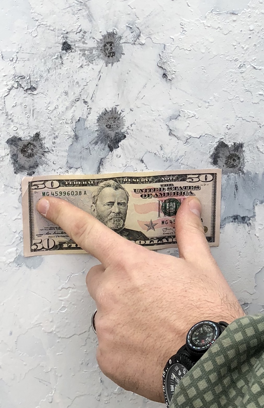

My Tikka T3X a1 shoots lights out. Stretched it out to a 1000 yards yesterday with 5 shot group...top one is two hits. It was an approximate 6” group with wind. Tossed a $10 spring from “Yo Dave “ for a crisp 1.5lb trigger.
