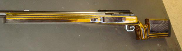

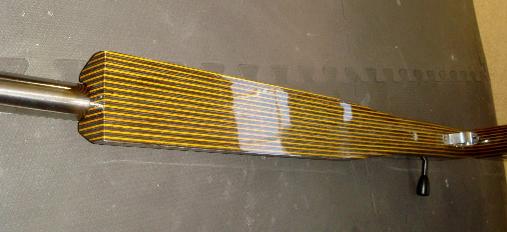

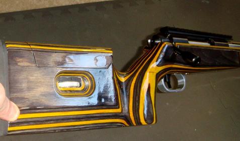

I agree with the automotive clearcoat, really hard stuff, and touch up is no problem.
Here's my 6mm Dasher in a PR&T Lowboy stock, really glides on the bags.
